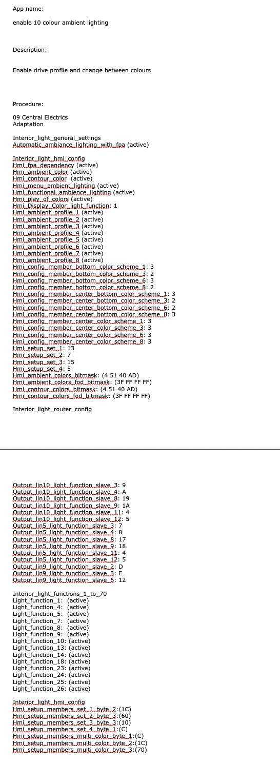

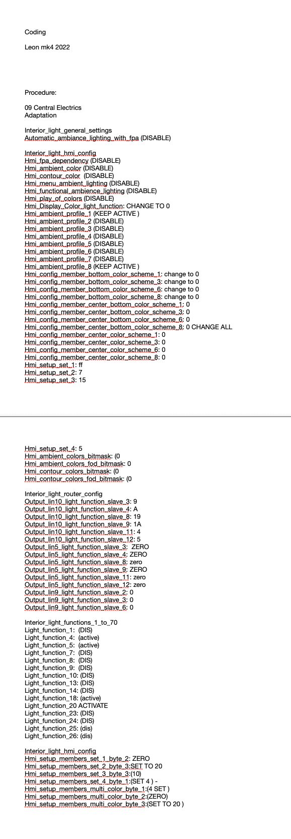

Hello I recently attempted to code the 10 ambient colour menu on my seat Leon 2021 hybrid , the menu worked and came up with all the colours but found out the light strip in the door is a red and white only so I reverted it back to old code and menu , since then the door lights have not worked at all nor have the footwell lights , if anyone could help figure out what I did wrong or why they aren't working anymore ?
photo on the left is the coding to revert back to one on the right is the coding to enable the ambient lighting 10 colours
