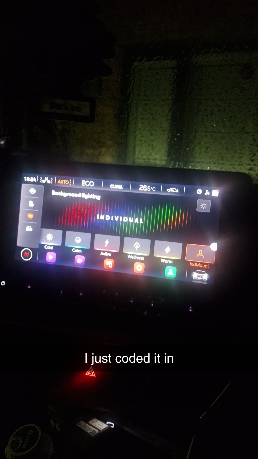

Hi all,
This is my first topic in the group, I had succeeded in changing the red color in doors for my FR 2022 ehybrid to select from 12 colors. (i don't have smart ambient light)
Of course by using OBD 11 long coding, as it's not available in 1 click application

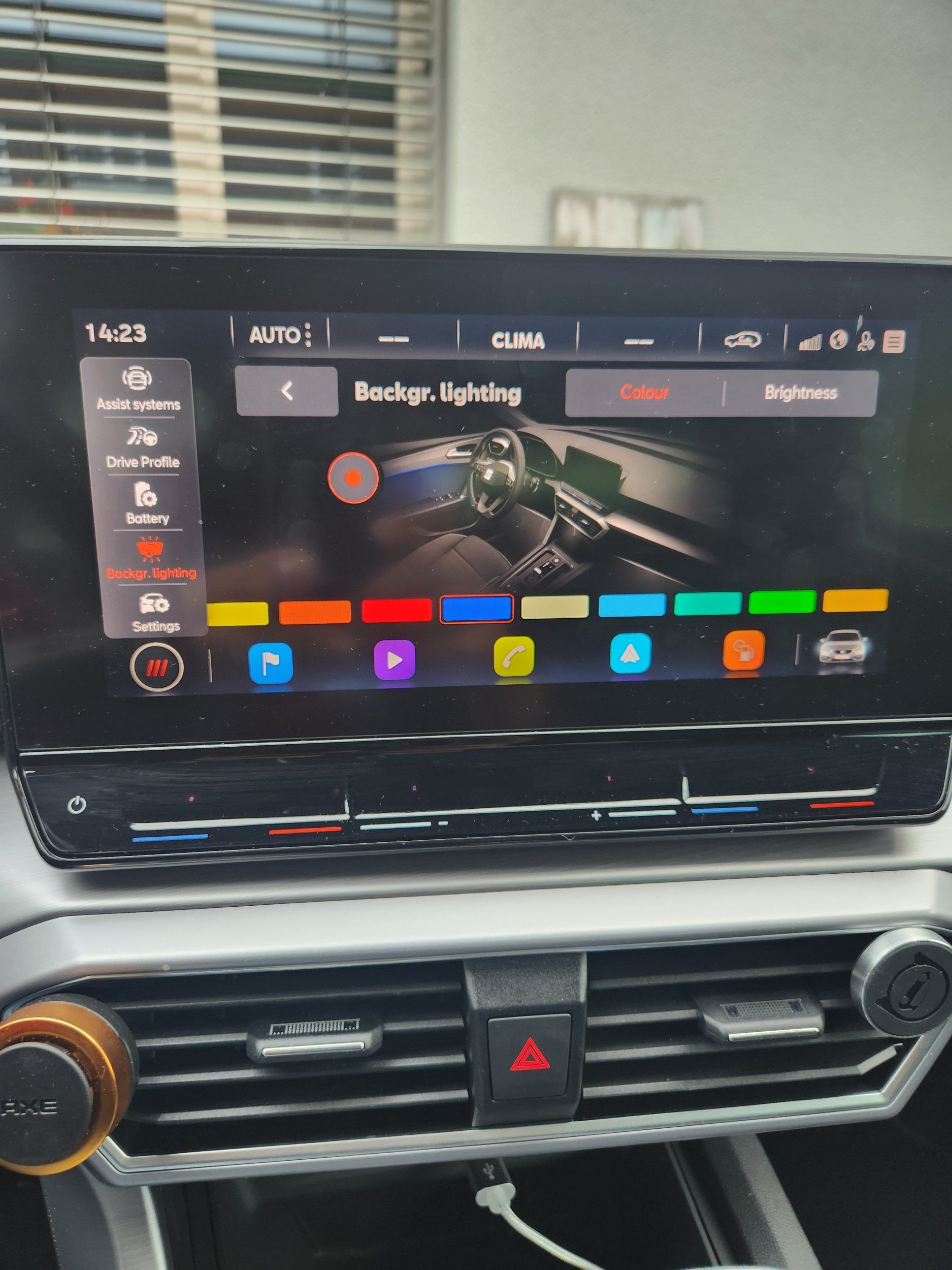

Could you guide me through this a bit more im not sure if im not reading it right or not. I have a 211 mk4 seat leon. That has white led and red side door panels and the rest are white like foot rest and centre console where your phone rests. No wrap around. When I plug obd11 in and go to central eletrics (09) adaptations. I cant find just the normal ambient light it shows 4 separate ones or interior light fuctions and stuff
I am fairly certain that your car does not support rgb. Cars fitted with red and white lighting usually only support those two colors ... 😕
My car is also a 2020+ so it has the new mmi.
Maybe send me a picture of your ambient lighting menu (if you have that enabled).
If you have the menu enabled you could try these steps first maybe:
09:
Adaption:
-ambient lighting:
>Farbwahl ueber HMI > installed
>Ambientemenue mit allen Zonen > active
>Ambient_Farbliste_HMI > active
>Ambiente_Farbwahl_FPA_waehlbare_Kopplung_Status_hmi_default > active
-interior lighting, parameter:
Here you have 3 values, each with 3, 5 and 3 digits these refer to colors you can enable through the mmi. A 1 is enabled and a 0 is disabled (these are bits).
>p_farbauswahl_HMI by default should have 110 for you (red/white, white/red, and another color i cannot remember).
Since your car seems to be able to do white and red.
Try enabling the third digit (color) and restart your mmi (hold the power button).
Then check the ambient lighting menu in your car and select the newly added color. If it doesn't work properly then you know your car cannot do more colors than white and red 😅
The way you make it sound you should at least be able to enable your cars doors to not only be red, but also white :)
Thanks for your reply. I am just back from the car so I will look into it tomrrow. I followed a different guide that managed to get the menu up and I can pick either red and white. But only them 2 so ill have a look more tomorrow
