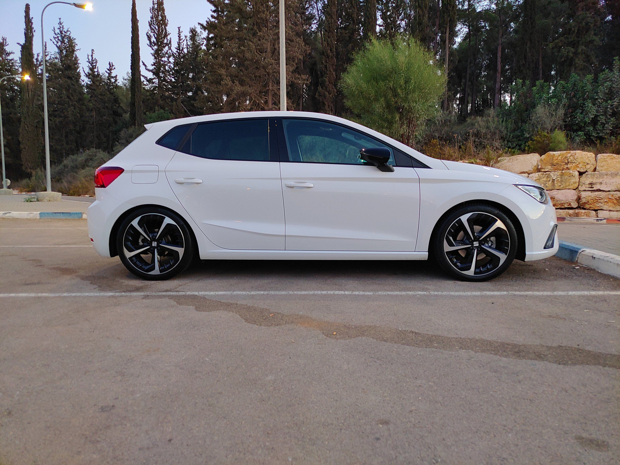

Btw this is what 3.5 cm lowering looks like. It honestly doesn't look taht low but is a bit more aesthetically pleasing
It looks kinda nice. But those are 18" rims. I'm using 17". However, even in that picture, the front is a bit too low for my liking! Anyway, it's cool!

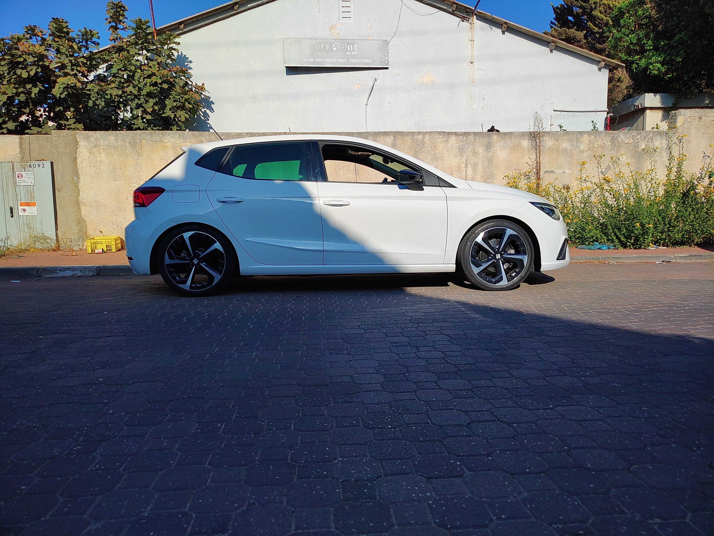

Thanks mate. I actually think my back is like 2-3mm lower than the front ?. Anyways. Here's a different angle where you can see the front better. Keep in mind if you lower on 17's it might look wierd if your overall wheel and tire diameter is smaller than mine. My wheels already look a bit too small for the rest of of the car.

Ohh, it looks better that way. The other picture, you had the wheels turned to the right and it felt like the tyre was closer to the wheel cover (don't know the correct name in english). But if you keep the wheel straight, it looks pretty nice. I think I would take mine looking like that in terms of distance of te car to ground and of the wheels to the wheel covers!

Yeah it's not bad. Only issue is the back wheel looks a little too inside the wheel well.

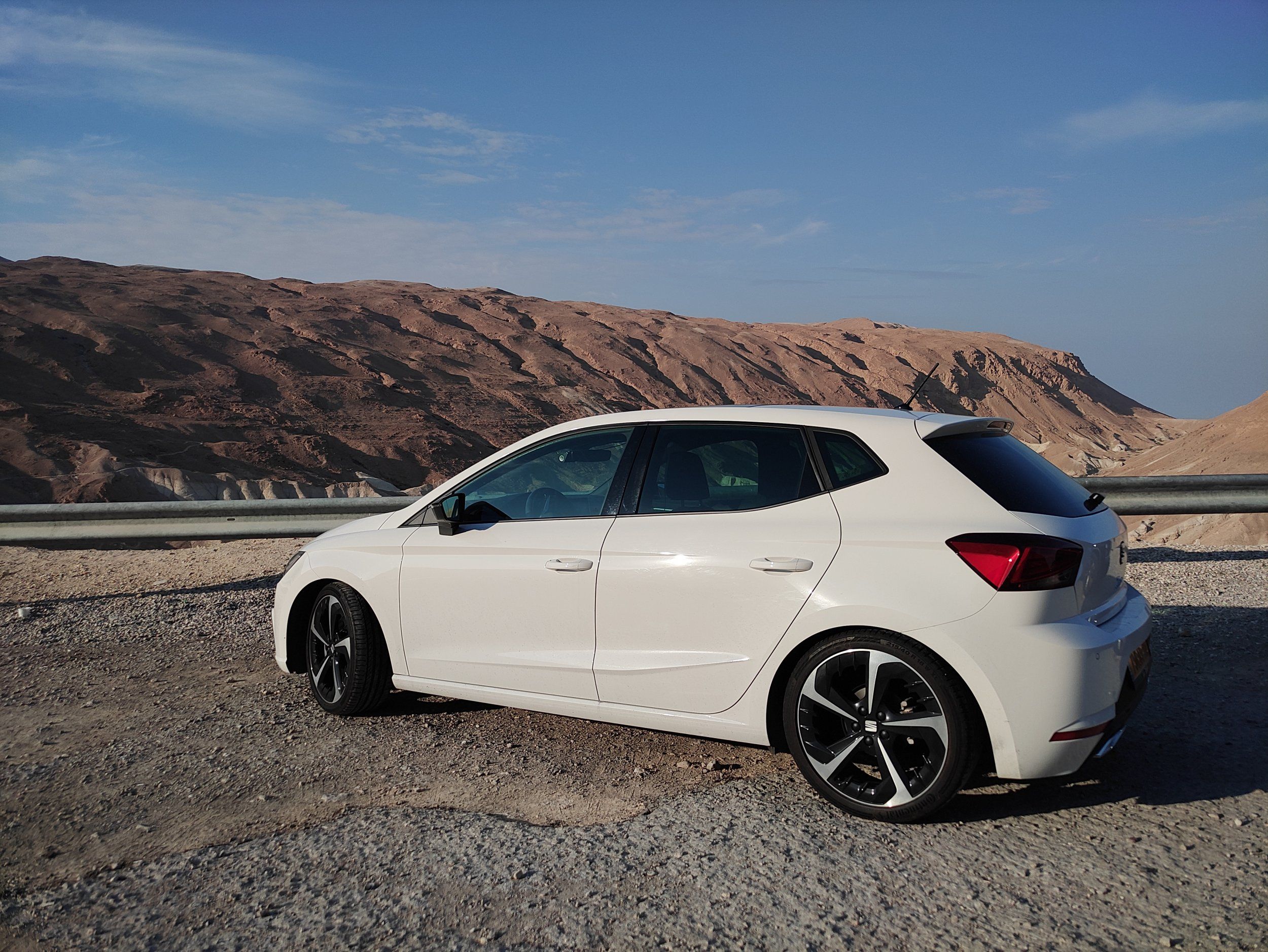

Hello everyone, I'm new here. I just wanted to show you my setup to give you an idea. This is my Ibiza, i have installed Ultra Racing lowering springs on it. 30mm for the front and 25-30mm for the rear. That's how it looks 2 months after it has been installed.
Edit: I wish i can lower more but, in Istanbul there are lots of uphills and downhills. I don't want to shred my front bumper :D

That looks pretty slick on the 17'' rims :). Is the ride comfort still decent?

Yes, it was surprising for me how comfortable and stable it is at the same time, but i think it is because of the 15inch rims :D But i don't think it will be bad with 17's also :D The car is new, im doing things step by step :) 17's on the way of course (y)
