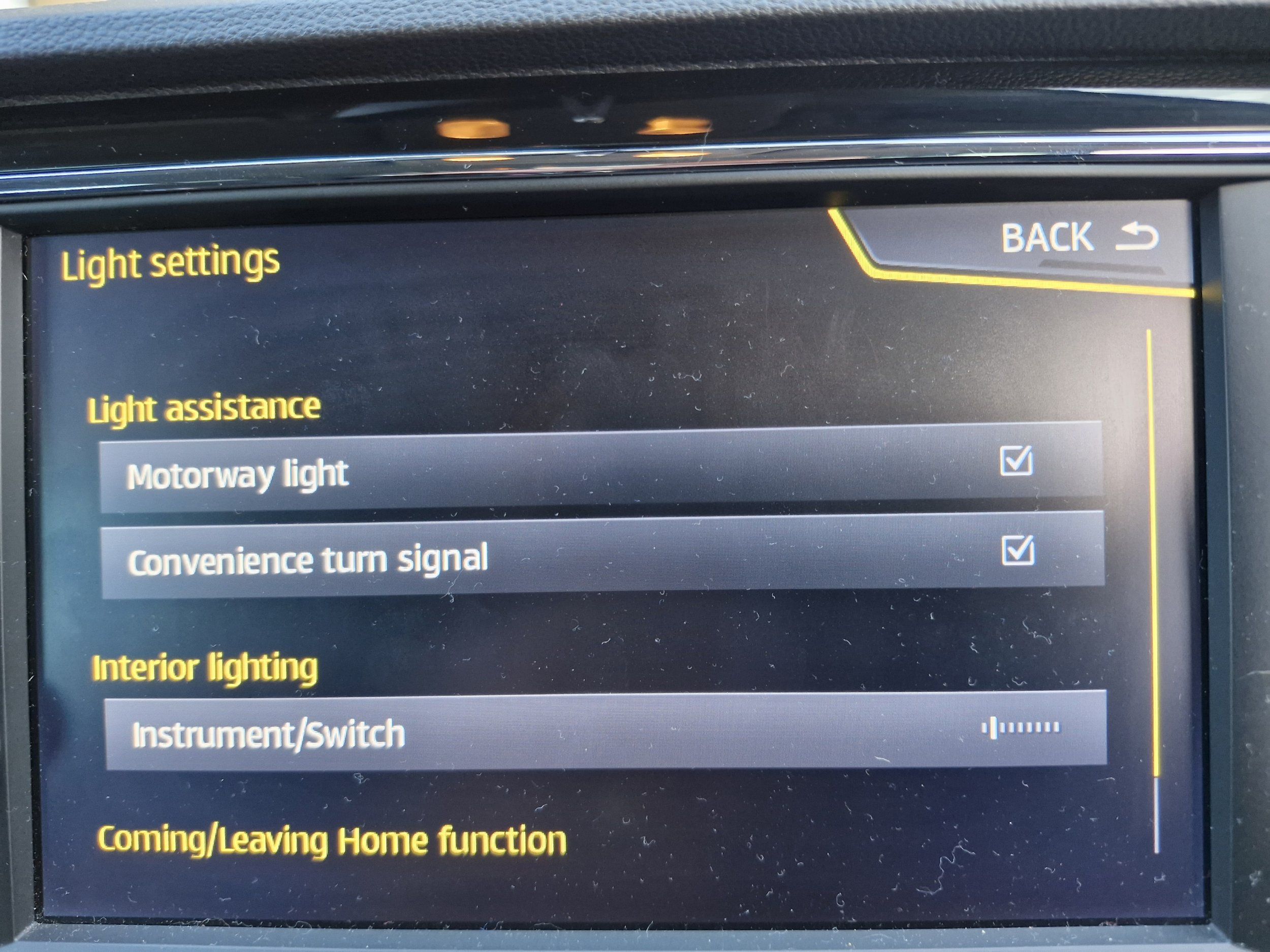

Hopefully it's something obvious I'm missing within the settings... Jumped in my car this morning and the comfort indicators/one press - whatever they're called used to flash 3 times but now it's just flashing the once. My other half used the car yesterday so going to blame her but she doesn't have any clue if she has done anything.
Could someone please guide me to the setting? Like I say, probably being blind and hopefully so. It's odd that it has just changed overnight.
Many thanks!
It's in Vehicle Settings, Light Settings
Make sure the Convenience Turn Signal is checked.

Obvious question maybe, but have you used the same key? Settings are individual to the actual key used, in other words, the settings set up on one key may be totally different to those on the other key
