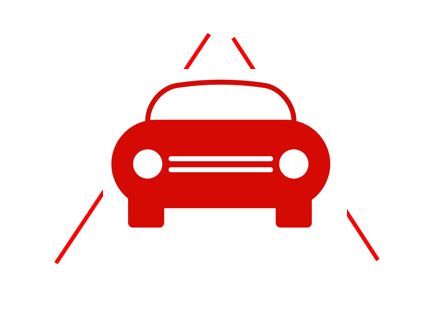

Driving my 2018 CUPRA 300 4AWD yesterday, about 50mph and was exiting a bend. I had a symbol appear on the dash (similar to the image I've sketched below) for maybe a couple of seconds, accompanied by a tone. I've had the car for 3 months and have done about a 1000 miles in that time but not seen this before.
I've had a trawl around the net using appropriate search words but haven't found an exact match but the suggestions out there point to a radar alert.
Any thoughts please?
Could it be you were too close to the car infront? - see graphic in this post symbol 16 almost matches yours, and it comes with a
pretty loud tone.
Yes it is the front assist symbol.
Mine came up yesterday for the first time, but oddly no one was in front of me, but a man in a high Viz jacket was sitting on the kerb and I was about 1.5 metres from the kerb, having already seen him and moved out to give him space.
pretty loud tone.
I've been closer, but not on this occasion.
Thanks for the link to the dashboard warning lights picture, just what I was searching for.
Reactions: Rob66
I've had that warning come on when i'm the only vehicle on the road. Must be detecting ghosts, or insects or rain drops.
