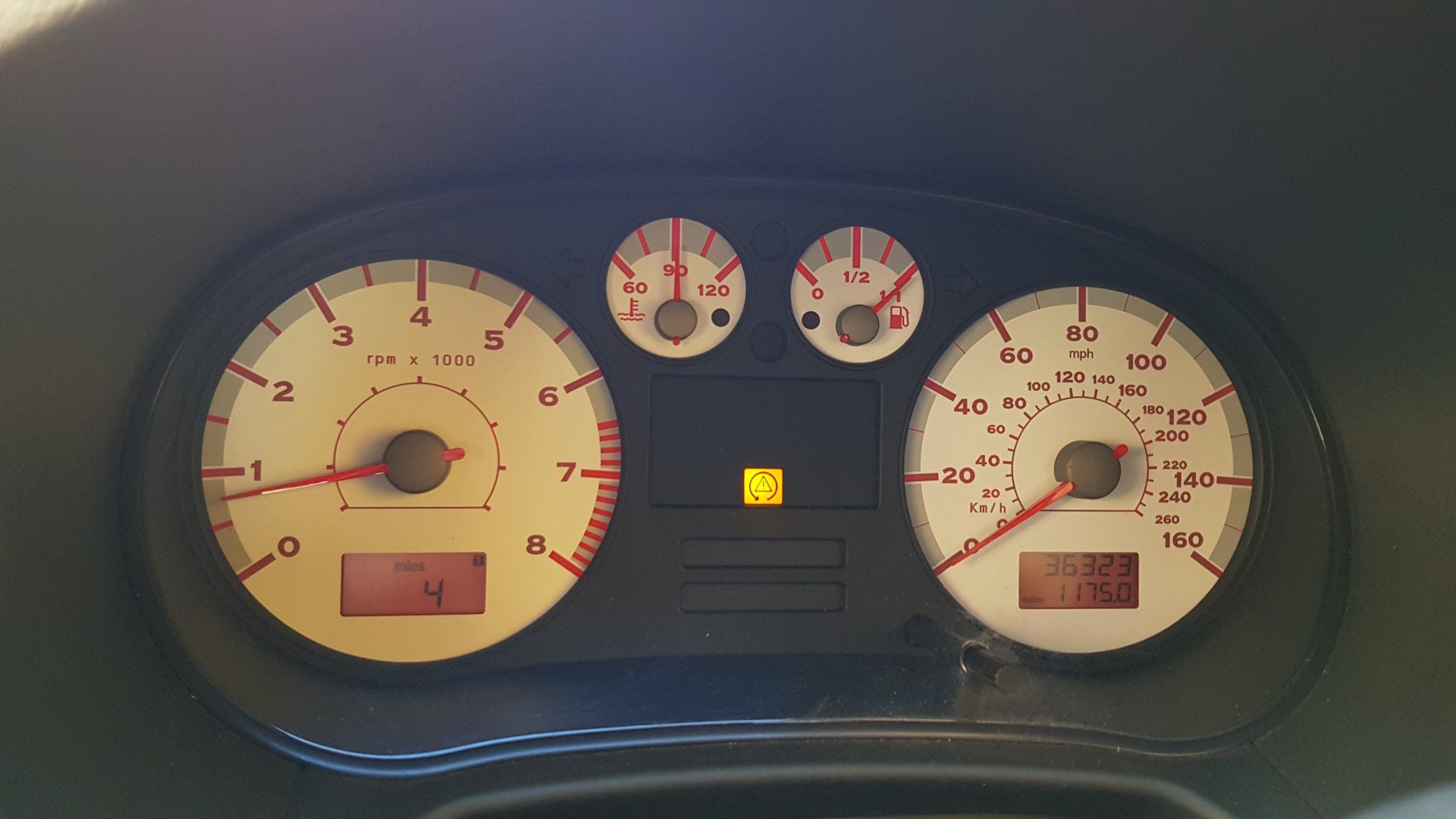

Can anyone shed some light on what this dash error could be?
Couldn't find anything in the manual too specific.

Normally comes on when you switch the traction control off. If it's on all the time there's likely a fault.
Check for an error code, most scanners should read it. But VCDS is likely to give more information & tell you what it is if something has failed.
