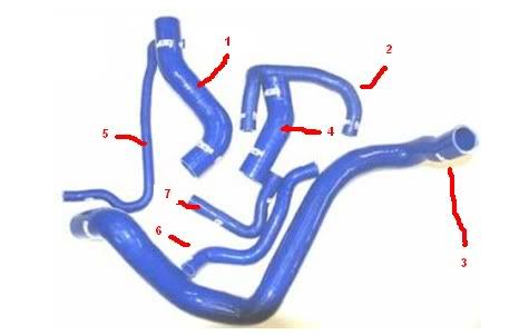

hi all,
still getting to the bottom of my coolant leak. i now know its coming from the thermostat housing and i have a swollen pipe..
seeing as i will be draining the coolant system i though i would upgrade the hoses.
does anyone know the sizes/ diameters of these hoses so i can use siliconhoses.com or know a cheap kit other than the forge fmkc005
thanks again :)
diameters/ sizes

nothing ob ebay to replace these? do silicone hoses not do a kit as you can see the forge ones are not just a simple straight peice that you can replace.
no they don't do a kit, i was looking at the straight lengths to use hence why i need the diameters of the original ones :)
here you go
diameters/ sizes
1- 30mm
2- 15mm
3- 30mm
4- 30mm
5- 7mm
6- 15mm
7- i dont have in my kit but im guessing its the same as 6 so 15mm
keep meaning to fit this kit but forsome reason its a job i keep putting off lol
hope that helps
