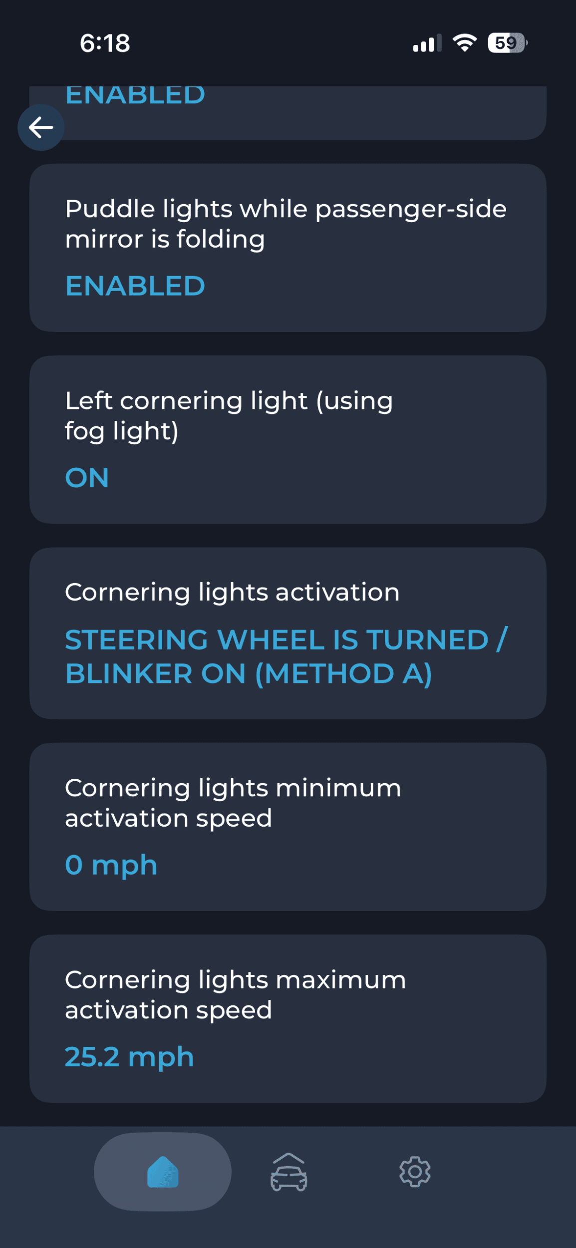

I have a seat Leon mk3 SE edition 65 plate , I purchased the carista evo and want to add the hot light Cornering but it’s only giving me the option for front left fog light but not the right fog light
