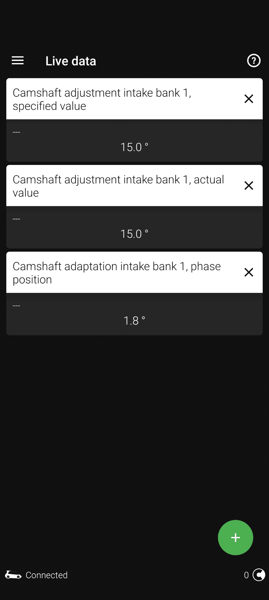

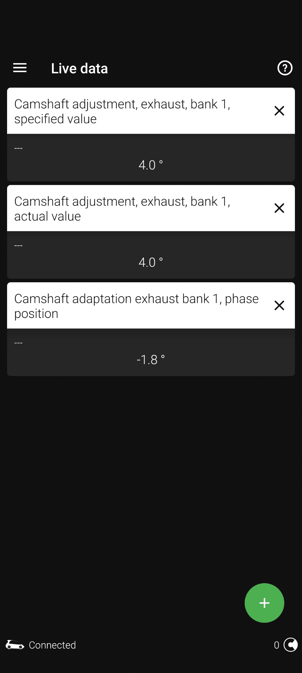

Starting the engine and letting it settle to idle, for exhaust I got

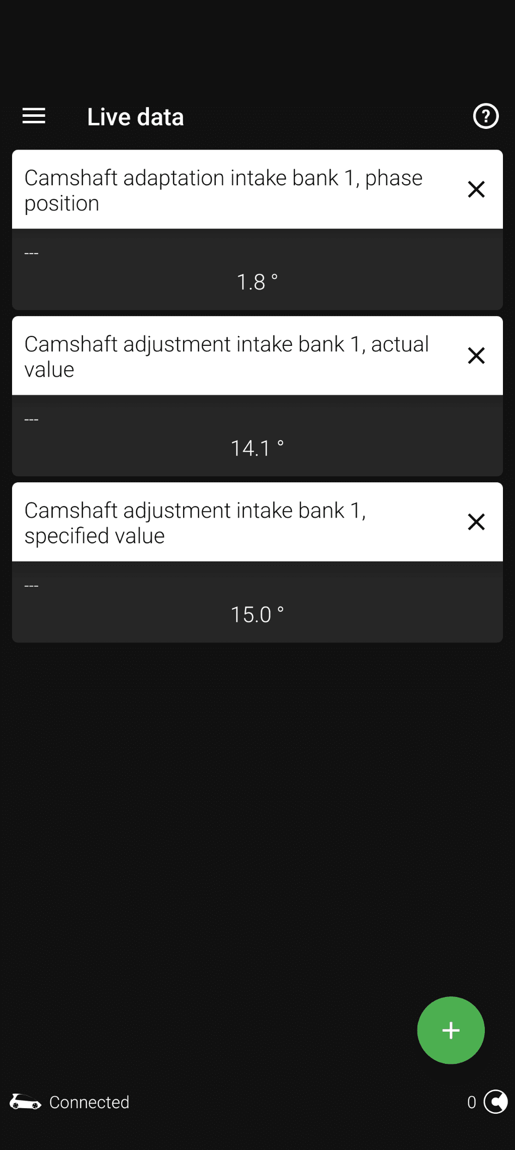

For intake I got the below and the fluctuating for actual was hitting as low as 13 and as high as 17
I then left the car running for a while to simulate where the noise would disappear and found the exhaust phase had changed and intake actual was basically now sitting on 15
Could that initial fluctuating on the intake actual suggest there is an issue with the chain on a cold start?
