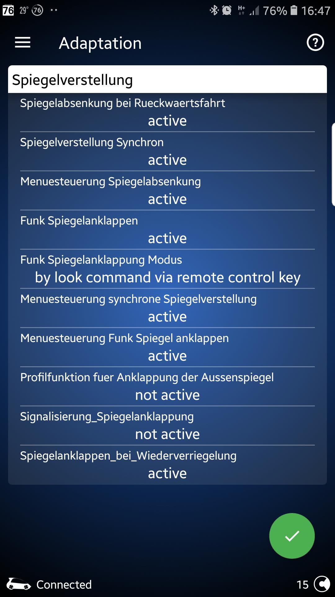

I have a Cupra 2019 5 doors,keyless entry, and OBDEleven Pro.
What I am trying to do is very simple - get mirrors to fold when car is locked, but unfold when ignition is switched on, not when car is unlocked (as by default).
You can see two screenshots of OBDEleven adaptations.
The one with "Funk Spiegelanklappen" not active is the default. The other one was based on some recommendations found on forums, but leads to strange behaviour - mirrors unfold when door is unlocked (so purpose of the adaptation wasn't achieved), and on top of that if ignition stays off mirrors fold again after some time.
All locks/unlocks were done by touching sensors in doors handles, not using the key of fob.
Is there anyone with new Cupra with keyless entry who got it working ?
10x.
