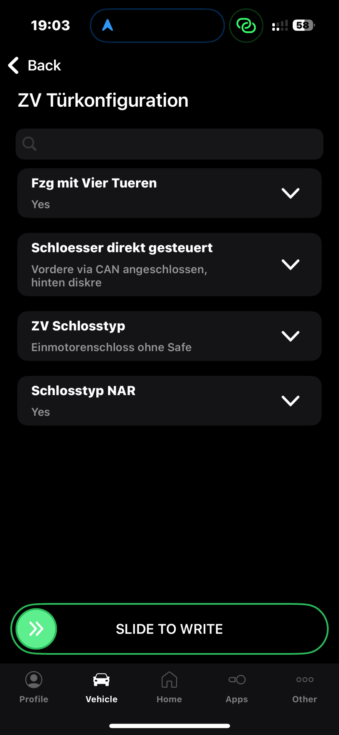

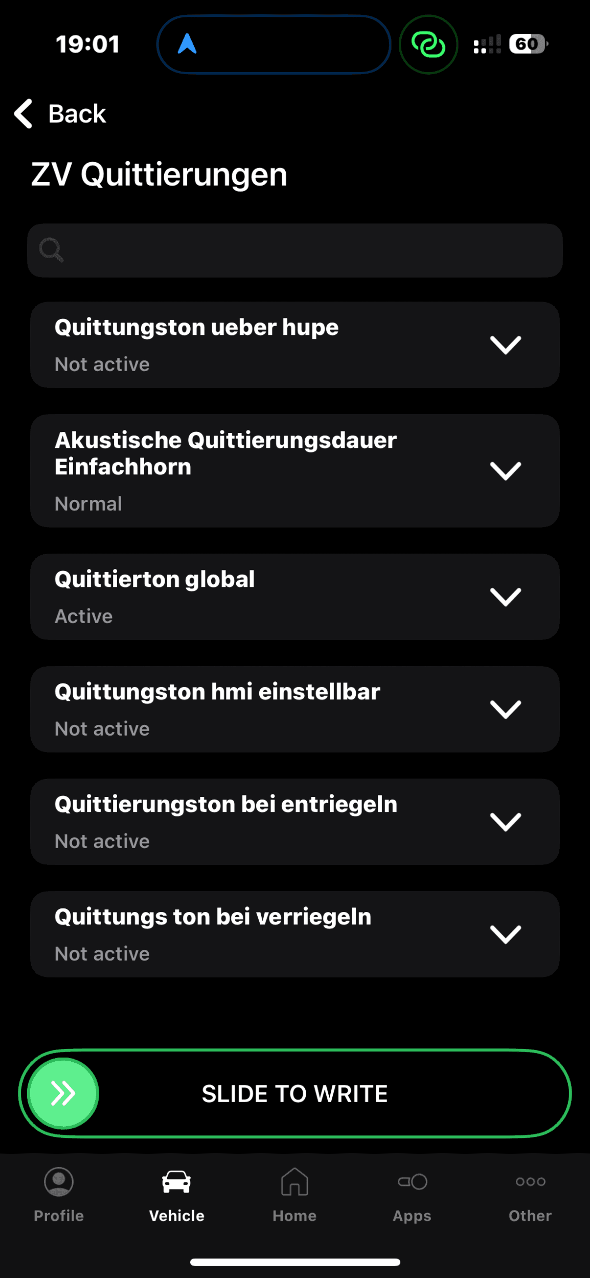

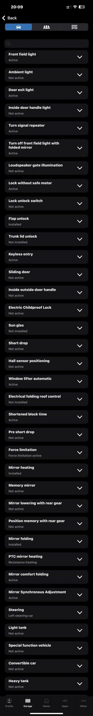

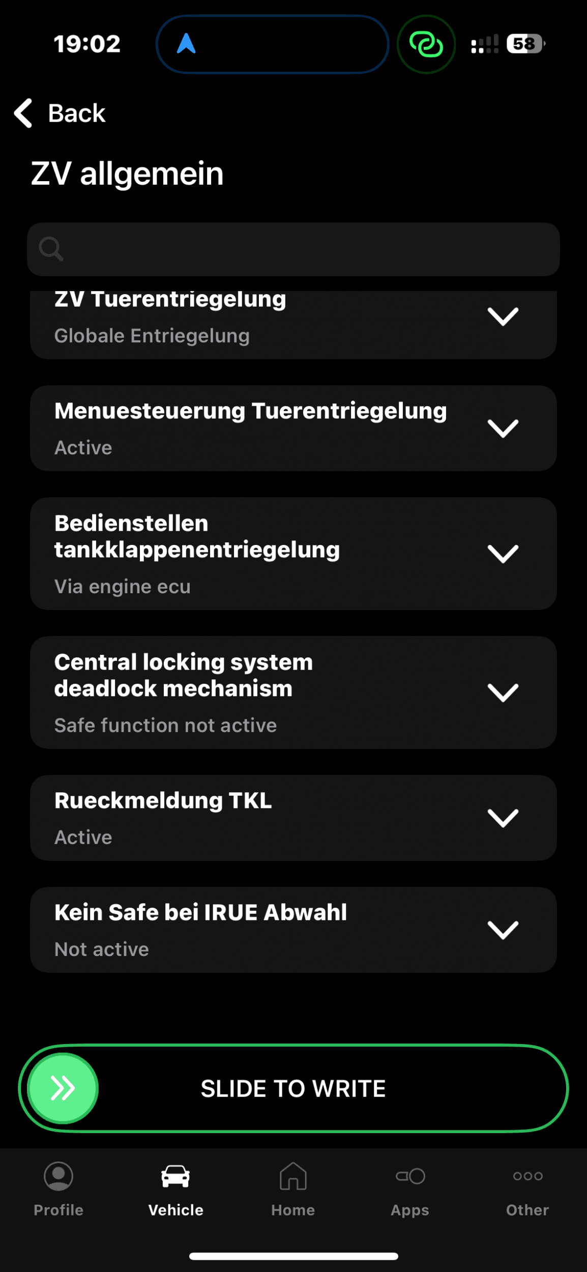

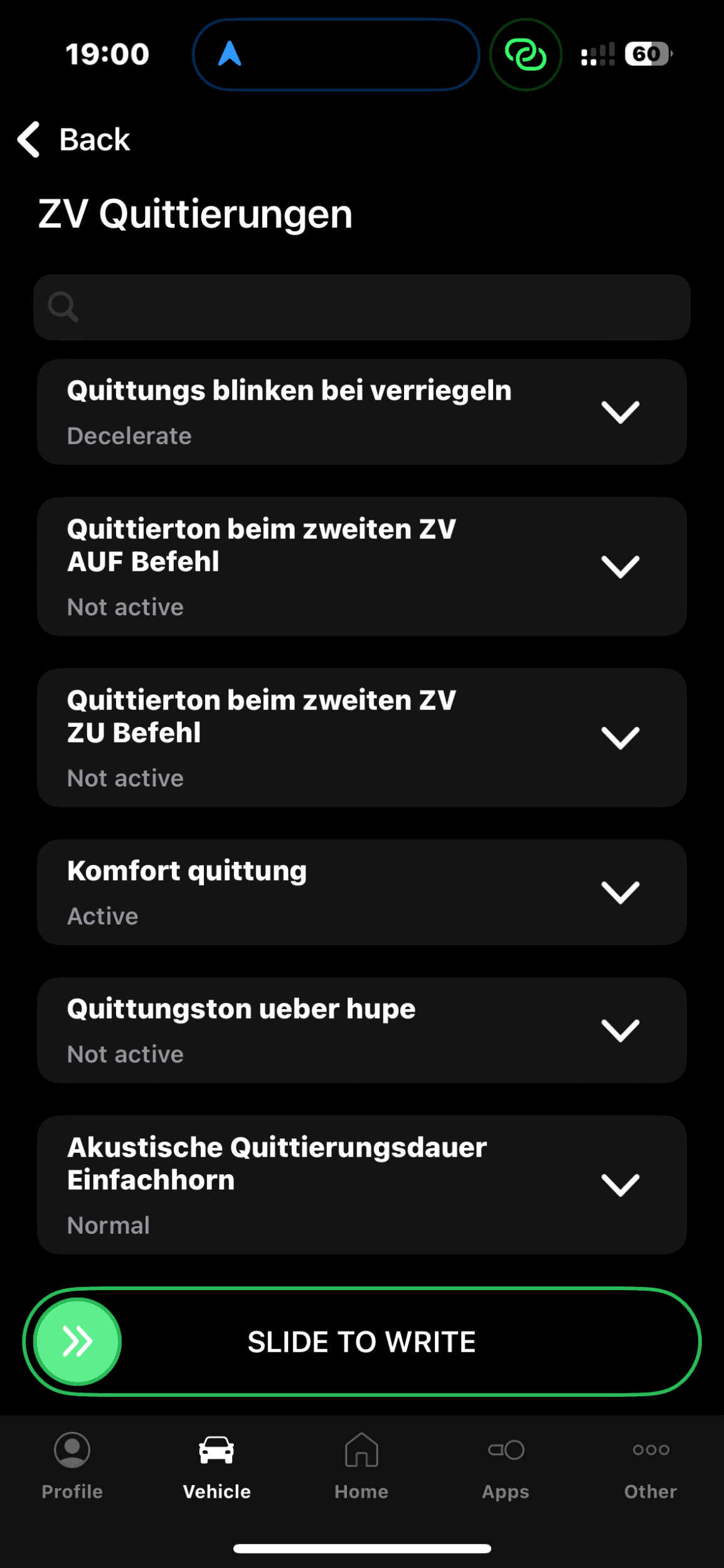

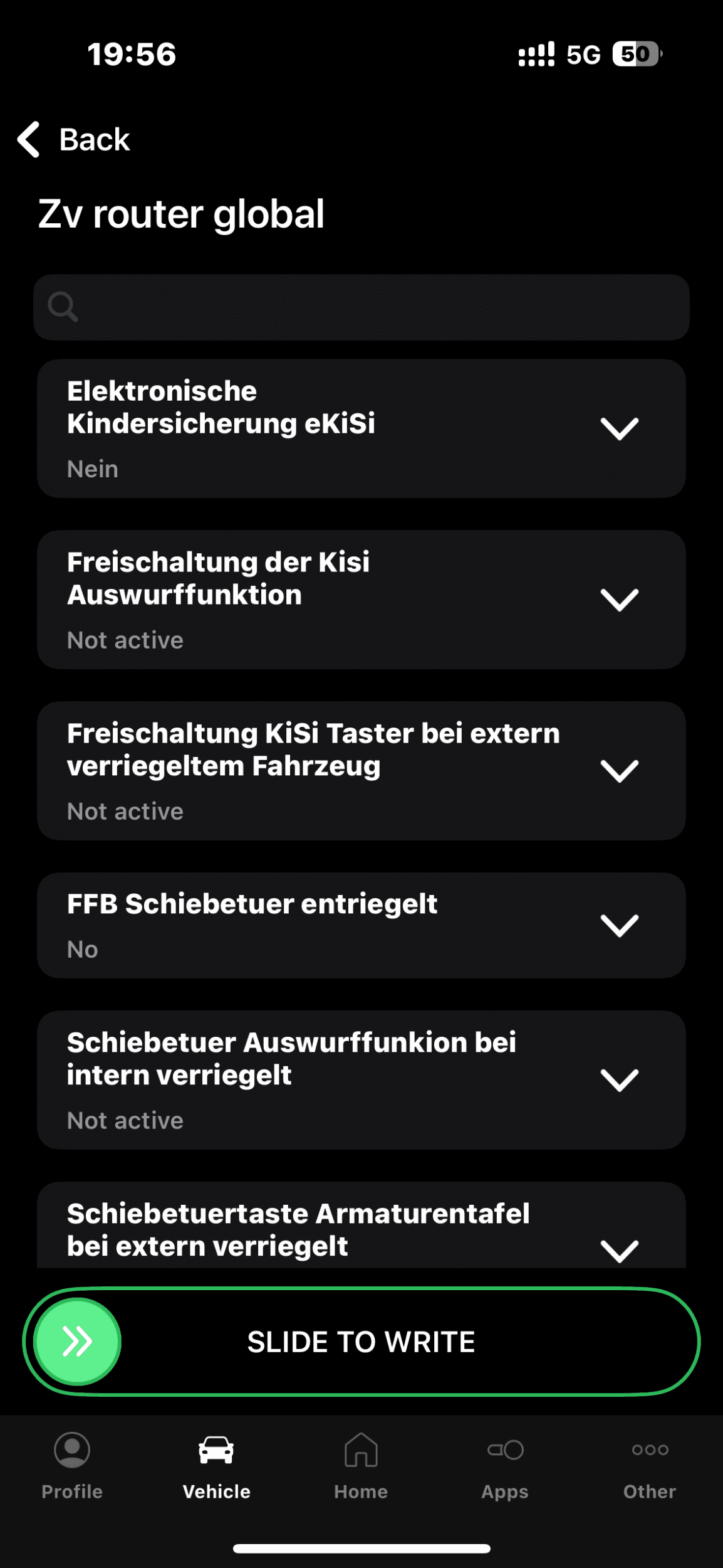

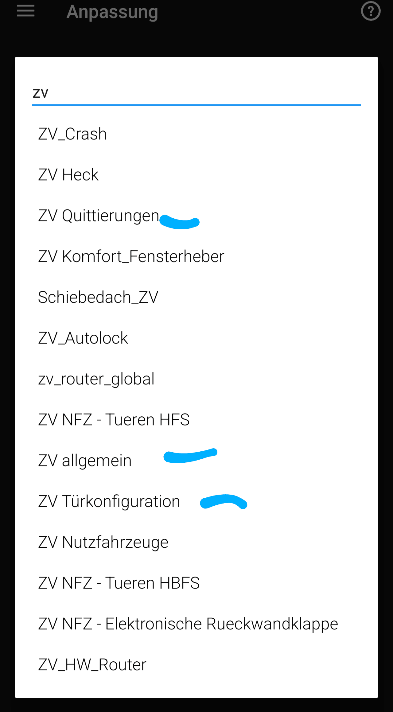

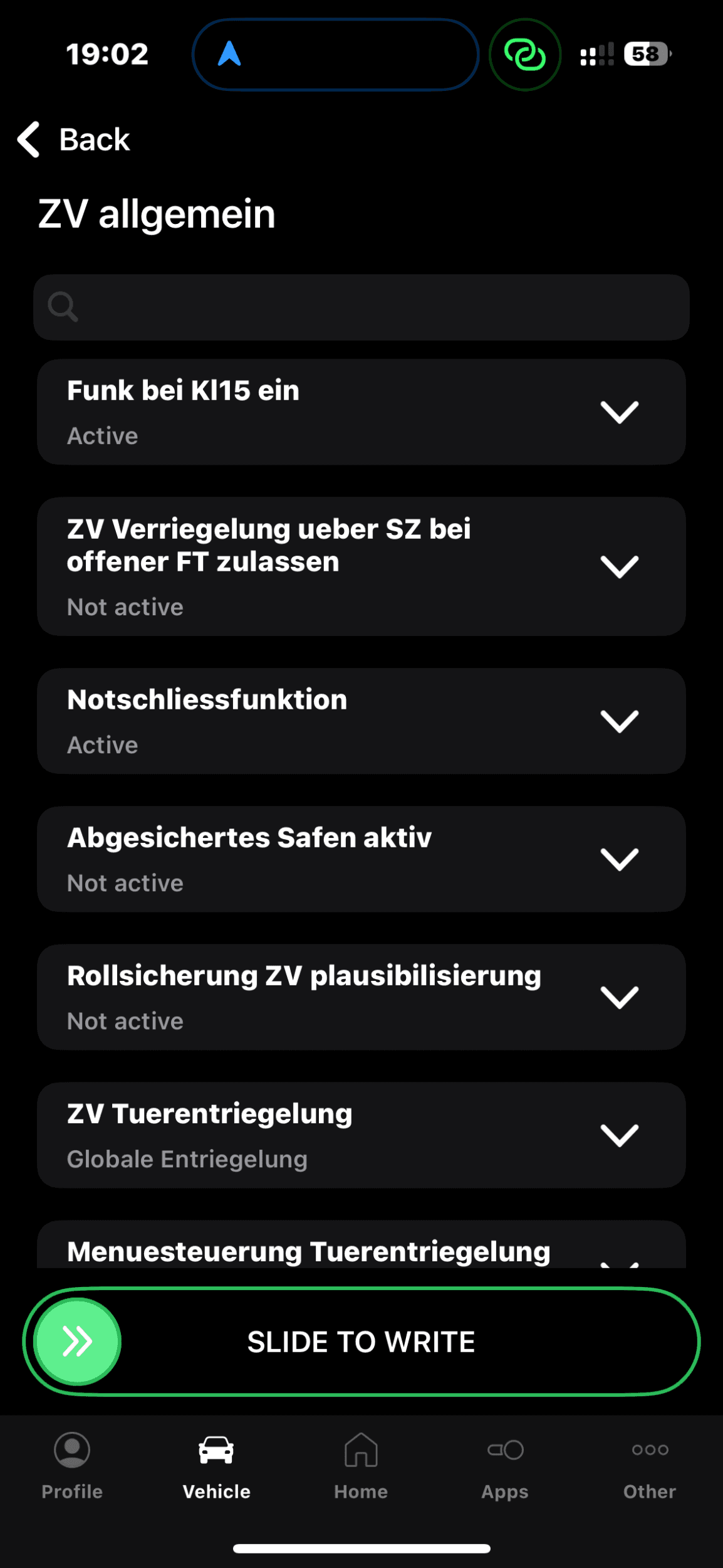

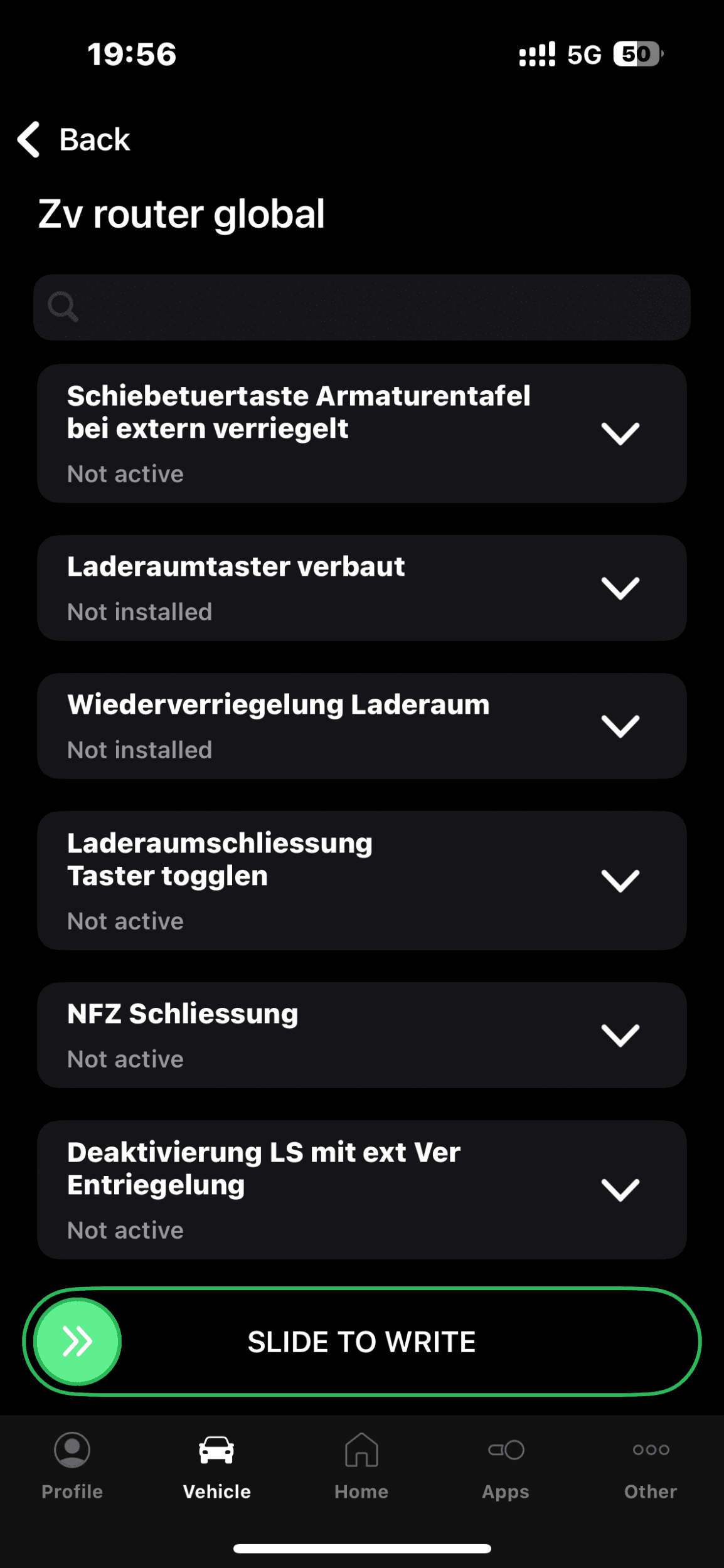

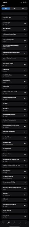

bitte zeigen Sie mir die Unterpunkte dieser Anpassungen
please show the rest of it too. I think this point would really be removed... I'll look tomorrow when I have a car available

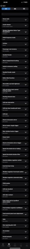

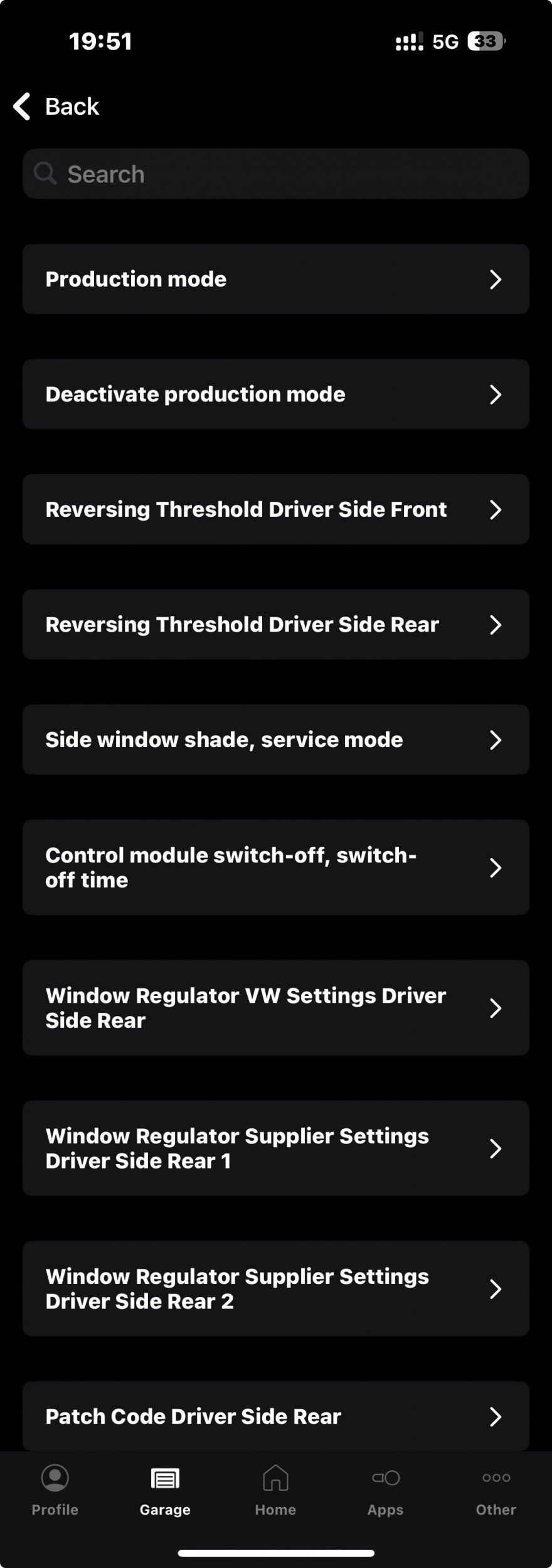

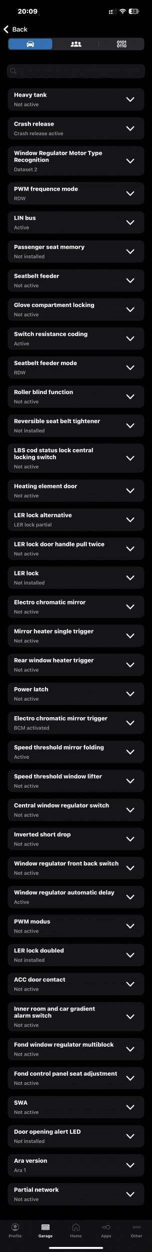

I've been investigating with ChatGPT and perhaps on MQBEVO platforms, Module 42 (Driver’s Door Electronics) and Module 52 (Passenger Door Electronics) may hold the coding options? I'm sharing backup data from my vehicle:
42 Driver Door
System description: TSG FS
Software number: 5Q4959593H
Software version: 0692
Hardware number: 5Q4959593H
Hardware version: 010
Backup name: Driver Door
Long coding: 00351522D000020000001000
52 Passenger Door
System description: TSG BFS
Software number: 5Q4959592H
Software version: 0691
Hardware number: 5Q4959592H
Backup name: Passenger Door
Long coding: 00351122DC00020000001000
I have thoroughly tested STG 42,52 and 09, no setting or coding or adjustment brings success
