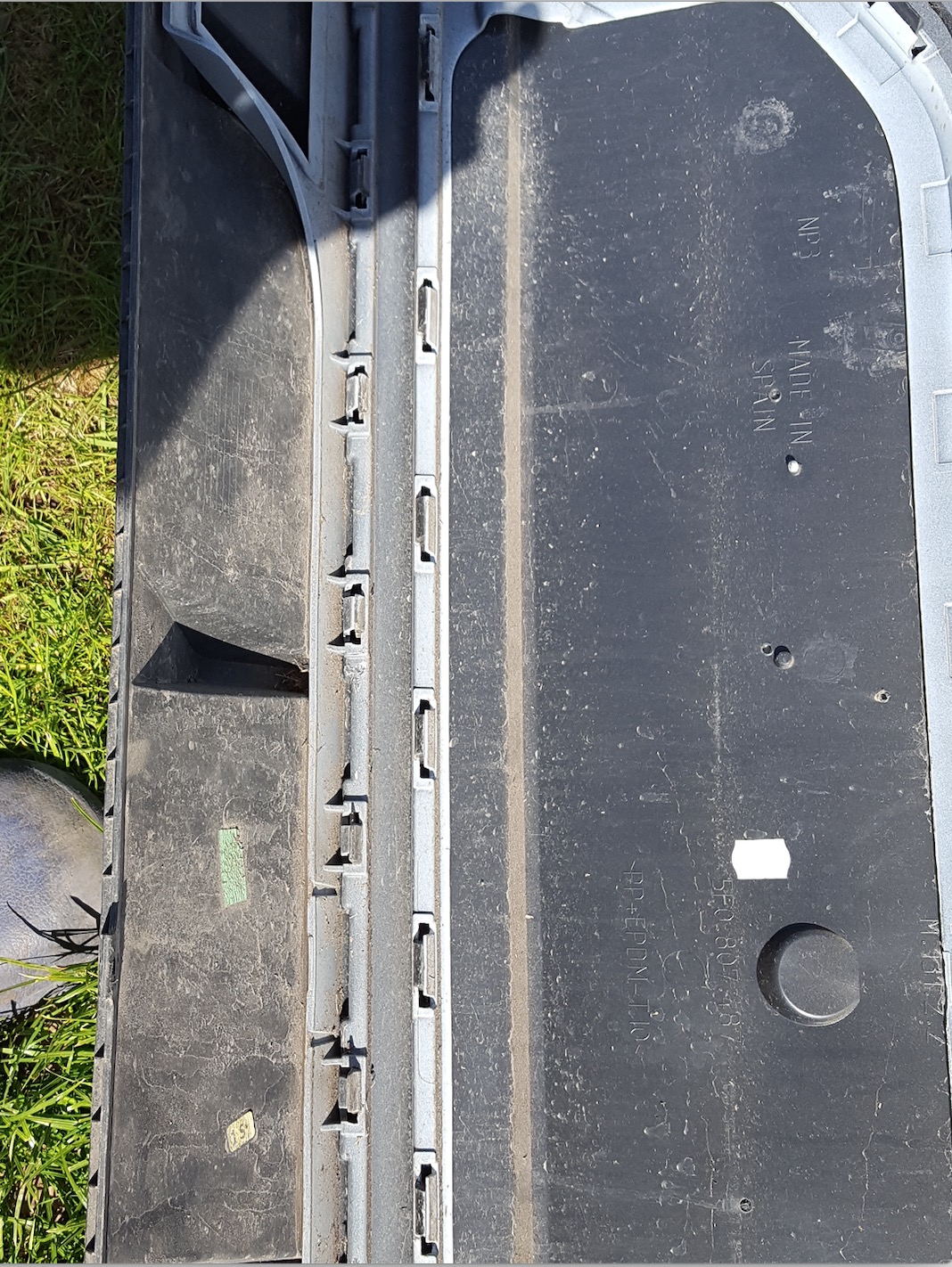

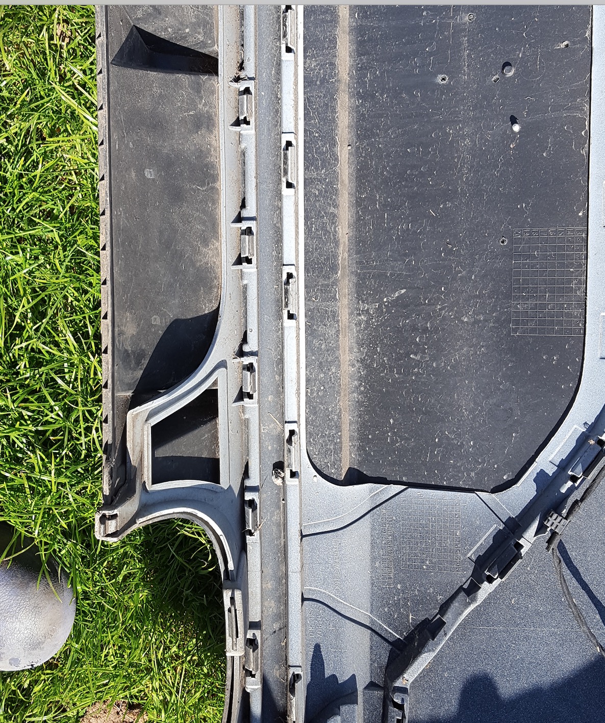

Hi, I need to replace the lower trim section of the diffuser after the wife reversed into some rocks :(. Do you need to remove the bumper to just replace that part (the pice that has the cutouts for the exhaust?) TIA
paddy6789
Aug 31, 2016
1,627
1,082
Preston, Lancs
The stock diffuser required the rear bumper to be removed. It's held in with so many little clips which will induce much swearing when trying to remove.
Deleted member 103408
Here are a couple pictures to give you some idea what it looks like
Mar 8, 2019
great thanks for that. Am thinking of using the multi tool to try cut the clips off from underneath, can peel the diffuser back enough to get at most of them,
