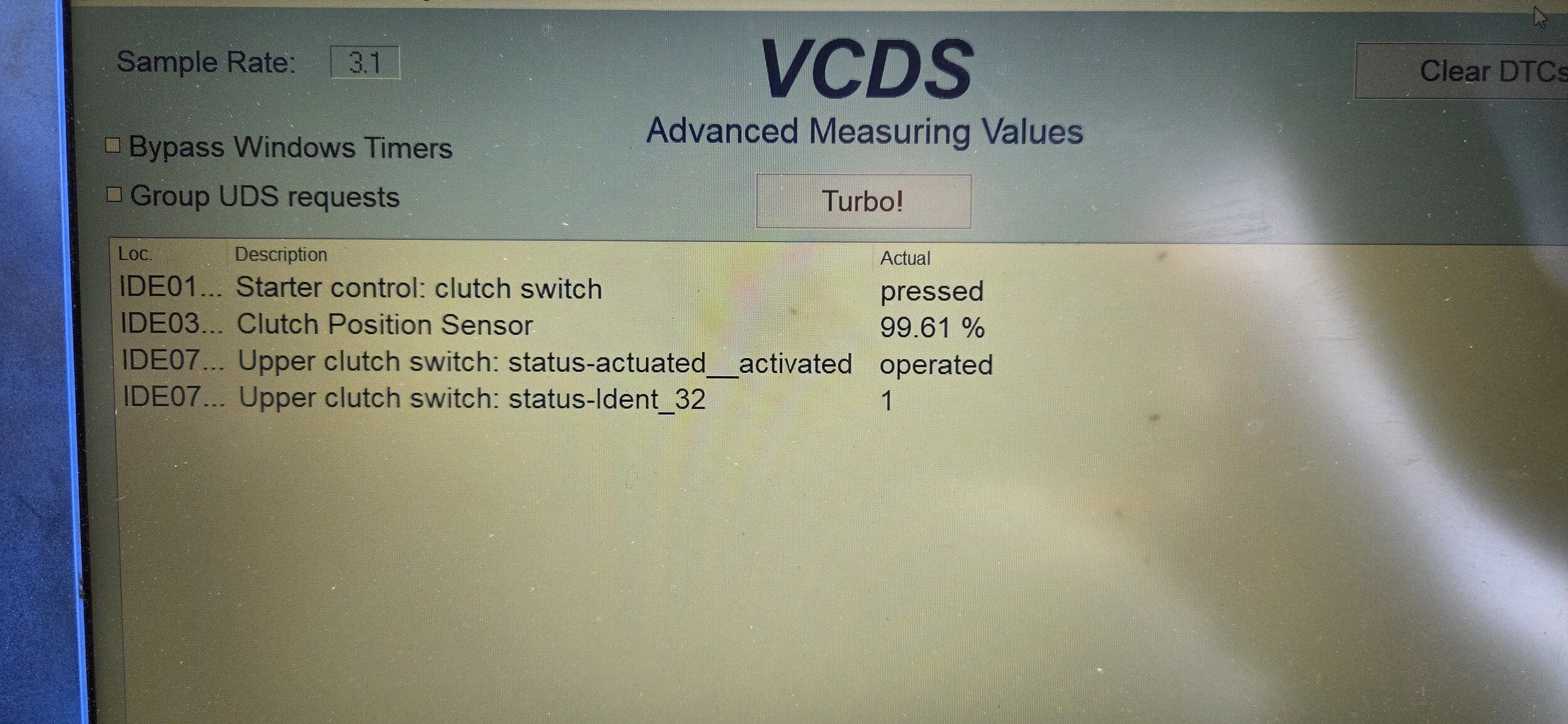

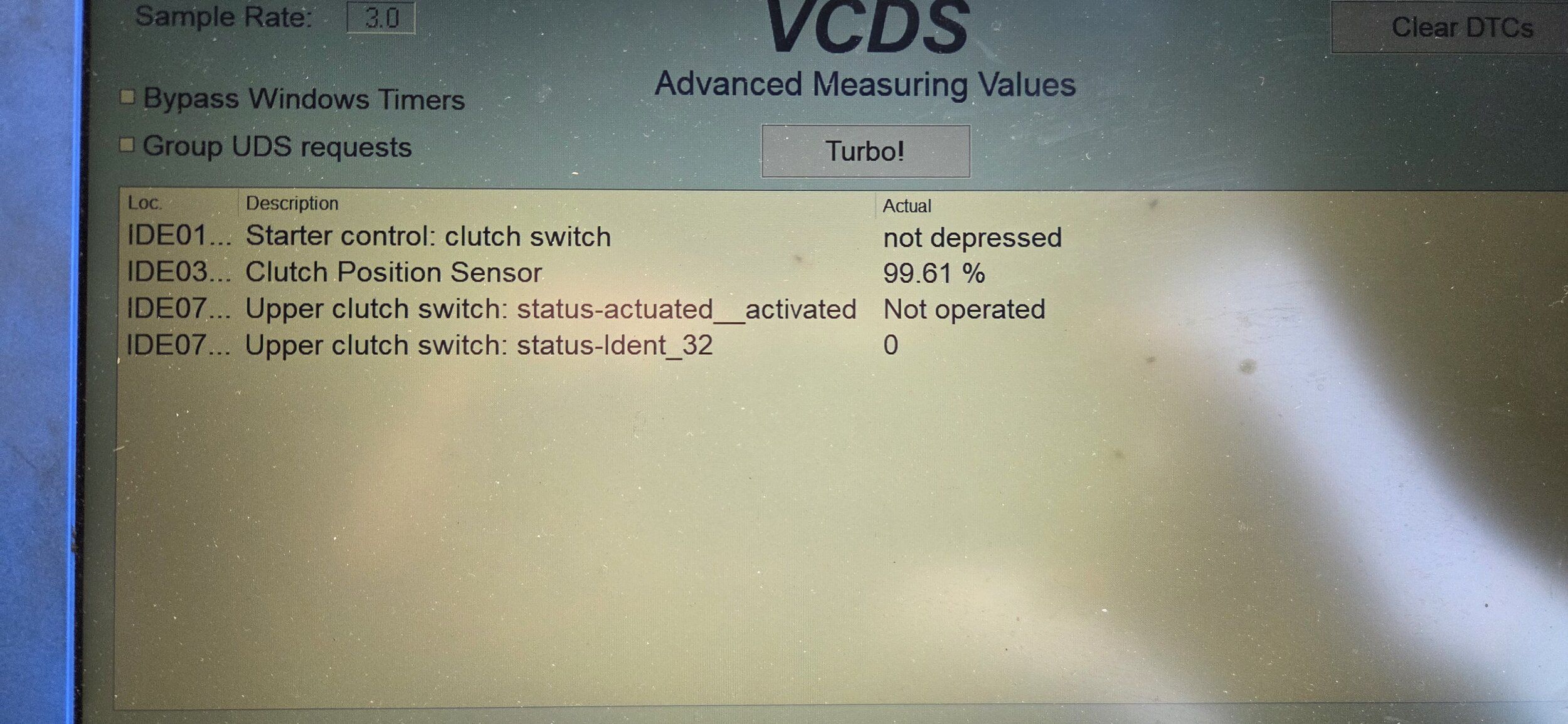

I'm chasing a possible fault on my 2016 Leon Cupra 290 and wondering if any members with a similar car maybe able to help with a measuring block reading.
Basically the clutch position sensor is stuck on 99.61% regardless of pedal position and I'm not sure if there is actually a fault or not.
There are other readings which change when the clutch is depressed and the car starts and drives as it should along with stop/start and cruise working correctly.
If anyone with a similar car ideally with normal handbrake is able to post any vcds readings that would be great.
