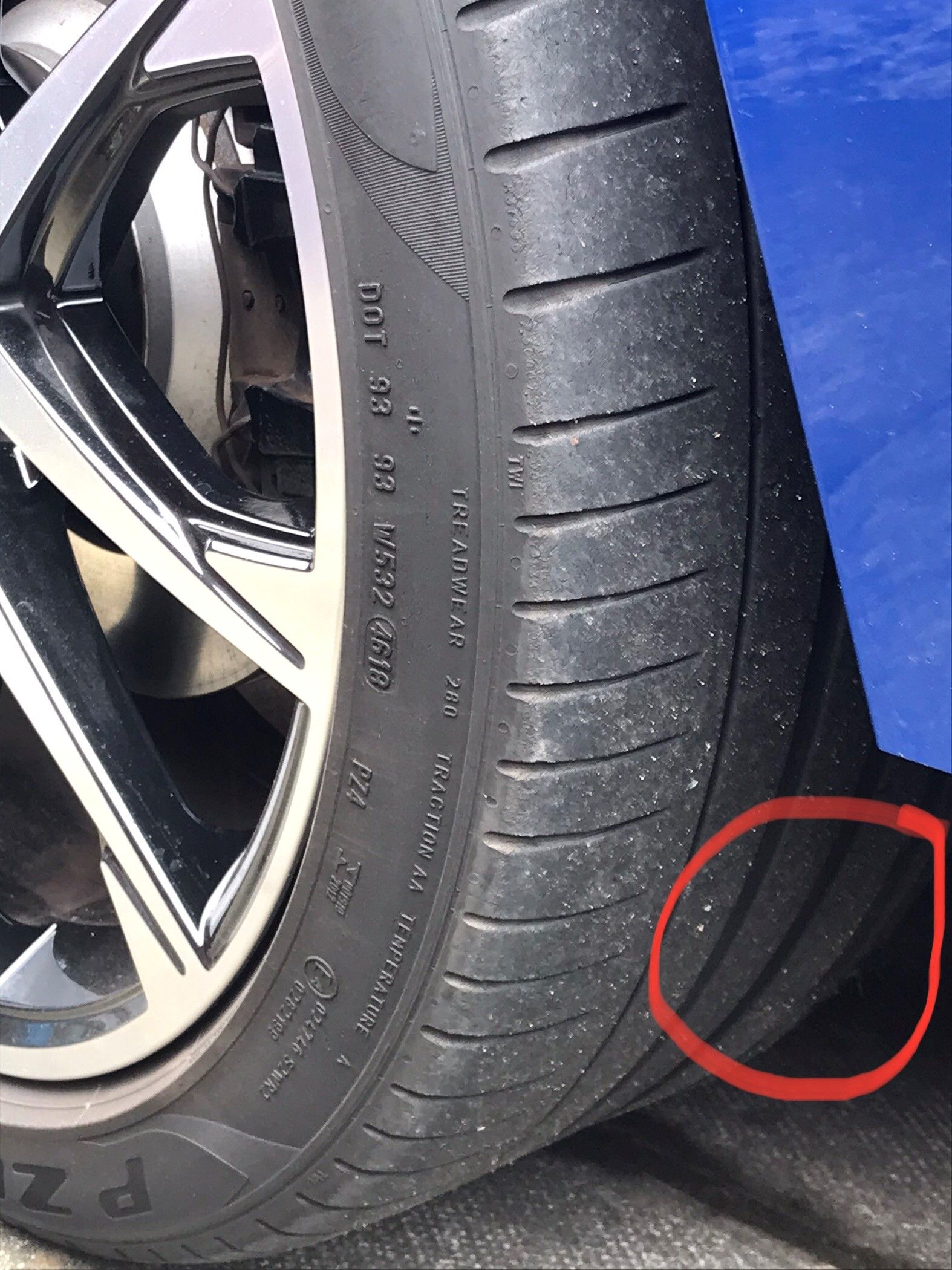

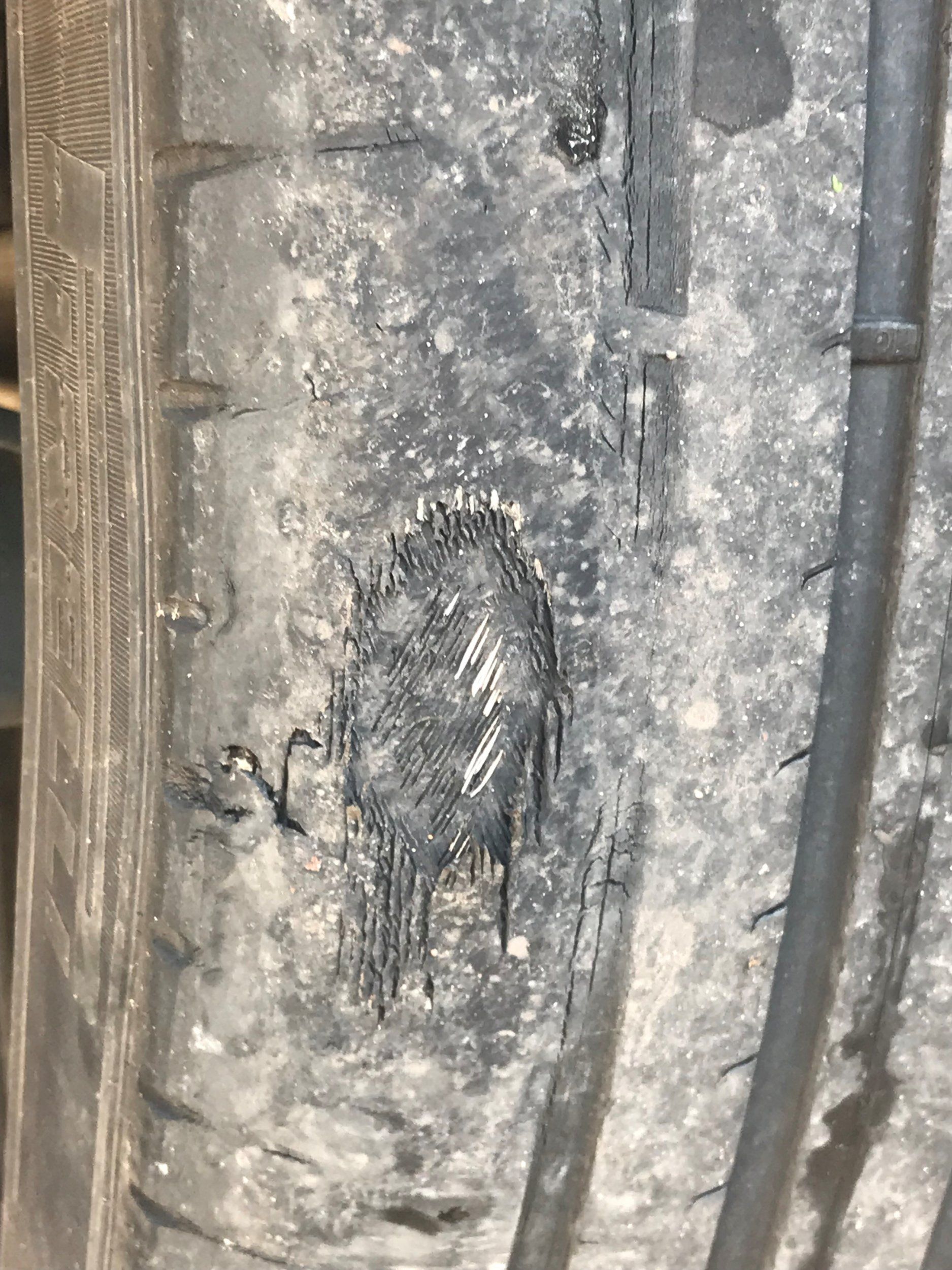

The offside rear has developed a bulge on the inside but only in one place.( see attached )
Looks like the tyre has collapsed as the wires are showing!:mad:
I noticed the issue due to vibration in the seat after going out for a drive.

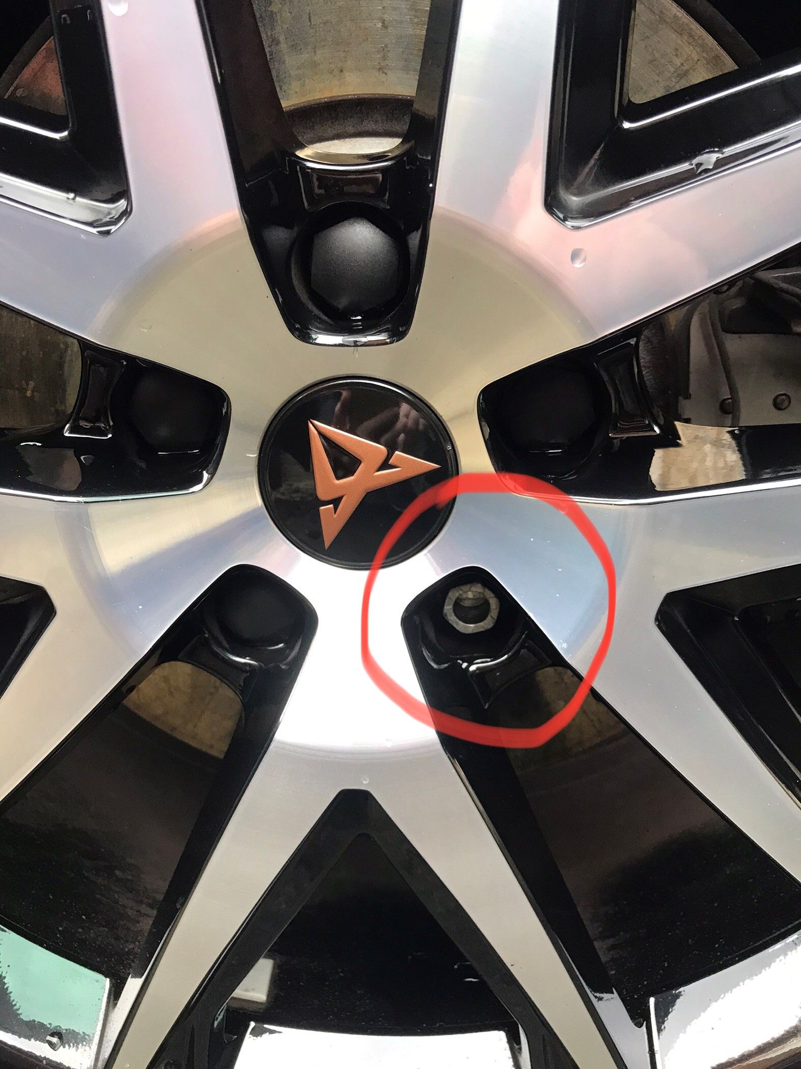

One of my nut caps probably vibrated off!
Strange how it is only in one place as the tyres all round have nice even wear across each tyre plus the car drove very straight and true.
I bought the car as a used approved from a main dealer in December but have only put around 1000miles on it.
I wasn't too happy with the tyres when I bought it as I knew they were wearing down.
Due to them meeting the used approved limit of 3mm they would not look at changing them.
They are the original tyres the car probably came with looking at the date of manufacture on the tyres.
Any idea what could have caused this issue in just one spot on the tyre especially if they were supposedly checked only a 1000 miles ago?

Pot hole damage can cause a bulge to the sidewall. If the bulge has been that big in theory could come in contact with the shock absorber on the inside causing the wear.
Any bulged tyre is extremely dangerous and needs changed at the earliest opportunity
The missing cap is a Seat thing. My new 2018 leon lost 3 of them within the 1st year. Infact most times i drove it something else fell off
Hi Jase
The bulge is not in the sidewall it is on the main part of the tyre which is in contact with the road albeit towards the edge on the inside.
This is why the car started to vibrate through the seat.:eek:
The scary thing is I was out for a blast before noticing it on my drive home as the vibration got worse due to the growing bulge getting worse.

Oh right i see. Probably just down to the canvas. The camber cars use sometimes makes the inner edge of the tyre wear quicker. So although you have say 3mm on the centre / outside then it can still be bald on the inside.
Yeah cords showing can mean instant blow out / loss of control / worst case scenario death.
I wouldn't even drive it to the tyre place imo. Not worth the risk. Plus the fact your probably 3 penalty points straight away there

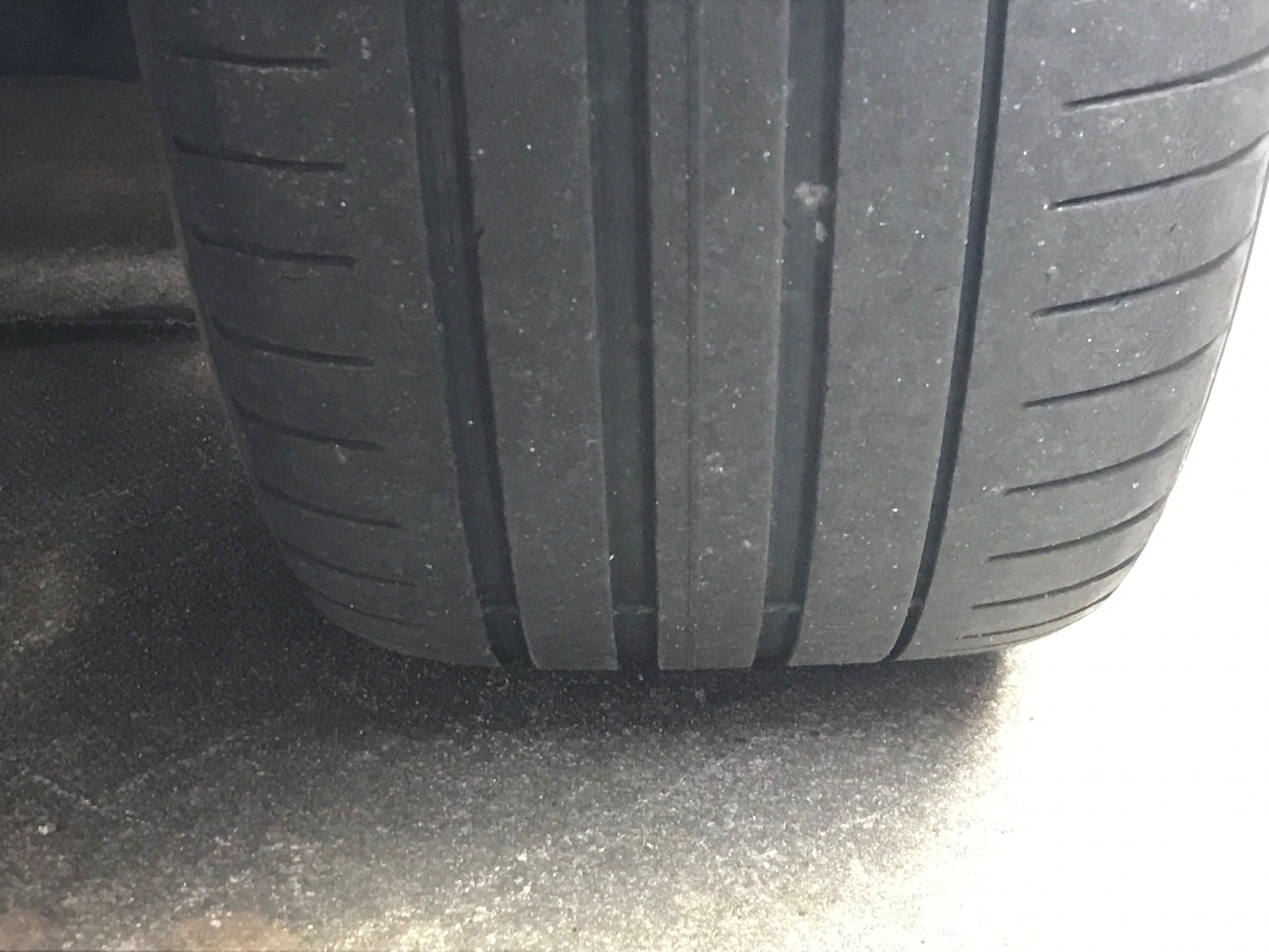

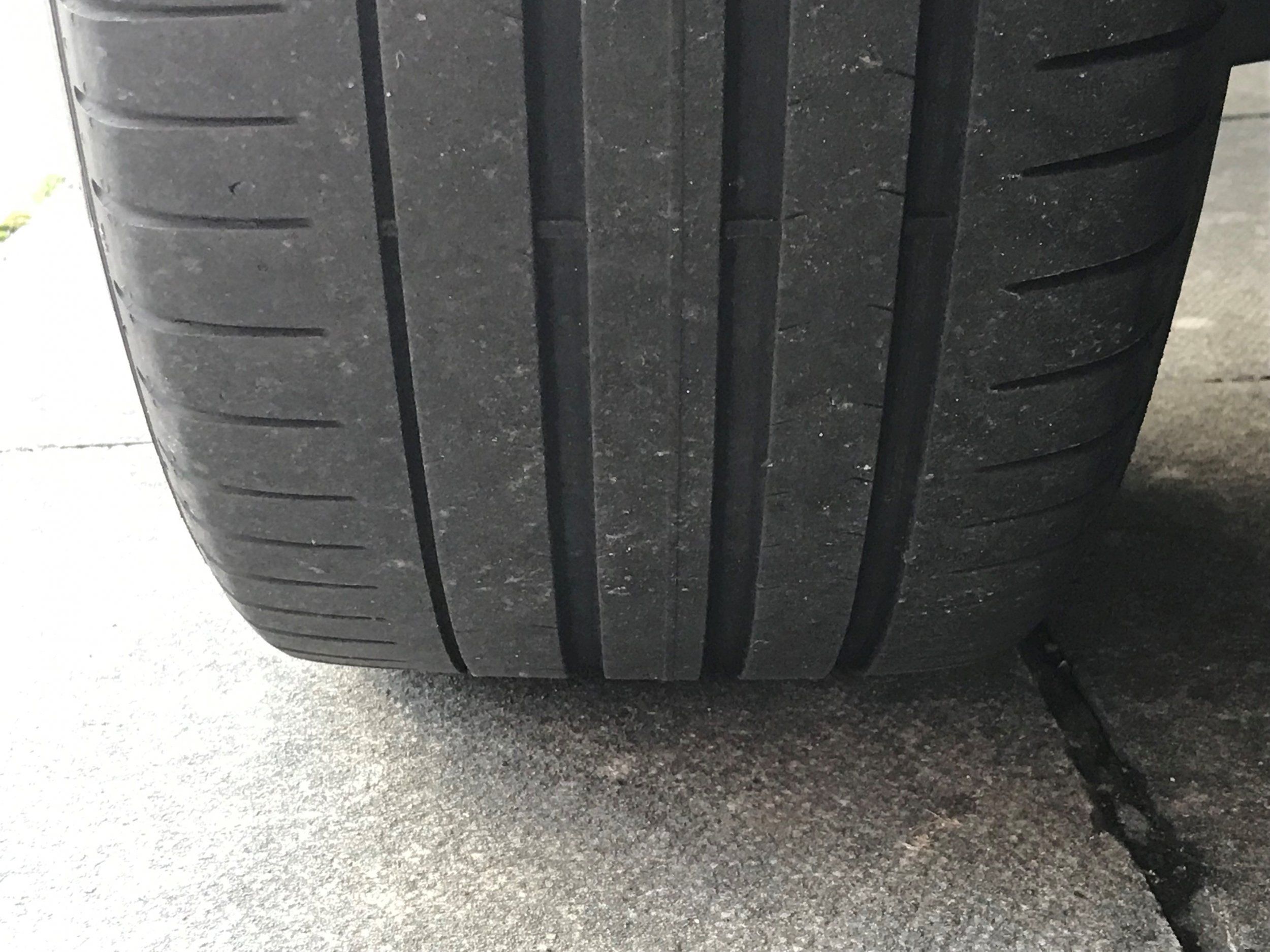

Hi Jase
The rear tyres are worn pretty even across the full width of the tyres.( see attached)
They are not bald on the inner edge.
The bald patch on the offside rear is on the bulge and the bulge is only in one spot which I find strange.
It is like the tyre has collapsed in one spot and then worn very quickly?
I will not be using the car until it has its new boots fitted all round.

Weird can only assume pothole damage ?
Yes it is mate.
I don't remember hitting anything on that side which makes you wince. Ha
I think the tyre has internally collapsed in the one area and then has quickly worn where the bulge appeared.
It was only the vibration which made me look closely at the rear tyre and luckily on inspection it was in a position where I instantly noticed it!

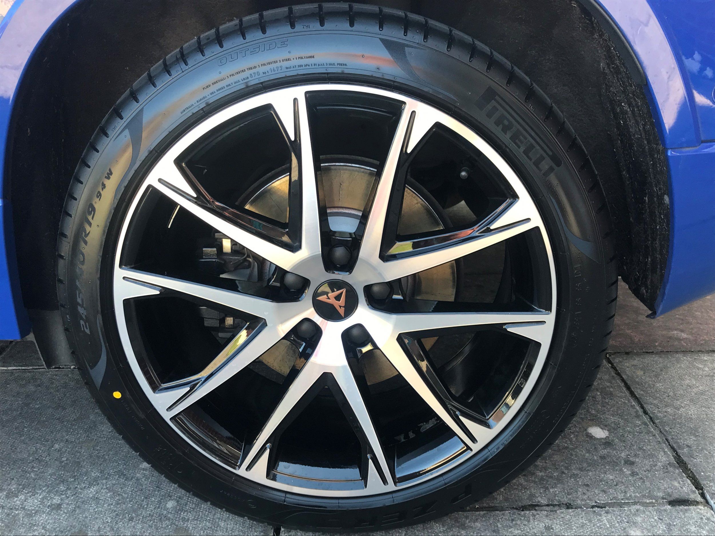

Had my four new tyres fitted the other day.
The car now drives like new again.(y)
For anybody in the Manchester area I can recommend Volksmaster as they changed all four tyres without marking the wheels and they were very careful.:cool:
I have had multiple bad experiences in the past when it comes to having tyres fitted!:mad:
The rear tyre with the damage was very strange as it was only in one spot and all the tyres had worn very even across.
It looks like the tyre had failed in one spot.
Reactions: Jay5959

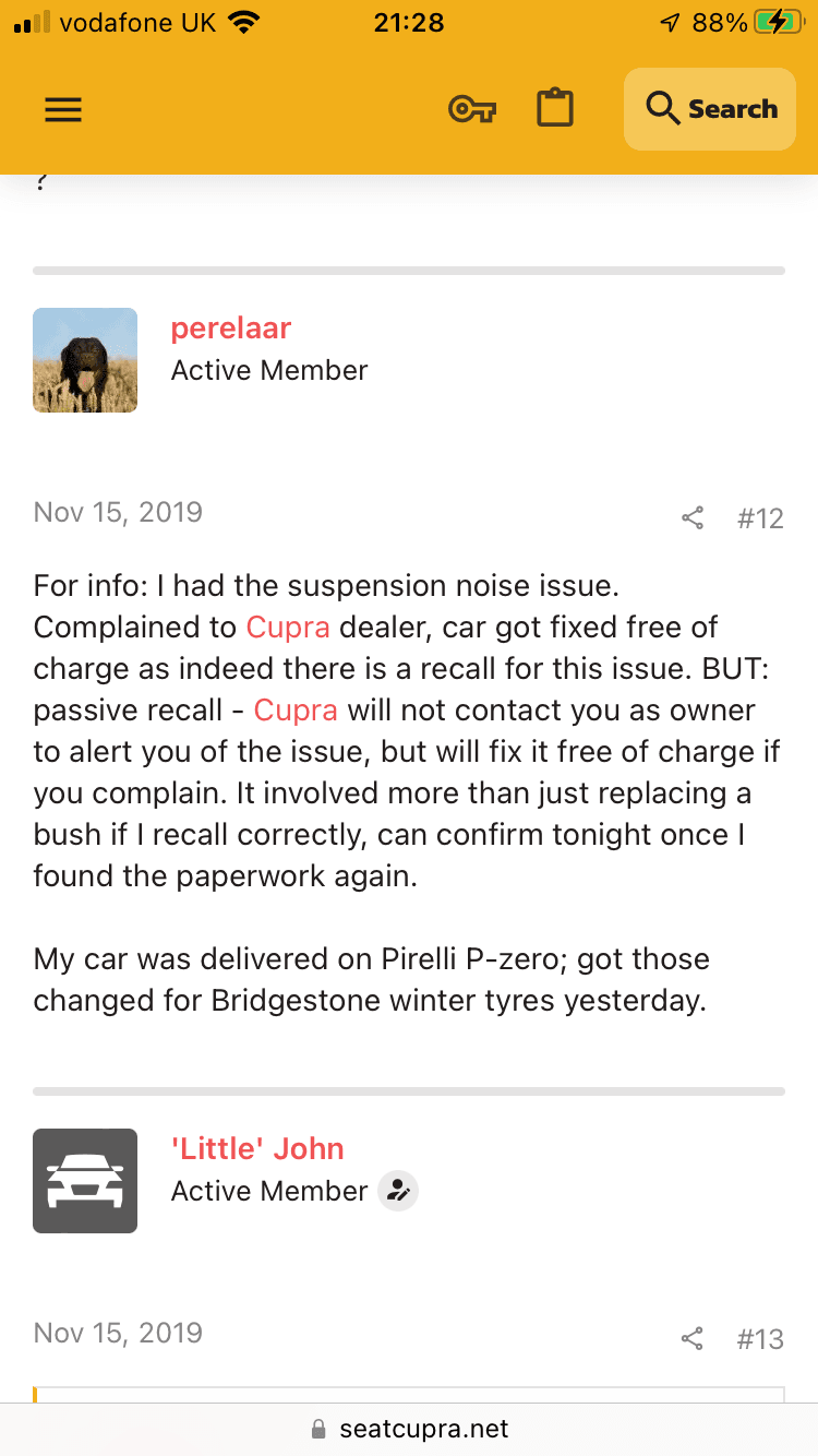

How do you find the ride? Obviously with 40 profile tyres I expected it to be firm in the sporty modes.
Even in comfort mode mine feels very firm up front when driving over the typical bumpy roads we have.
Been thinking about getting it checked out under warranty but as the car drives very true not sure I want them messing with it.

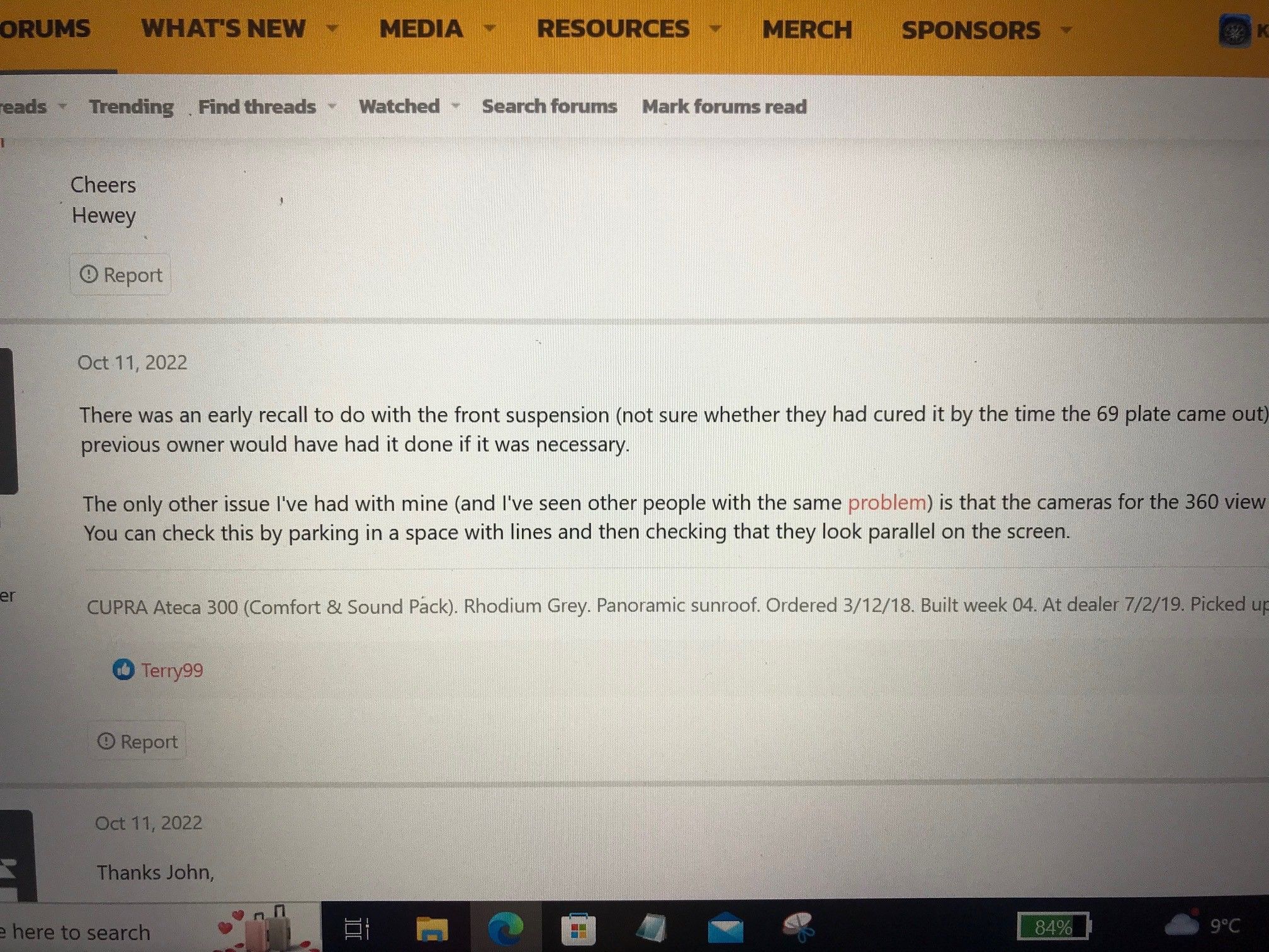

I have read there was a recall to the front suspension on here so not sure if it has had it or needs it?(see attached)
