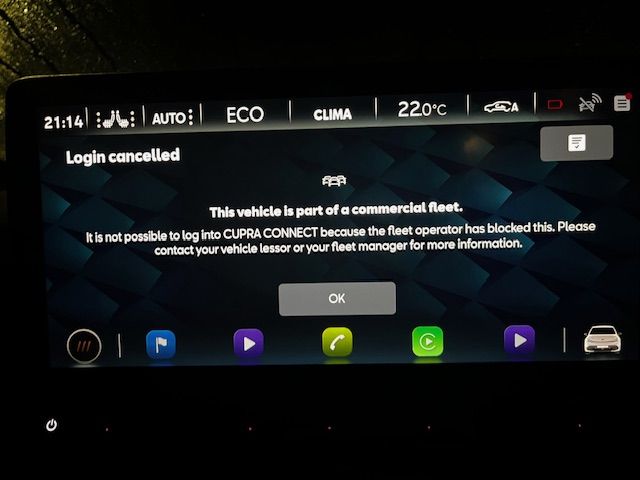

Well I think it is worth. Certainly if it's an EV with the remote controls. The cars are designed around connect services these days only if you live in a country where the service isnt available you wouldn't be getting software updates over the air, map updates or radio icon updates.
Yeah im new into EV's, this is the first one we've had so i thinking it might be worth the cash. I'm also in Scotland so im hoping i get all the software updates needed.
Yeah I've no idea. I would have expected Dealers to have the ability to do this prior to a sale. Call the Cupra Arnold Clark near me and the service dep didn't have a great deal of info on it other than bring it in to us and we can look at it. Cupra's live chat support was also rather useless and just sent me on a email trail.
They could have pushed the update that enabled it like cable and TV boxes. Having got the VIN pushed the update. Hidden hands. May be the call centre dont know exactly what their screens do. Like Virgin Media have you rolling around on the floor pulling the plug out, waiting x minutes and turning back on etc.
