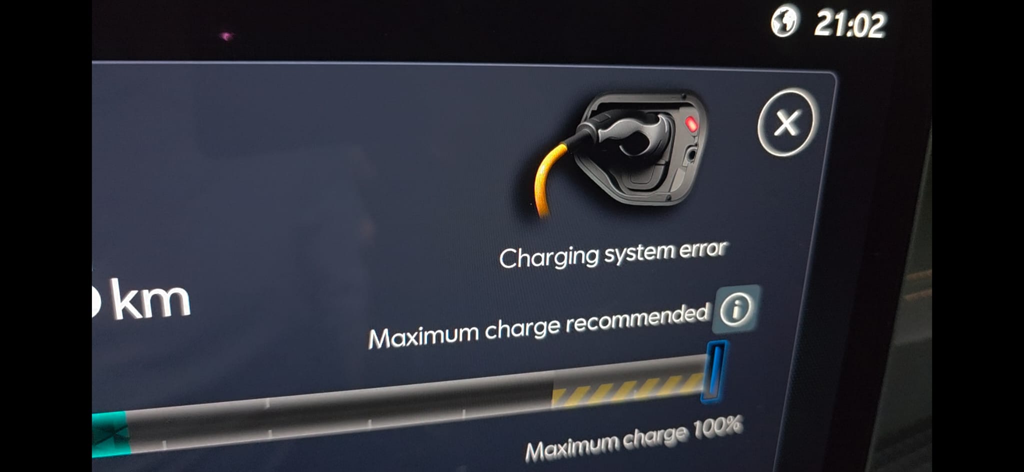

I have a question for the Facelift PHEV owners...
I picked up my "upgrade" (from pre-FL to FL Formentor) a few weeks ago. The problem I have is that each time I connect the car to the charging station, after a few seconds (checks/comm car-station) the RED LED comes ON at the charging port of the car, and the infotainment charging screen says "Charging system error". The solution I found (and it always works!) is to get into the car, put the ignition on (Start-button without pressing the brake pedal) - and this somehow "forces" a new check/communication between the car and the station. In a couple of seconds it starts charging without any other problem.
This scenario is the same on every charge attempt, and it never happened with the pre-facelift Formentor that I was charging almost everyday using the very same charging stations.
Any of you had or seen a similar behavior?
Small (and sad) update on the problem described in my previous post:
- had an appointment with the dealership after almost 2 weeks of waiting
- they scratched their heads for more than 3 hours, scanning for errors, charging the car (with a wall-socket adatpter - not with the AC cable) - found NO problems!
- explained them the errors occur EACH time I'm charging @AC station -> they tested with the AC station they had inside the workshop - it was faulty. Went outside in the parking lot to test with a different station - it was also faulty, but they managed to make it work after several restarts (the charging station)
- they managed to charge via AC after many attempts, but by that time it was already hard to say whether it was a problem with the car's charging management or with their charging infrastructure... :cautious:
- they also checked for SW updates for the charging system - all up to date
- I left the dealership convinced they didn't fix the problem, told them I'll let them know the result once I get back home to the charging stations I usually use
- obviously - the problem persists: I get the same error at each charging-attempt, and I can solve it always with the "procedure" described above.
I'm seriously thinking about writing to Cupra HQ, but I doubt they'll have any solution other than sending me to the dealership again and again...
