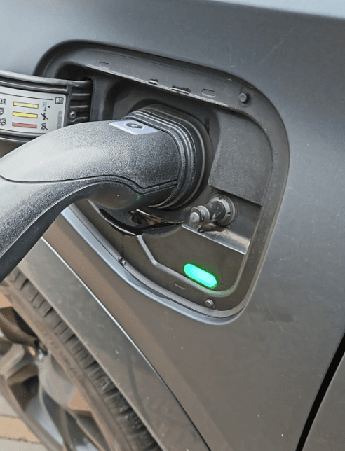

Today my Formentor began to do the same; when a charging cable is plugged to the socket the white light goes off and a green light is not getting on. The cable is also not getting locked to the socket. However on the display of the car it shows that the cable is connected. But no charging is happening.
Couple days ago the outside temperature was couple celsius degrees plus, but now there has been only minus degrees. I was thinking if a some lock mechanism could be frozen and I tried to use hot air blower to warm the plug but no success. I know I have to book a garage, but I know that even in the best case it will take some weeks before there are free time slots in Cupra service.
I have tried charging on one charging station also, the problem is not in the charger or in the extension cord.

I have the same problem since this morning.
Last night the car was fully charged at home. After driving to a customer it won't lock the cablesocket of the car and start charging.
The white light turns off when plugging in the cable. Normally the green goes on and starts blinking while charging but now nothing happens.
Tried several wall boxes with my yellow cable without any luck. Also my own wall box with fixed 8m cable won't lock and charge.
Plugging it in slowly or moving it a little in all directions doesn't help.

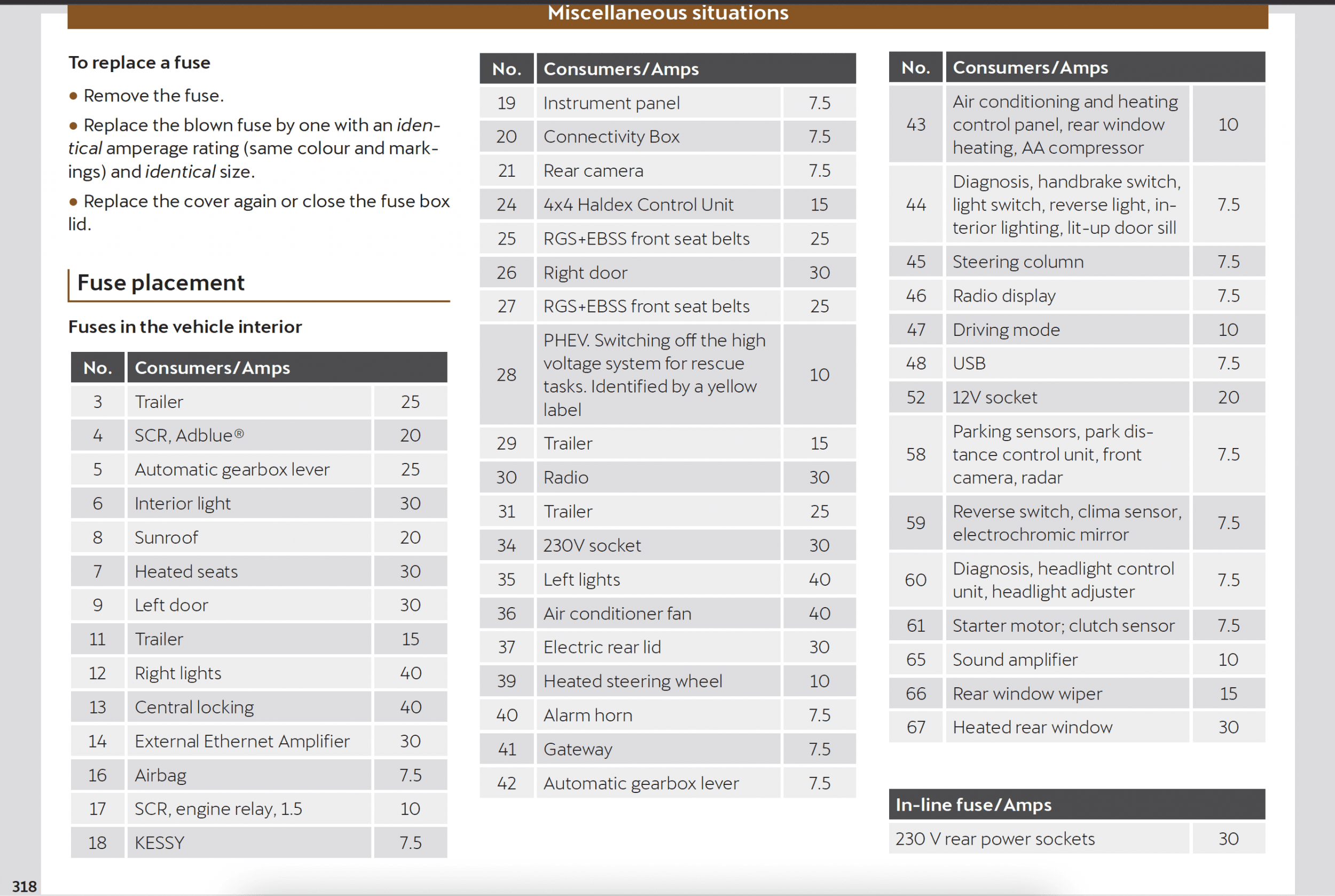

Yes, the hybrid management system needs a reset when it fails to lock the cable. Removing the corresponding fuse for several minutes would suffice, but I couldn't find it in the Fuse-ox diagram of Formentor. The problem has an identical solution on Octavia 4 (same hybrid system) - but in that case Skoda was kind-enough to provide a clear fuse diagram, so it's easy to identify which one to remove.
Any idea where the fuse is located thanks

Unfortunately not. As I mentioned above, the Formentor Manual only mentions the "master"-fuse for the HV system - to be used in case of emergency (see picture). I can't say for sure if that is the one also resetting the charging controller of not - sorry! Try to check your User Manual - in case you have a different fuse layout, it might happen for different years or markets.
The Sk.Octavia manual was crystal clear on this aspect - there was a separate dedicated fuse for the HV charging control system.
Hi just in from work checked the manual and exactly the same . What should I try tomorrow please. This is so helpful and appreciate the help
