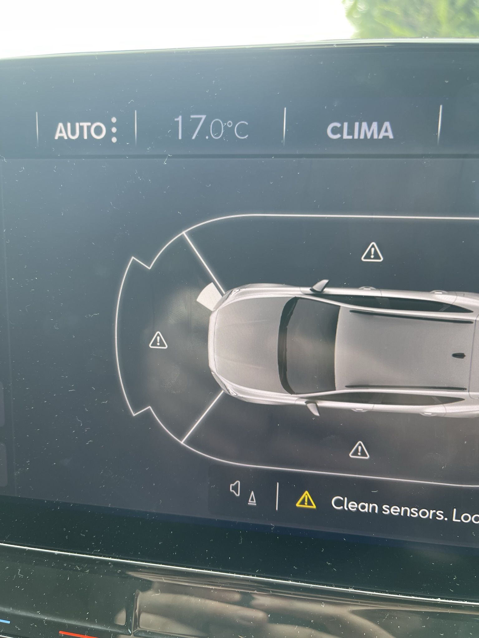

We purchased our Formentor last July and it has been generally a good car. Some glitches with the Infotainment to be expected.
Once we hit summer this year, when the car has been left in the sunshine or it is generally above 25 degrees, the front parking sensors fail on start up, and continue failing while it is being driven (when you slow down for example, they fail to turn on and it notifies you, over and over and over!).
The first error is 'Manoeuvre braking currently unavailable', then when you engage reverse 'Park Distance Control: please clear front sensors. Look! Safe to move?'
The front, and side parts of car which usually show any obstacles then show a small grey exclamation mark in a triangle.
The car has been to Braintree SEAT and I'm fairly certain no proper investigations were done, the Infotainment system was updated to the latest patch and given back to me.
Have a call in with Cupra to put pressure on them to get it back to look at as they won't even take my calls now.
Has anyone else experienced similar and found a resolution?

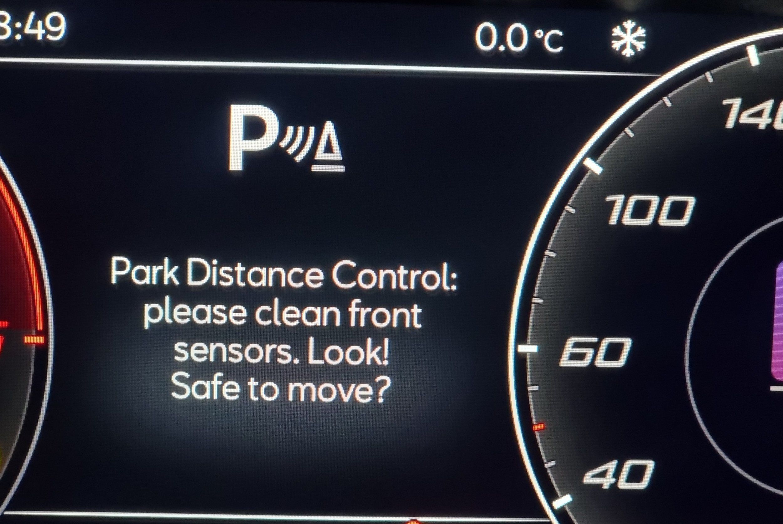

I have the same problem with my seat leon MK4. Error report:
Park Distance Control: please clean front sensors! Look! Safe to move?
(see atch.) All front and side parking sensors are disabled as well as some other parking systems.
It has happened to me for the second time this year. The last time I had to replace the sensor. Now I have found some videos about cleaning sensors with WD-40. It didn't help me in my case. I pulled out the sensor, cleaned it, put it back and without any success. The problem persists. Is there any new ideas? Or Do have to replace parking sensor twice per a year?

To buy another sensor on ebay from a crashed car and replace the faulty sensor.
Then everything works again.
Prices on ebay are from 20€ and more.
The new one certainly costs more than €100

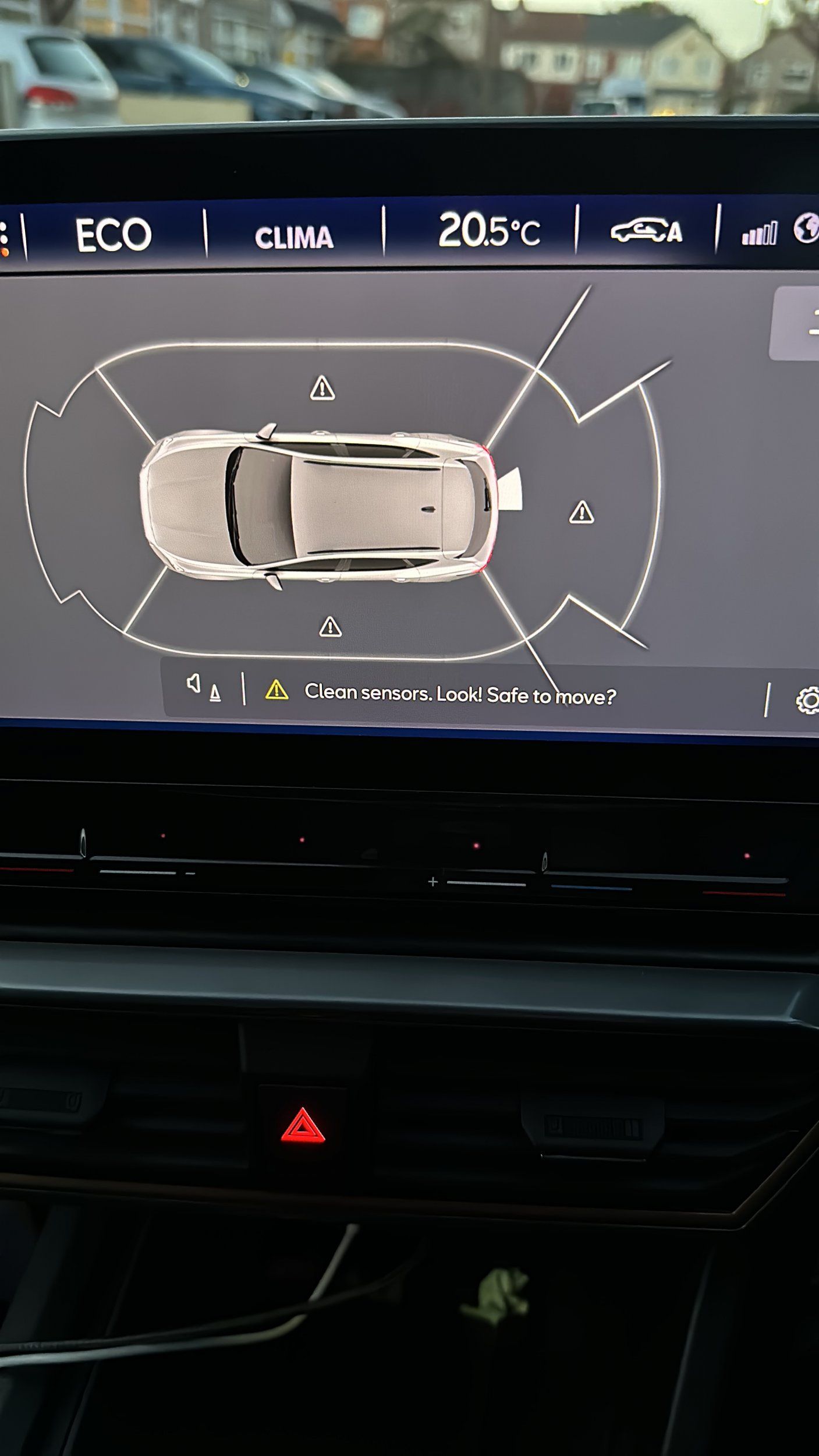

My car has suddenly developed this fault. Manoeuvre parking and parking sensor fault. I’ve cleaned the sensors and there’s no marks or chips on them. Anyone had this problem recently?
Nov 20, 2024
Mine has developed this recently on the rear, 2nd time in Cupra today to diagnose further by taking the bumper off, and they’ve come to the conclusion that because there is a scratch on the sensor under some light. That means it’s not eligible for repair under warranty (as it could have been a stone) and it’s going be £507 to get It fixed. Or £99 for the investigation fee if not fixed.
This happened to me twice. Sensor was also whitout marks or chips. Cleaning didt help. I had to replace the sensor. I recommend buying a used sensor on eBay. Prices are around 25€ and more. You replace the sensor and everything works again. The sensor number is 5WA.919.275 (A,B,C).
