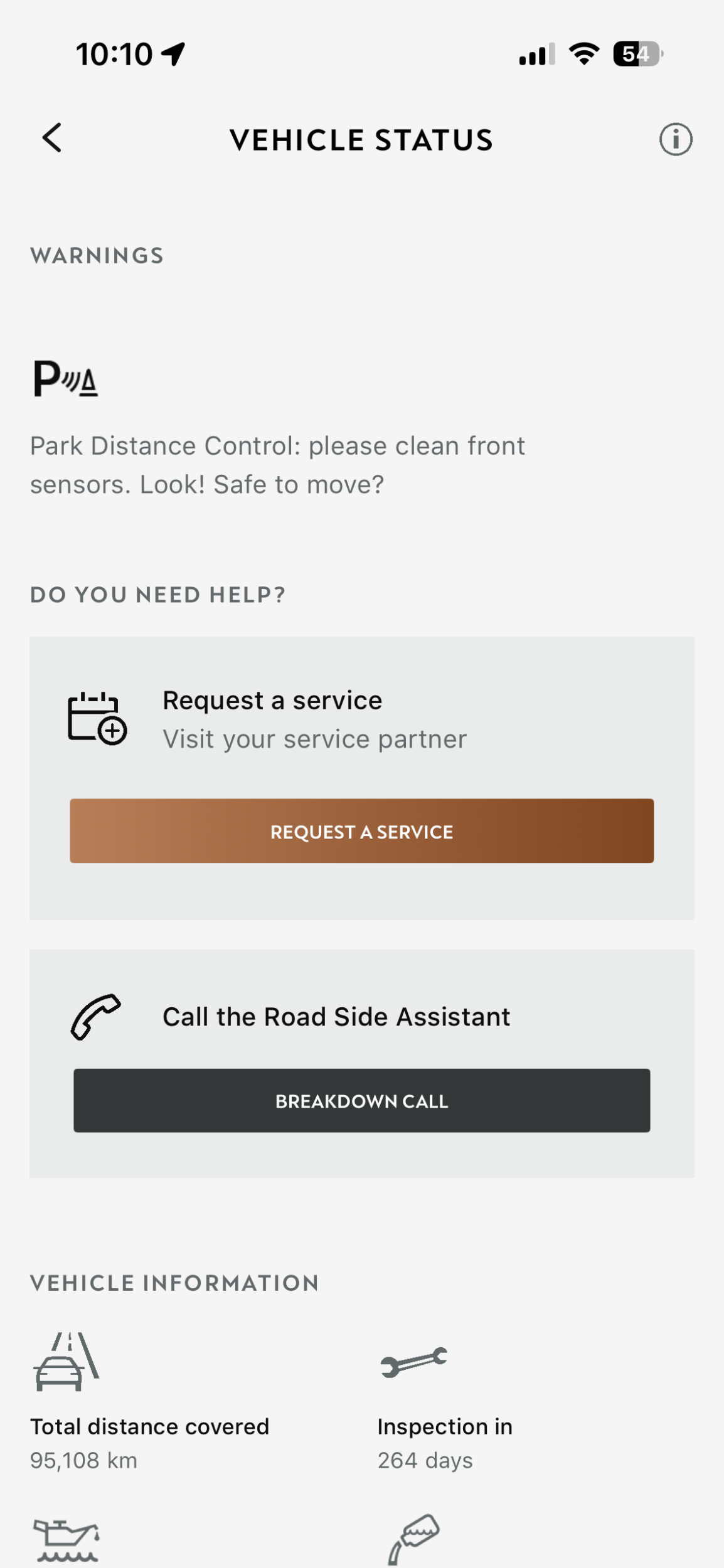

hi I have a Cupra Formentor V1 2022 and my parking sensors (all bar the rear one) are not working. The car displays an irritating message about manoeuvre parking being unavailable a couple of times per journey and there are grey exclamation marks on the display around the vehicle when parking.
I have had a look and can see a small chip in the front right one near the number plate. Is one being damaged likely to throw the others off? The real question is, how easy is this to fix myself and where do I buy the part from? Cupra have quoted a lot of money to fix 😫
This is displayed on my app too

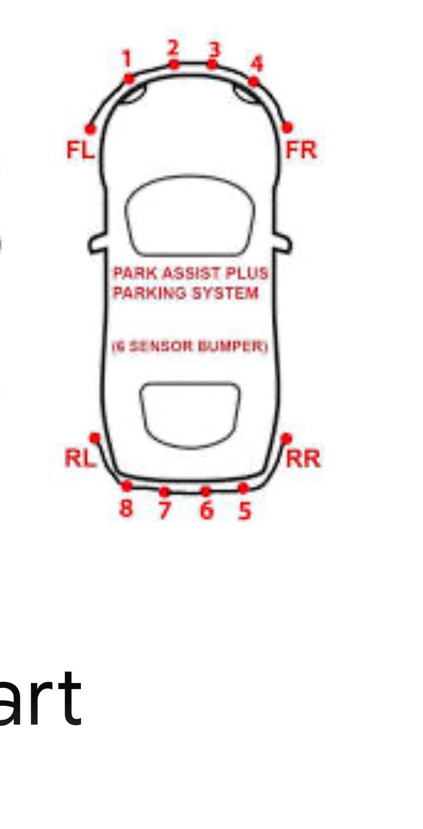

It’s the rear right side. The one in the black bottom trim. I think I can get my hand in from behind as there is a gap but obviously I can’t see what I am doing it’s by feel.
It’s number 6 on the image below. Also I think the part number is 5WA.919.275
Is this correct? I was looking on eBay, any suggestions?

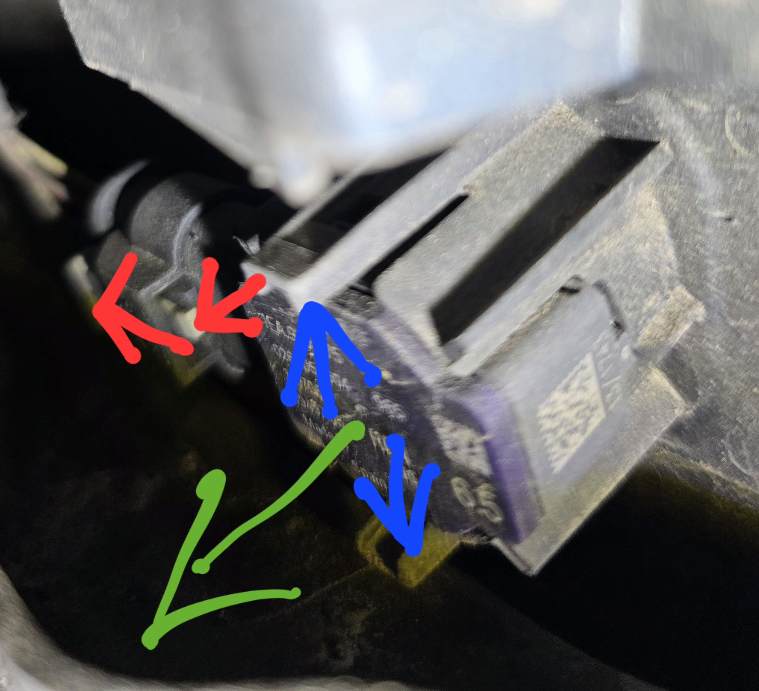

You need to lift the grey tab and push the plug off (red arrows) then spread the tabs on the sensor itself (blue arrows) then push the sensor back into the bumper.

That really helpful , thank you for the picture and info . It’s really appreciated
Just an update for anyone else with the same problem. Successfully changed the sensor. I found it easier to push the sensor back through the bumper first , whilst lifting/levering the holding tabs one at a time to free it. (I used a screwdriver gently as they are quite stiff) Then pushing the grey tab to release the plug as you then have a bit more play.
Didn’t have to use a diagnostic tool to cancel the fault , worked straight away 😃👍
