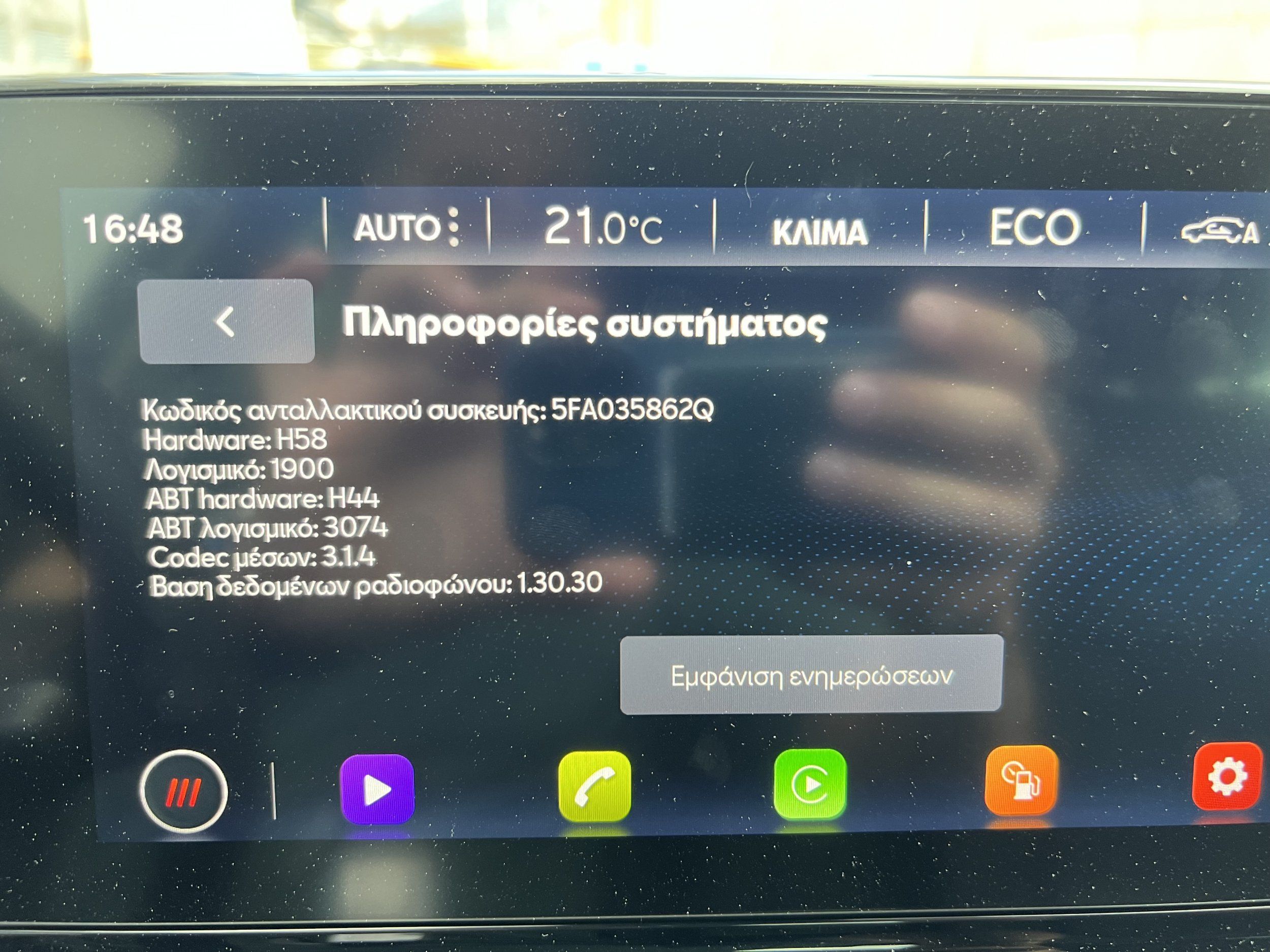

I finally got the car back a week ago! My formentor plug-in hybrid was at the dealers for 3 months!!! Because they we’re waiting for an update to fix the blank infotainment screen and safety errors. After dozens of complains they agreed to replace the cpu of the car but they told me the error might come up again. After I got the car from the dealers a week ago, I have the new software update notification but I am not going to update because I don’t trust at all this brand. I will stay with version 1900. There are More chances to replicate the black screen problem. Although I have the car for one week now, one day it complete reseted the screen by itself and lost all settings, stations etc. like I was using it for first time. I truly regretted choosing this car and never going to choose anything from WV group ever again.

I have had my car for 2 years without any trouble other than the rebooting trouble which started 2-3 months ago and the occurrence of an SOS fault which happened a month ago. Took the car to the dealer who said that there was a connectivity issue. I was told that the upgrade would most probably cure the issue. If not, then they would check the BDF module i.e. the connectivity cpu. I have been upgraded to 1940 and all seems to be working fine so far.
Mind you that after I had the upgrade done I needed to have both keys in the car in order to get me back as the primary user.

Hello, I am located in Athens, Glyka Nera and the car was at Velmar dealers in Gerakas. So far from the thread seems that 1940 is good and no issues. But I am hesitant to update yet. I will wait for some time and if no issues occured from others I will book an appointment for upgrade.
Both keys after the update is quite difficult as the car is with leasing from Hertz. Have done that once in the past to enable the remote lock/unlock from the app and it was time consuming. Thanks.
