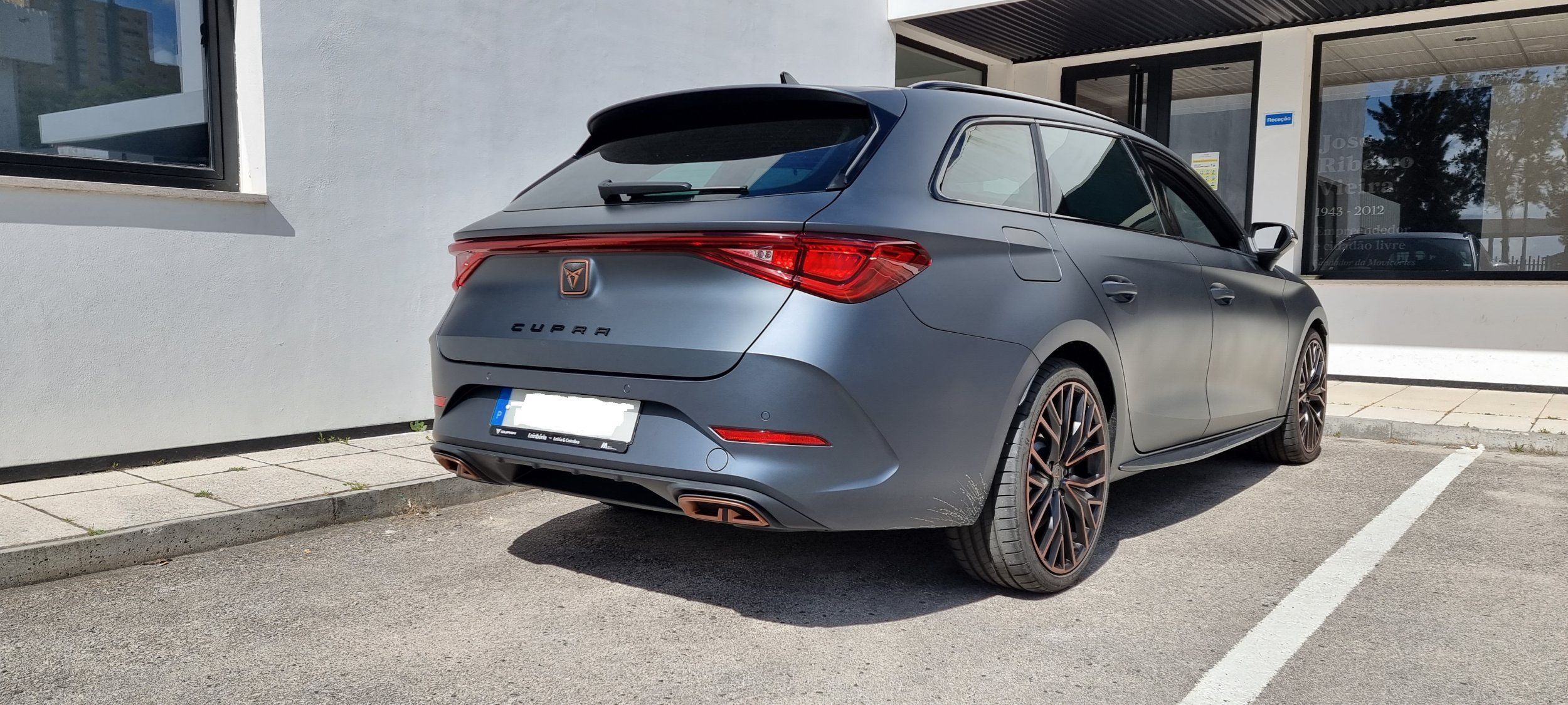

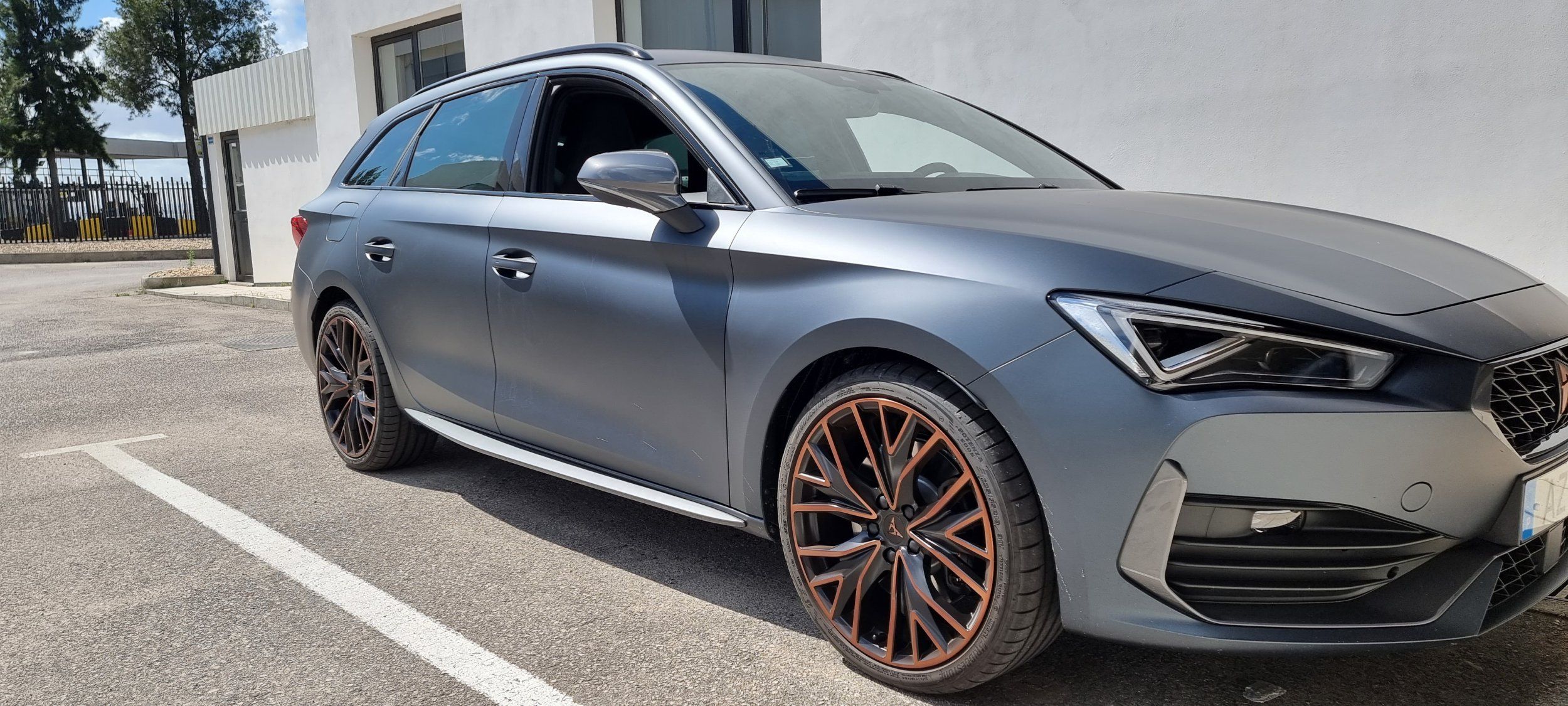

for my first new cupra st phev i paid 44000 euros witch was the base model with no extras.
after complaints and writing emails to the CEO's of Cupra Seat and VW Group telling them that i was going to take legal action they contacted me and told me that they are going replaced my car with a new one.
The car that they gave me is full of extras inc, diferente alloy wheels, safety pack XL, Mat Paint, Cupra Sports Steering Wheel, Matrix Headlights, Side Skirts, ect....
This car costs 53500 Euros and i did not have to play any extra.
Had to wait 4 months for the car but finally arrived.
here are some pictures of my car.
