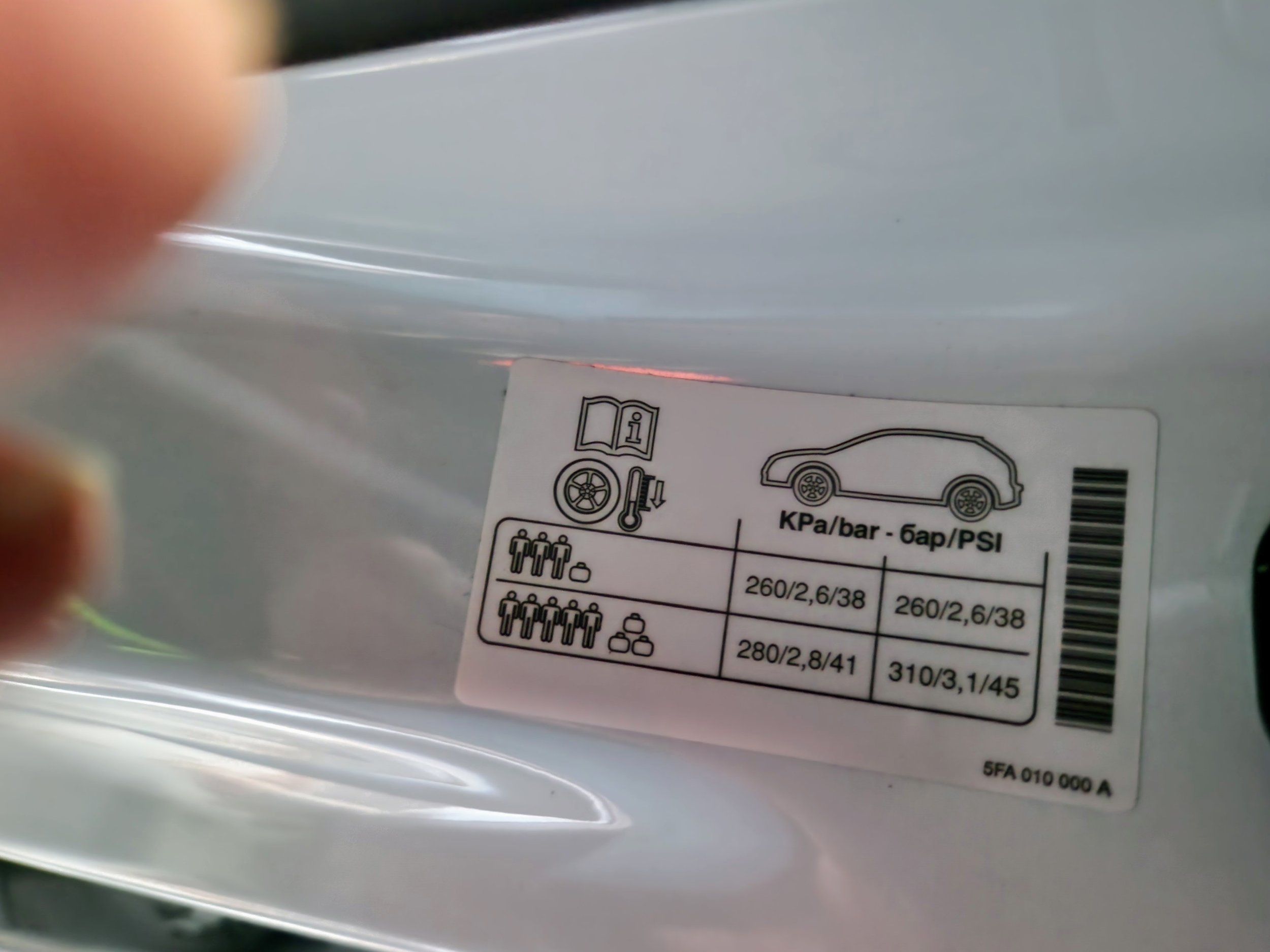

The tyre pressure sticker on my car only has one pressure shown - see attached. Where did you find your "comfort" setting?

^^^^ Comfort pressures will be on the door pillar sticker.

^^^^ Tyre pressure label;
Comfort setting is the middle row, with the i referring to explanation in the handbook.
