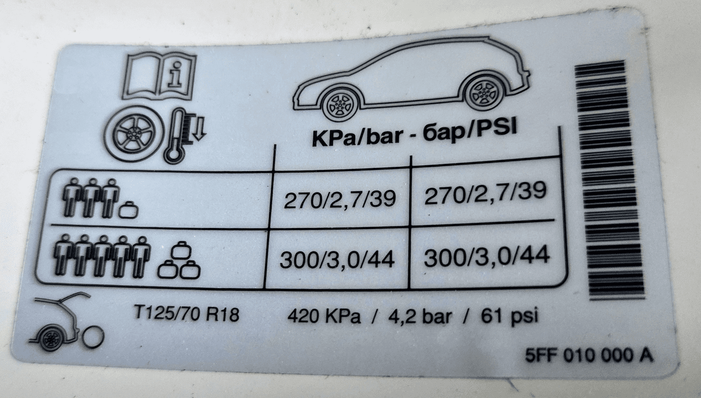

What tyre pressure setting do you run?
On my Ateca VZ there are Standard and Comfort settings. The comfort are 0.3bar lower. Makes a big difference to ride quality, and actually grip better when pressing on.

I am driving with (DCC) suspension on comfort mode or individual and slider all the way to soft.
The tires are pumped to the recommended pressure (2.7 bar) for normal load with up to 3 people.
