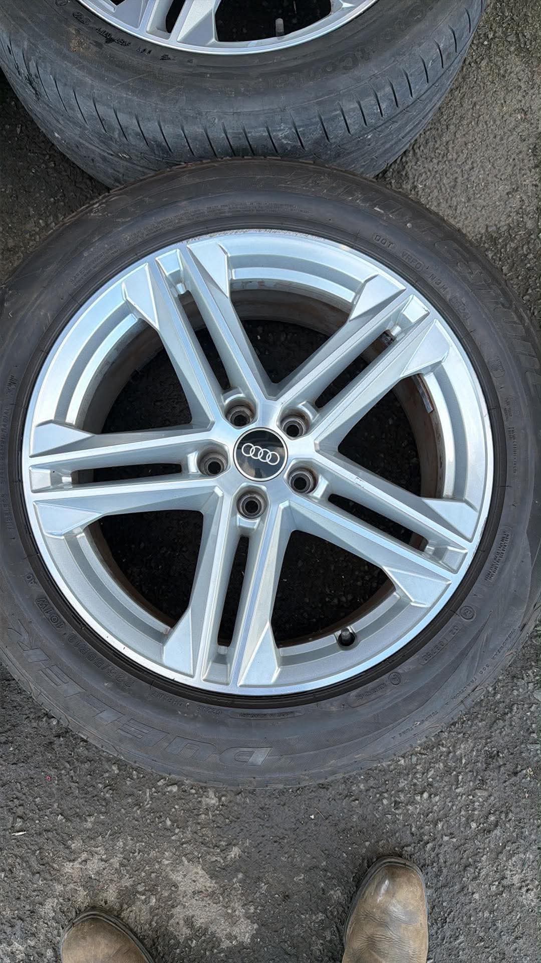

I have just brought these off an Audi Q5. They are an et39 and need a spigot ring in the middle as the centre bore is a bit bigger than ours
