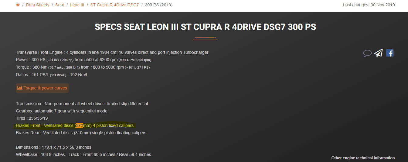

... but if you have the brembo 370 mm front disc/callipers then you are stuck with 19”...
I am having a really hard time getting exact information on my model number as the models listed on the official Seat parts catalog don't match anything on my registration. The closest I can find is this general page that states I have 370mm front discs:

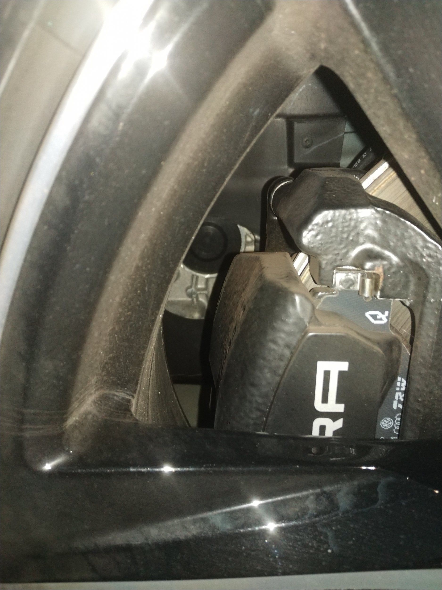

But if you look at the other pictures I attached, it seems like there would be enough clearance to fit a rim that is 1" smaller. I was definitely able to confirm, no snow chains possible on this car. One tire seller offered me the exact rims I have and a set of Continental Winters for just over 2000 euro. That seems ridiculous to get the exact rims I already have.

Those are the standard brakes, not the Brembo ones, so your front discs will be 340 mm diameter.

Definitely, lots of people have fitted 18" wheels to Cupras. You can see in the pictures that there's easily 1/2" of clearance. That's the size I would choose for winter tyres.

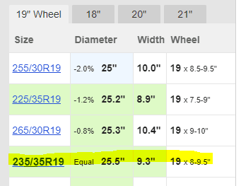

I was hoping to actually go for the 235/40/18's but there is a report with the rims that show road suitability is only to 225/40/18 for the Cupra:
But then there are other VAG autos in the list that say 235/40/18s are allowed for use with the rim and the particular car:
I definitely don't want to run afoul of any laws in case the worst happens and someone is inspecting my car for improper parts later on down the road. I don't really get why the 235/40/18s wouldn't be approved as they are much closer to the size of 235/35/19s than the 225/40/18s are.

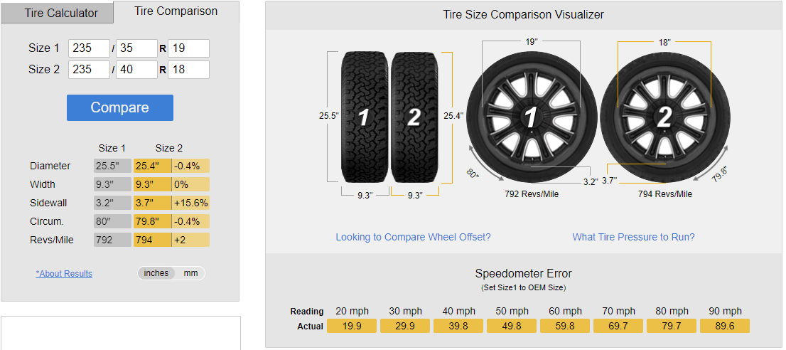

Seat use 225/40/18 tyres with 18" wheel. Normally the wheel will be 18" dia with 7.5 width. They then use the 225 width tyre to fit with it. That is there oem spec and have used it since the mk1 leon. The tyre is common size and easily available that fits to the wheel. Normally an 8" width wheel will use a 235 width tyre ie the 235/35/19. All the tyres and wheel sizes Seat use have an overall circumference that are identical or near identical.

225/40/18 on an 8J wheel shows no stretch, i run 225’s on 8J ET45 and imo it’s pretty spot on set up
on an A3 but is the same setup as a Leon
225’s are also much cheaper than 235’s
225/40/18 on an 8J wheel shows no stretch, ...
