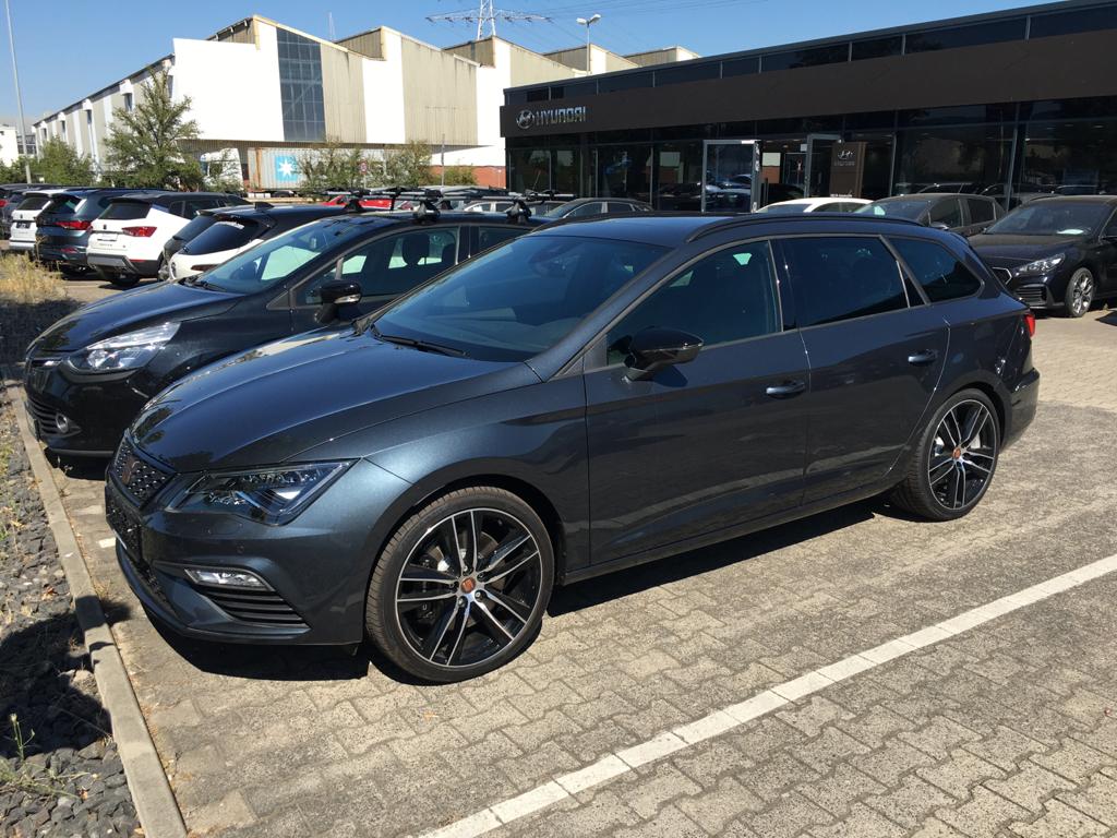

Hi all. New member here with a Mk3 Cupra ST 4 Drive. I need some winter tires here in Germany. I am trying to decide between the following options:
1. All season tires in 235/35/ R19 and not worry about changing out twice a year.
2. Winter set of stock size 235/35 R19 tires only.
3. Complete tire rim set of 235/35 R19.
4. Complete tire rim set of 225 or 235/40R18.
I am trying to figure out, if I go for a whole new set of rims, what are the offset of the stock rims and if I get something with the same offset will it match pretty closely the look of what I have on there now? I am not sure if it matters which rims I have (I think the car comes with different options?) but I attached a picture of what is on there now, for reference.
Expected driving during the cold parts of the year is mostly central Germany (not much snow) with trips to Berlin (and other northern places) and occasional trips down south during the winter for skiing. Any insights or recommendations regarding tire size, types, performance, etc for this car are welcome. Thanks for any help here.

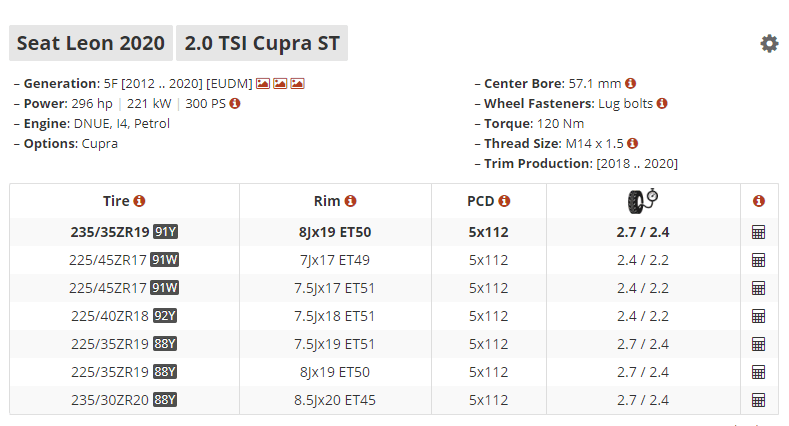

The OEM sizes for 18” wheel / rim combinations are:
225/40/R18 Tyre. As it’s a Cupra estate in Germany and likely to be on Autobahns, I would look for an XL load rating (to carry load in boot/roof boxes etc if skiing) and at least a V speed rating (as a rule of thumb the XL load rated tyres normally have thicker sidewalls and are normally V+ rated).
The wheels will be 7.5 J x 18, with a 112 x 5 PCD, 57.1 mm centre bore and ET51.

You can check the different sizes via websites such as willtheyfit.com
Results for the two sizes that I quoted are here:
The 18” sizes are those fitted as standard for the MQB range of cars - A3, Golf, Octavia, Leon.
7.5 J rims will take a minimum size of 205 mm width tyres, but ideal sizes are 215 mm or 225 mm.

Thanks again for the info. I verified the tire/rim sizes you gave at wheel-size.com (duh! to me) as well,

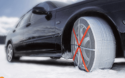

In terms of the snow-socks, there are mixed reviews for these, and they are not considered an alternative for chains in alpine regions.
