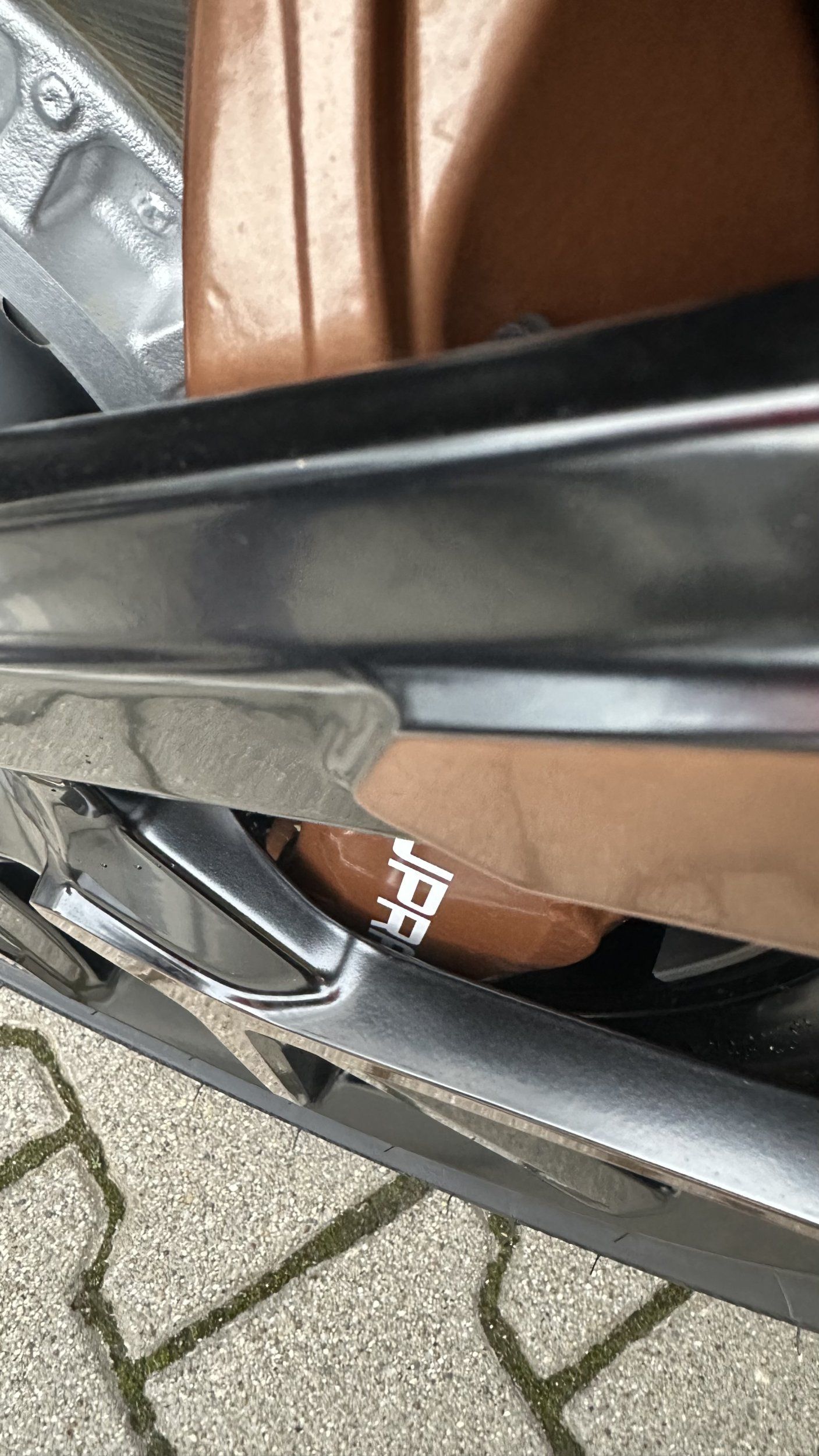

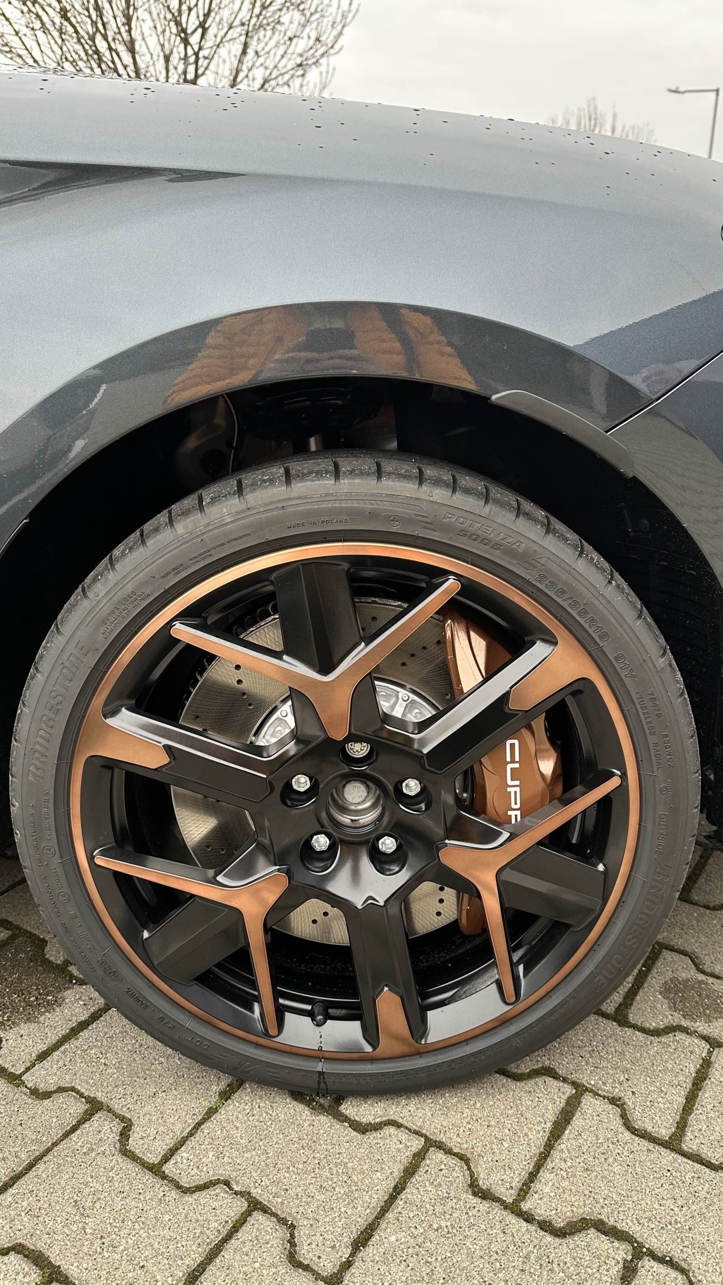

nah, I am looking for 19", there is no way a 18" can clear the akebonos.
edit: the problem with Felgenoutlet and with every other wheel-database is the akebono clearance... you can't filter for that and literally no information is available. EG: I have no idea if I go with a 8x19 ET35 wheel, to help clearing the brake, then what happens with the wheel arch fitment?
