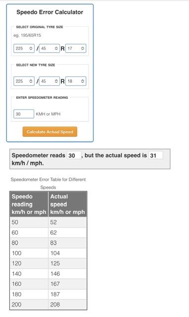

2nd question. Tyre sizing. Is there something in particular I should be considering here? I've used www.tyresizecalculator.com and think that a set of 225x45 should work fine and are a little more budget friendly that a set of 235x50's.

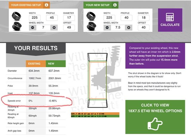

One important consideration when changing wheel / tyre size is to ensure the overall rolling radius of the new wheel / tyre set up is as close as possible to the original wheel / tyre set up, so your car’s speedometer reading remains accurate. It’s important to ensure that the speedometer doesn’t display a lower speed than the actual vehicle speed, otherwise the driver could unknowingly exceed any applicable speed limits. With your suggested tyre size of 225/45 R18 for your new wheels, your car’s speedo would under-read by around 4% so at an indicated 100 kph you’d actually be travelling at 104 kph which IMHO is too large a margin of error- see screenshot below;

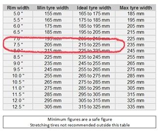

I think that the size of tyres that Seat fitted to mk3 Leon FR’s with 18“ wheels are 225/40 R18. According to the table below, this is the ideal tyre width for a 7.5J wheel and would be the size I’d choose for your new wheels.

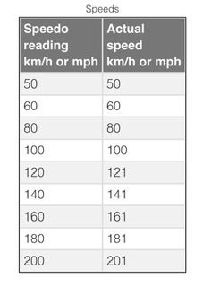

Although your speedometer would be understating the actual speed with 225/40 R18 tyres, the margin of error is less than 0.5%; see screen shots below;

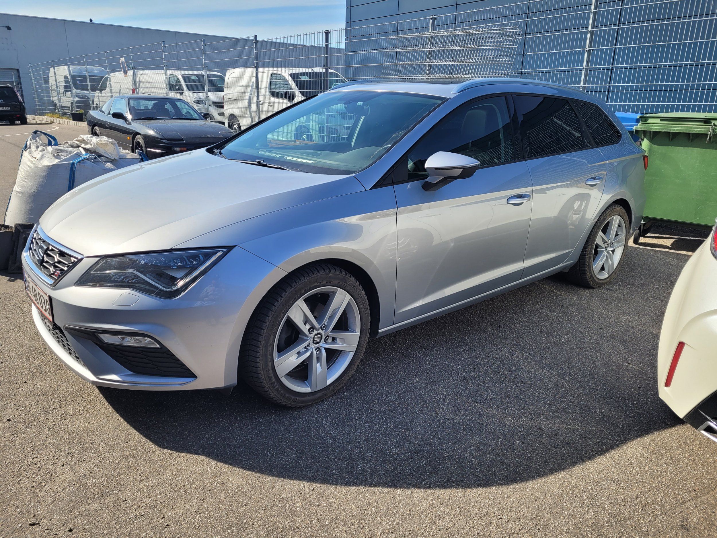

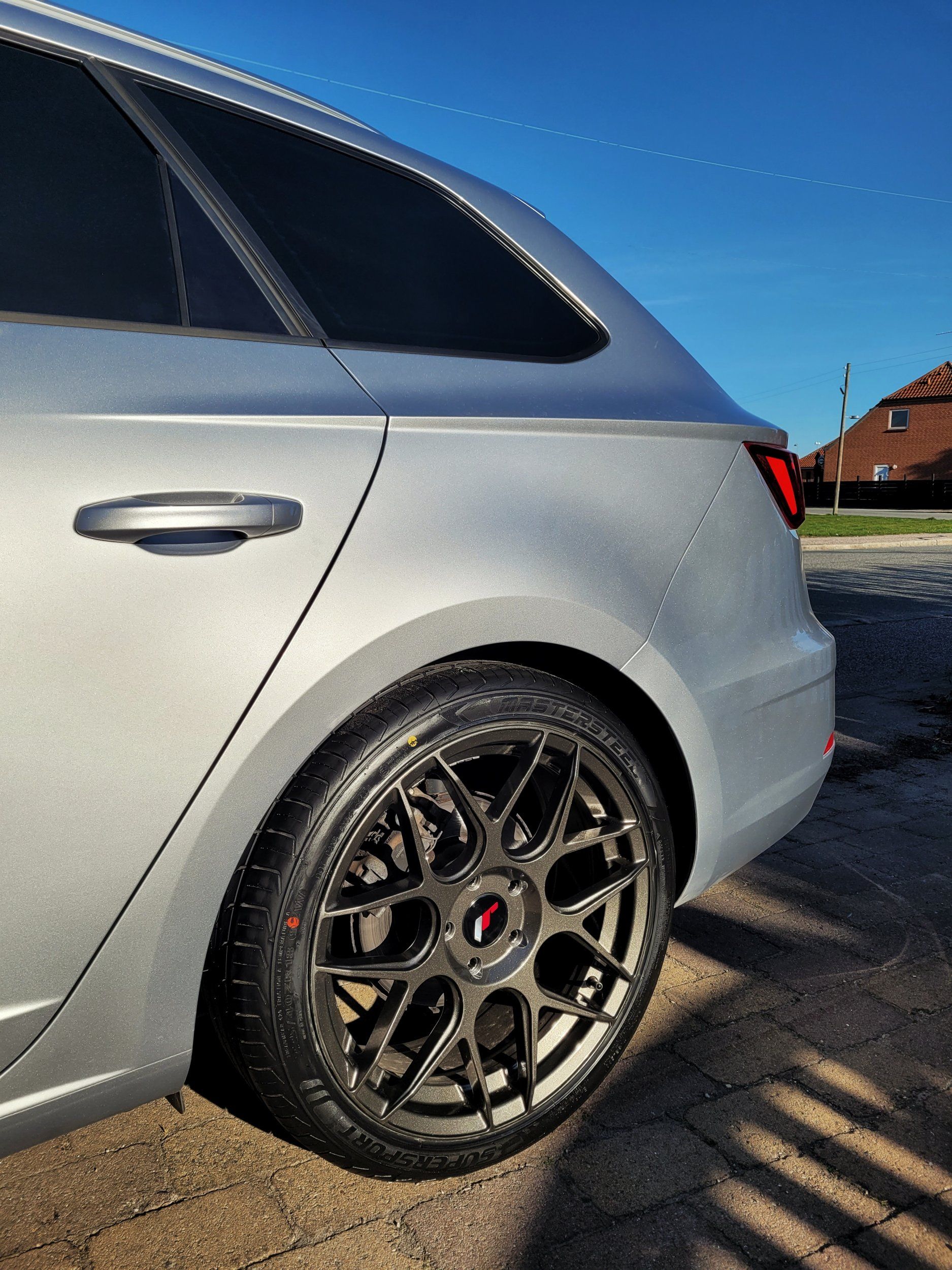

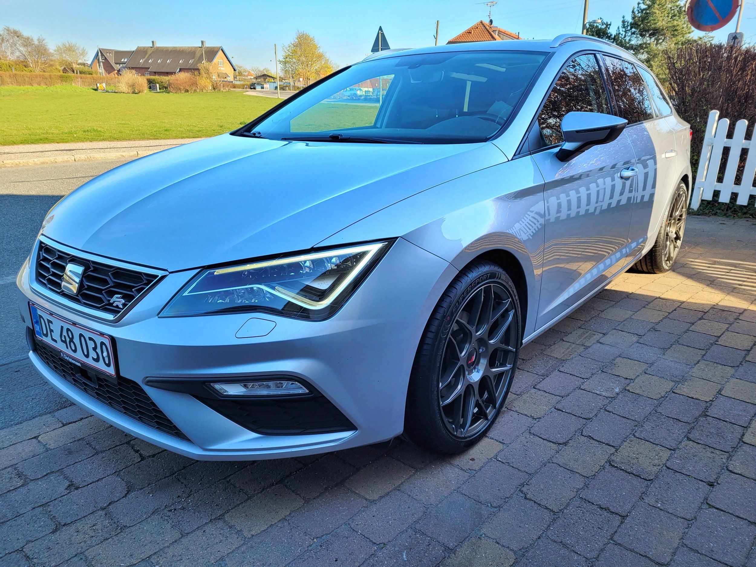

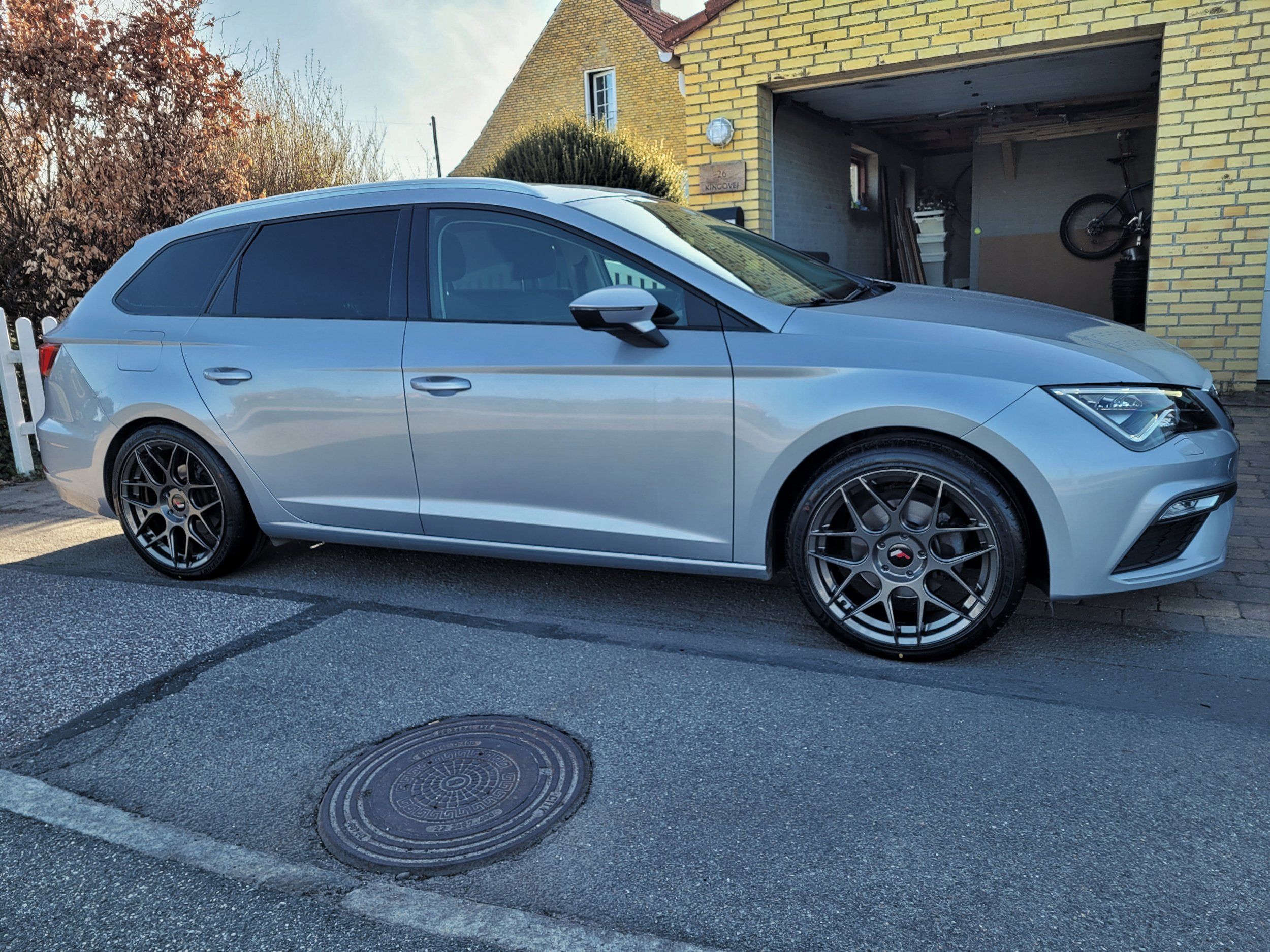

Time for an update. After so many of you helping me out, the least I can do is put some photos up (technology, don't fail me now!). Ended up getting a great deal on these, but with an ET35 all round inseatd of getting ET40's for the front. Everything lines up well (might opt for some 5mm spacers on the rear) and although it was a tough decision on colour, this is what I went for. Not everyone's cuppa tea I'm sure, but each to their own!
Thanks again for some cracking advice and no doubt, I'll be back again with more questions as the journey continues!
(first image is with standard OEM Seat rims with winter tyres running 15/20mm spacers)
And now...Japan Racing JR18 7.5Jx18 ET35 in hyper grey.
