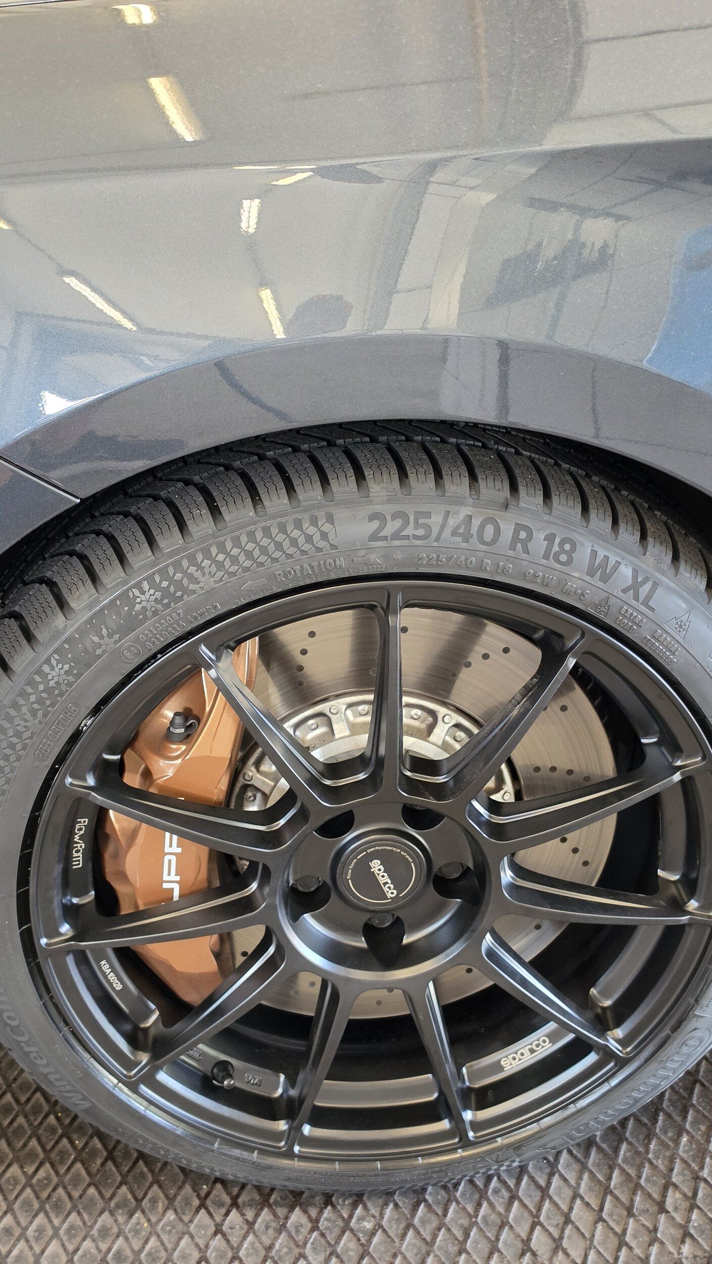

I've got some Team Dynamics Pro Race LT 19" 5x112 8.5J ET 35 on my Ateca VZ3 with Brembo big brakes.
They give excellent clearance to disc and callipers and replace OE Copper 19" 5x112 8J ET45 .
Bought them, with tyres, from Rimstyle who have an excellent configurator, and 0% finance available.
