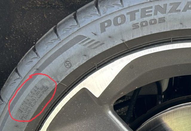

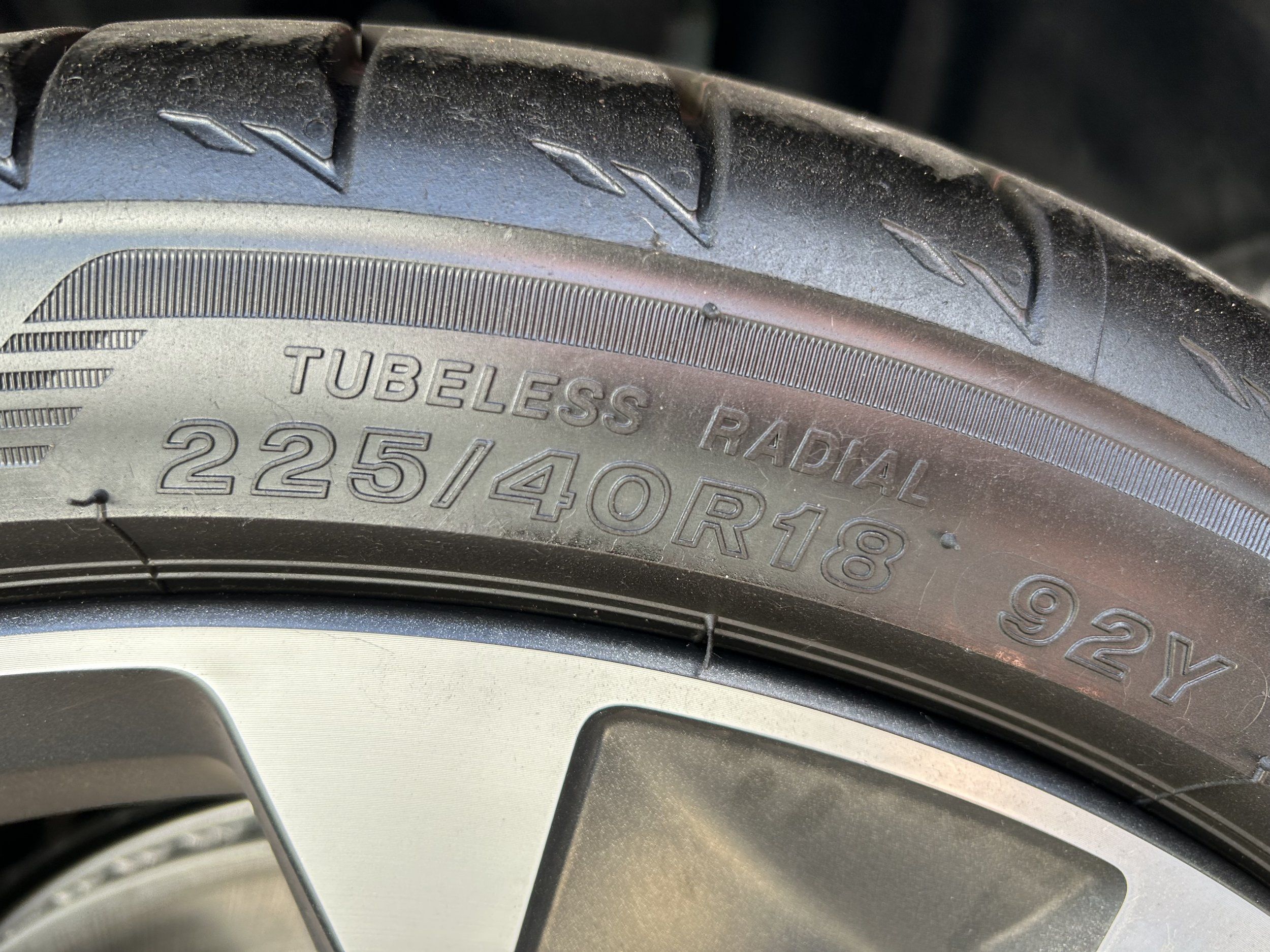

You confirmed in the other discussion thread you started that the tyres on your Cupra are Bridgestones. All five of the VW’s I’ve owned came from the factory fitted with low profile Bridgestone tyres, and when I’ve had new tyres fitted - either by choice or out of necessity - I switched to an alternative brand (Goodyear, Continental or Michelin) and there’s been an improvement in ride quality over the Bridgestones. Historically, Bridgestone have tended to use quite a hard compound for their performance tyres, and when they’re low profile and are rated ‘XL’ (extra load = reinforced sidewalls) as yours are - see picture below from the other discussion thread - the ride will be firm to bordering on very firm.
