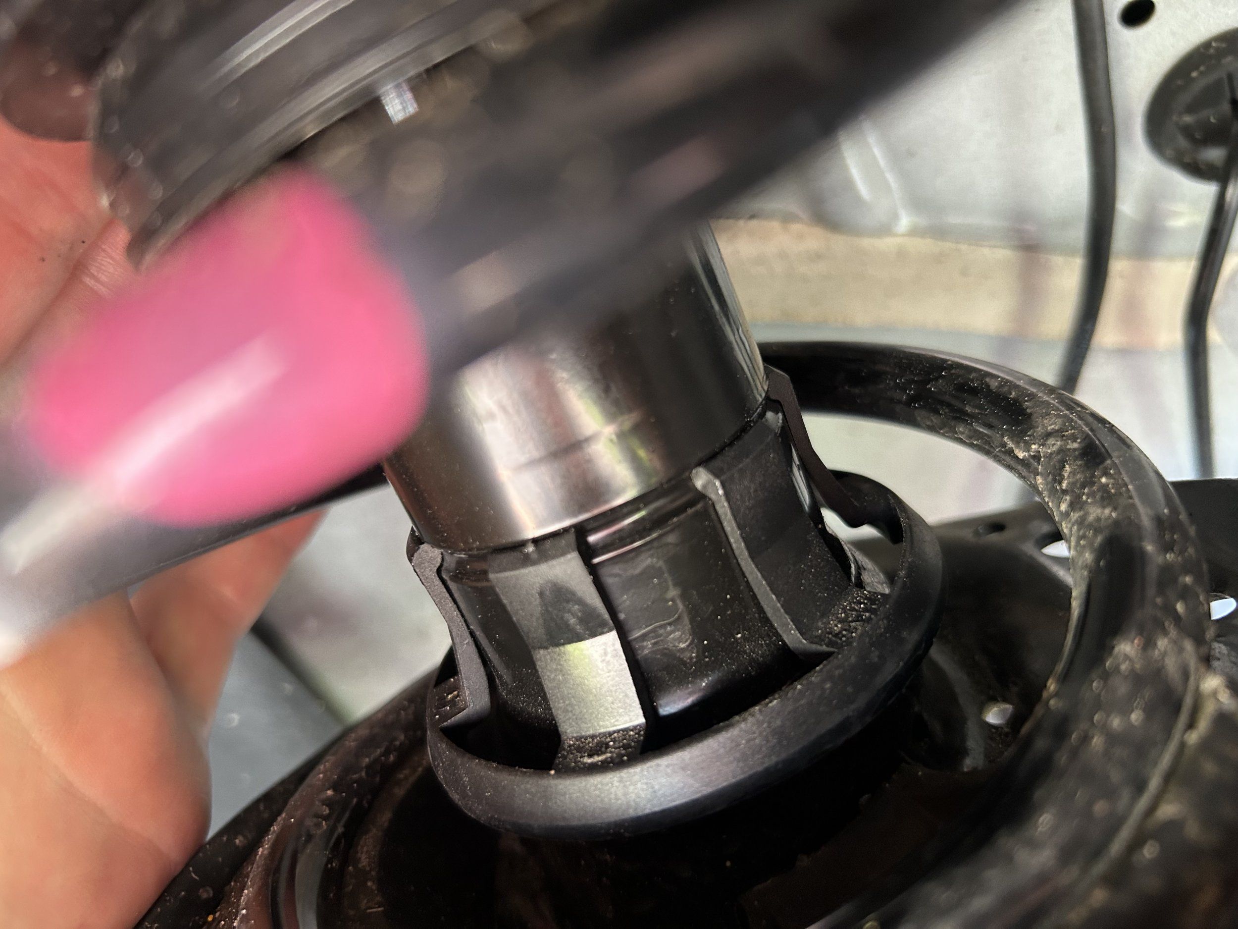

You sure that they removed the elements from suspension that are used during the transport from the factory? It can be recognized by looking at the height if the vehicle.

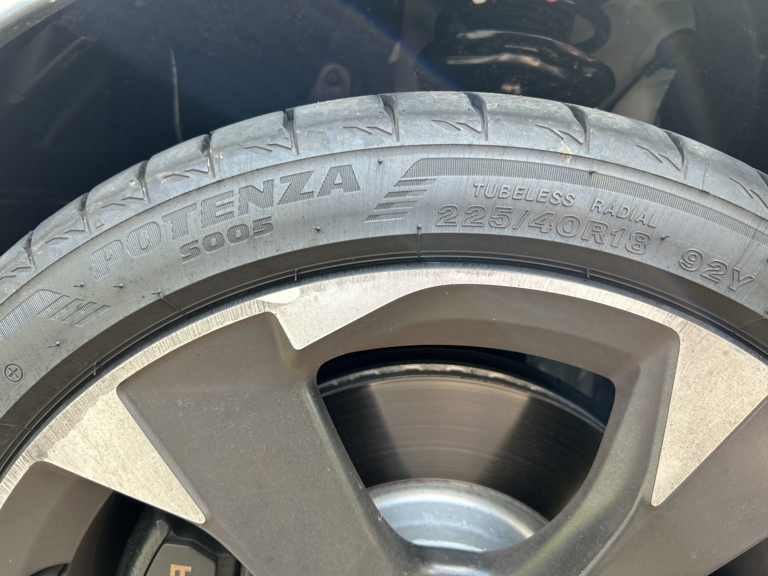

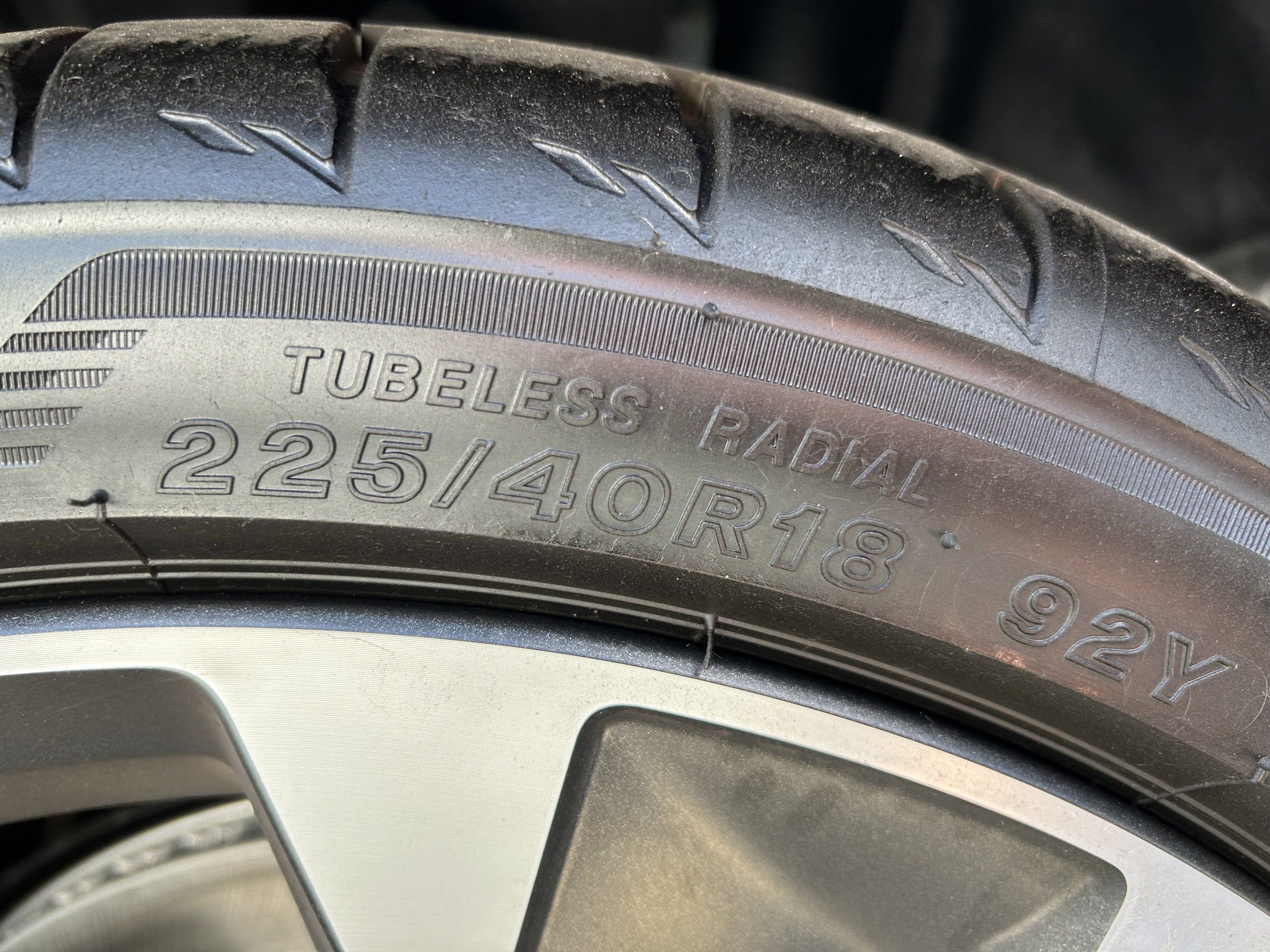

What brand of tyres are on your car? Tyre brand can be a significant factor in ride comfort. Bridgestones certainly used to be - and may still be - the tyre of choice in 225/40 R18 size for some VAG performance models (e.g. VW Golf GTI and Polo GTI) with 18” alloys, and they tend to have pretty stiff sidewalls that translate into a firm ride that some owners may find uncomfortable. Reducing the tyre pressures should help, although I don’t think I’d reduce by as much as 6 psi (I run the tyre pressures on my VW Polo GTI+ with 18” alloys at 3 psi less than VW’s recommended pressure).
Even if you don’t think the shipping pucks have been left in situ in error, it would still be worth checking to make sure they’ve been removed.

My car came with Bridgestones, but I changed my alloys shortly after getting the car and used that as an opportunity to change the tyres to Michelin PS4 which IMHO are a better tyre in pretty much all respects, and they give a more comfortable ride than the Bridgestones too.

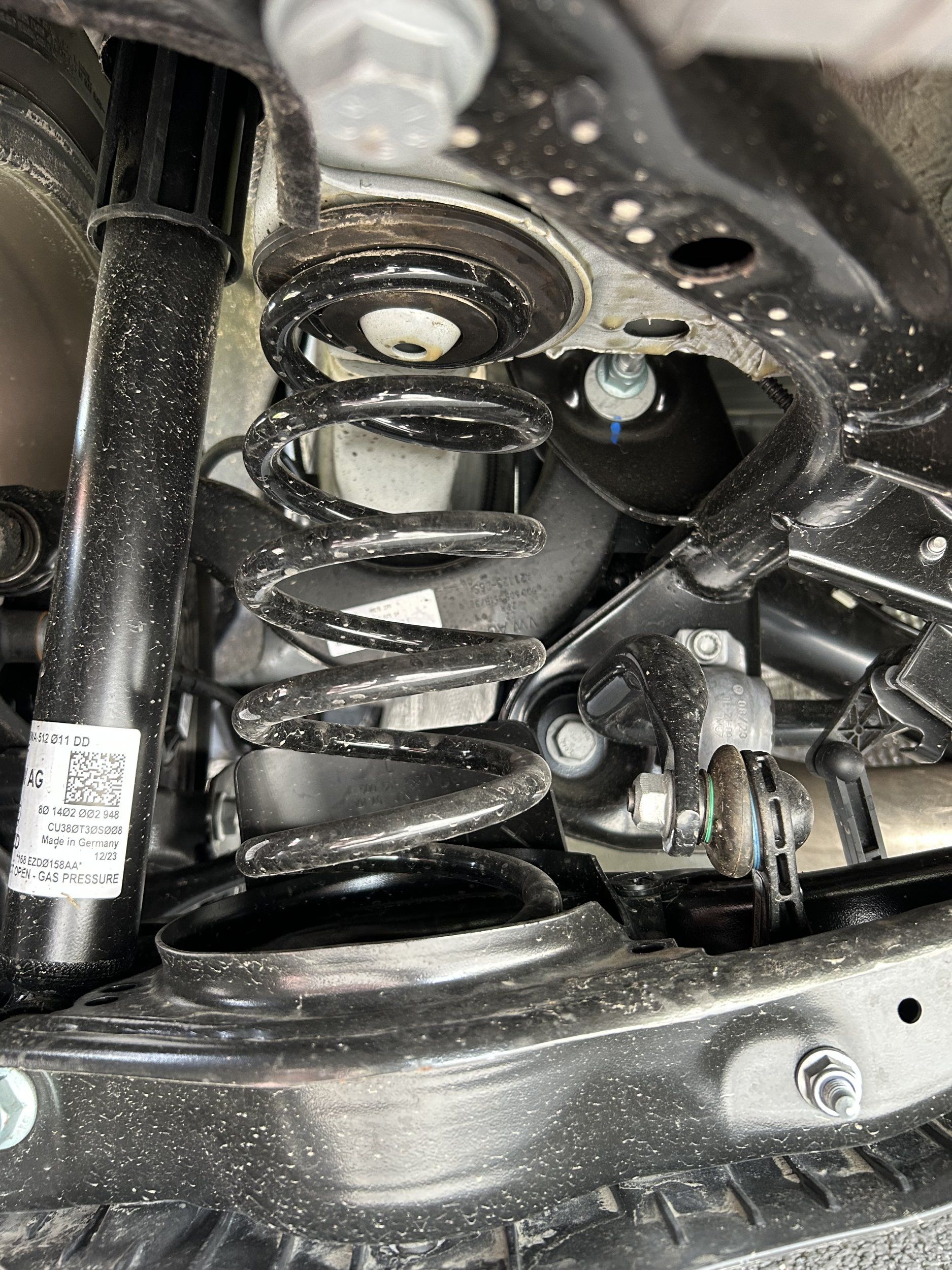

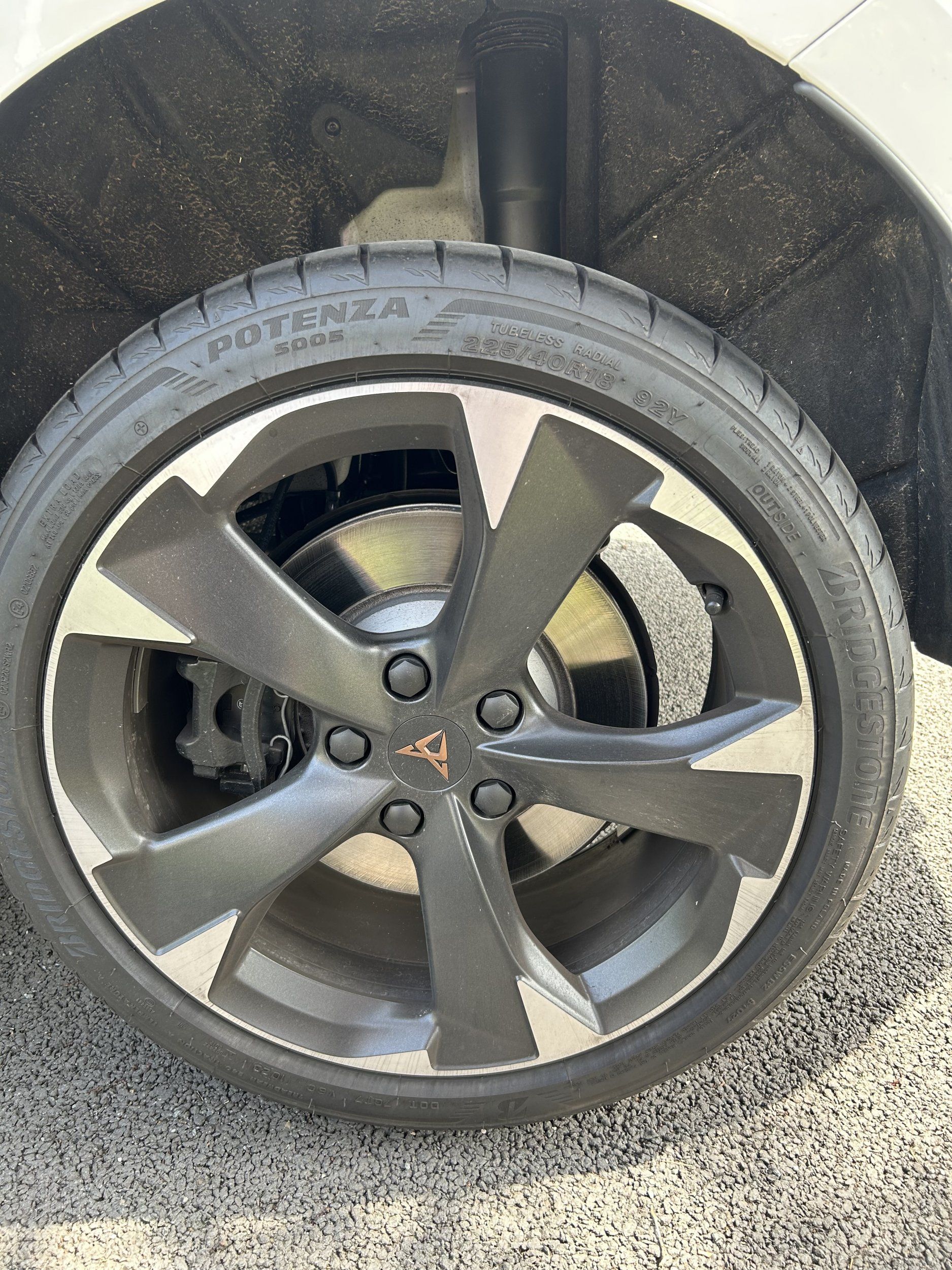

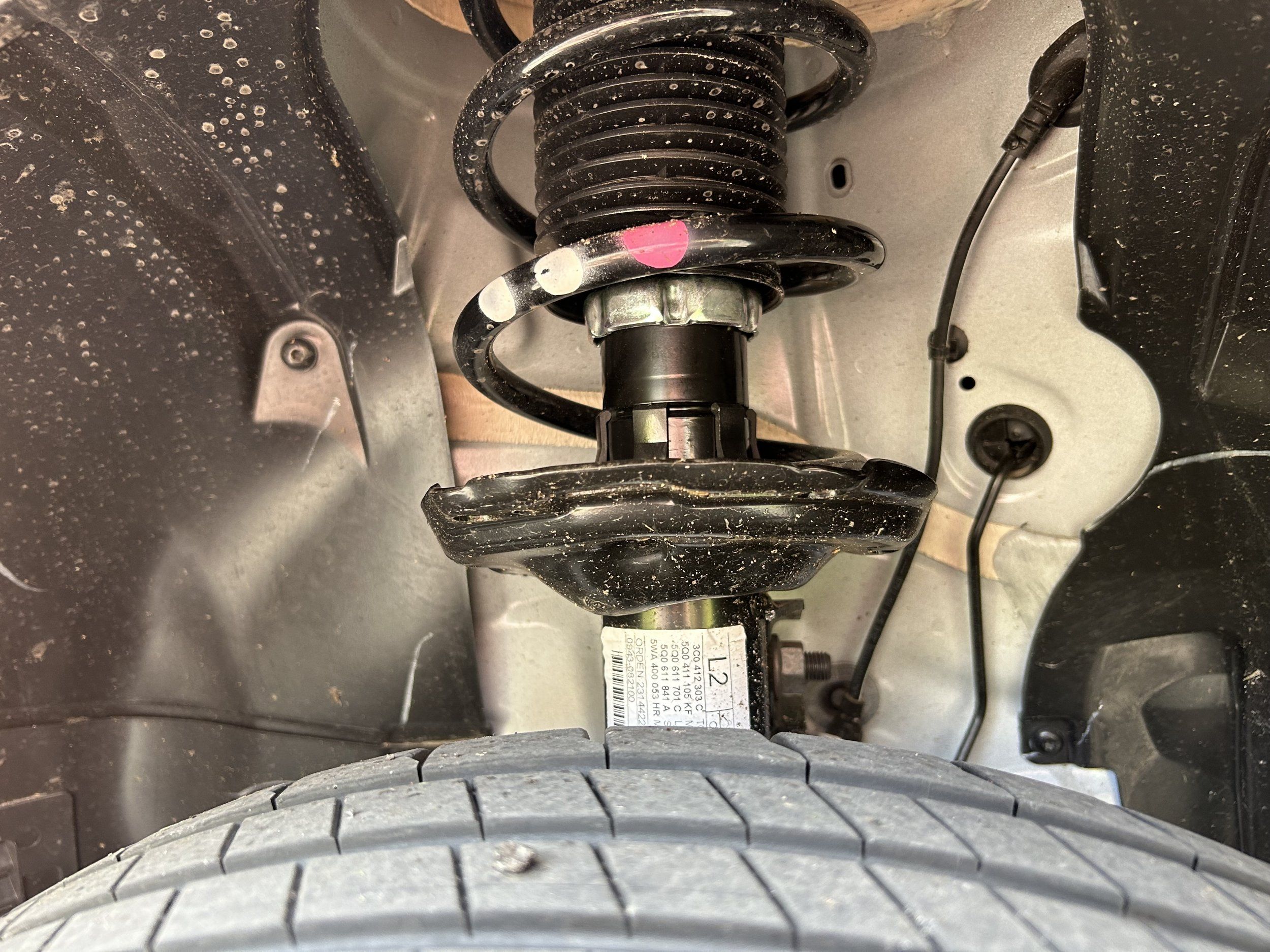

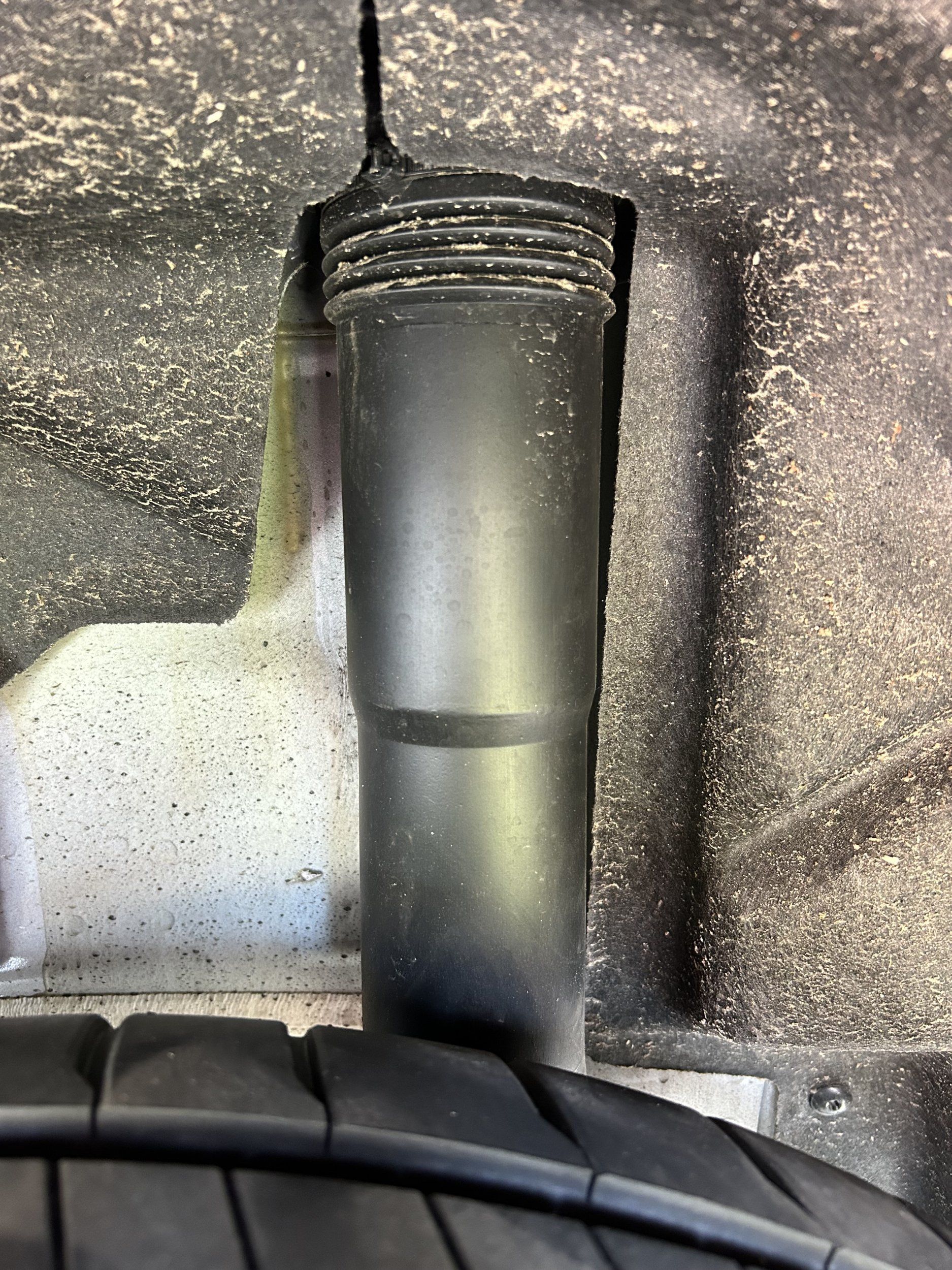

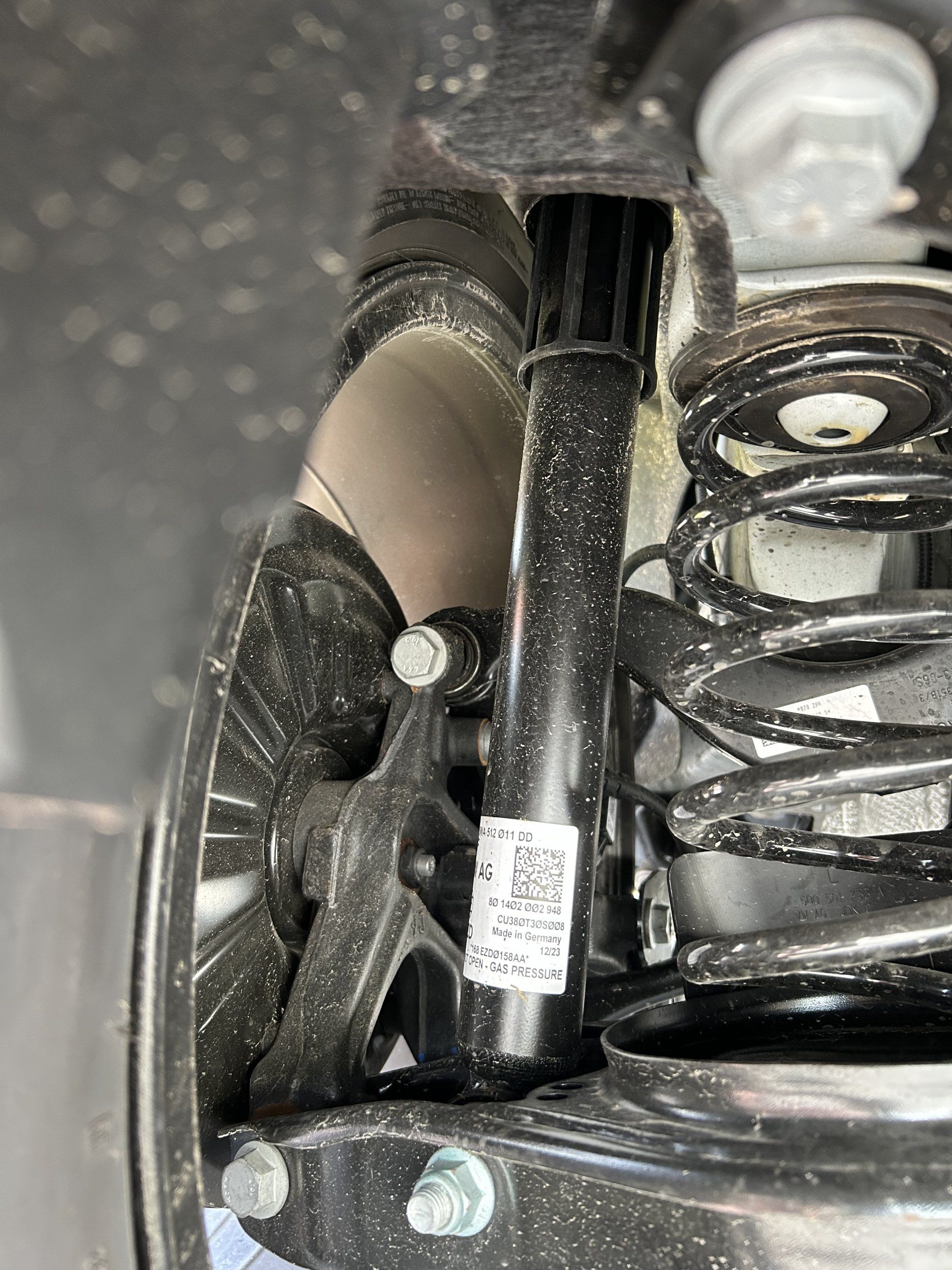

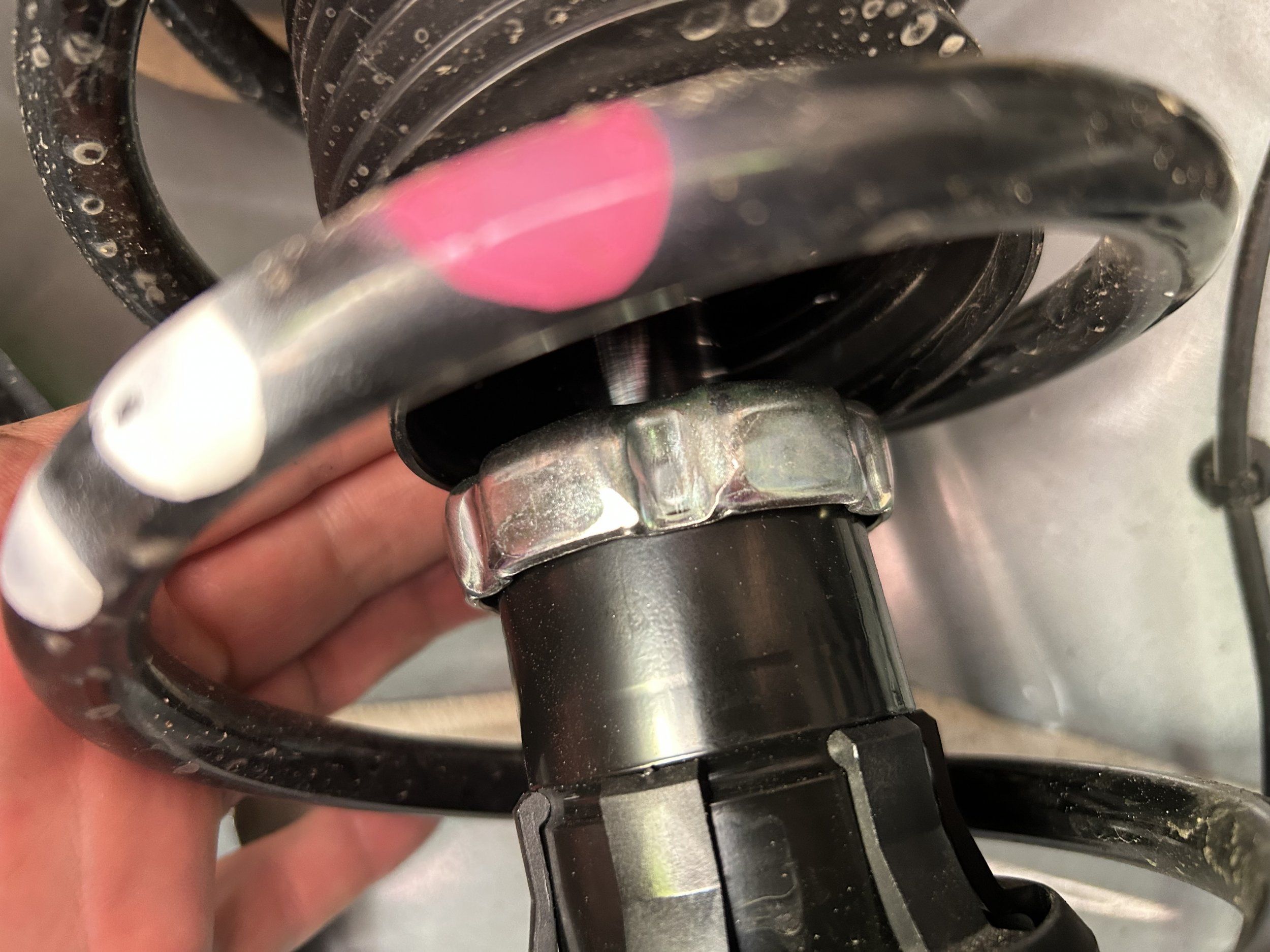

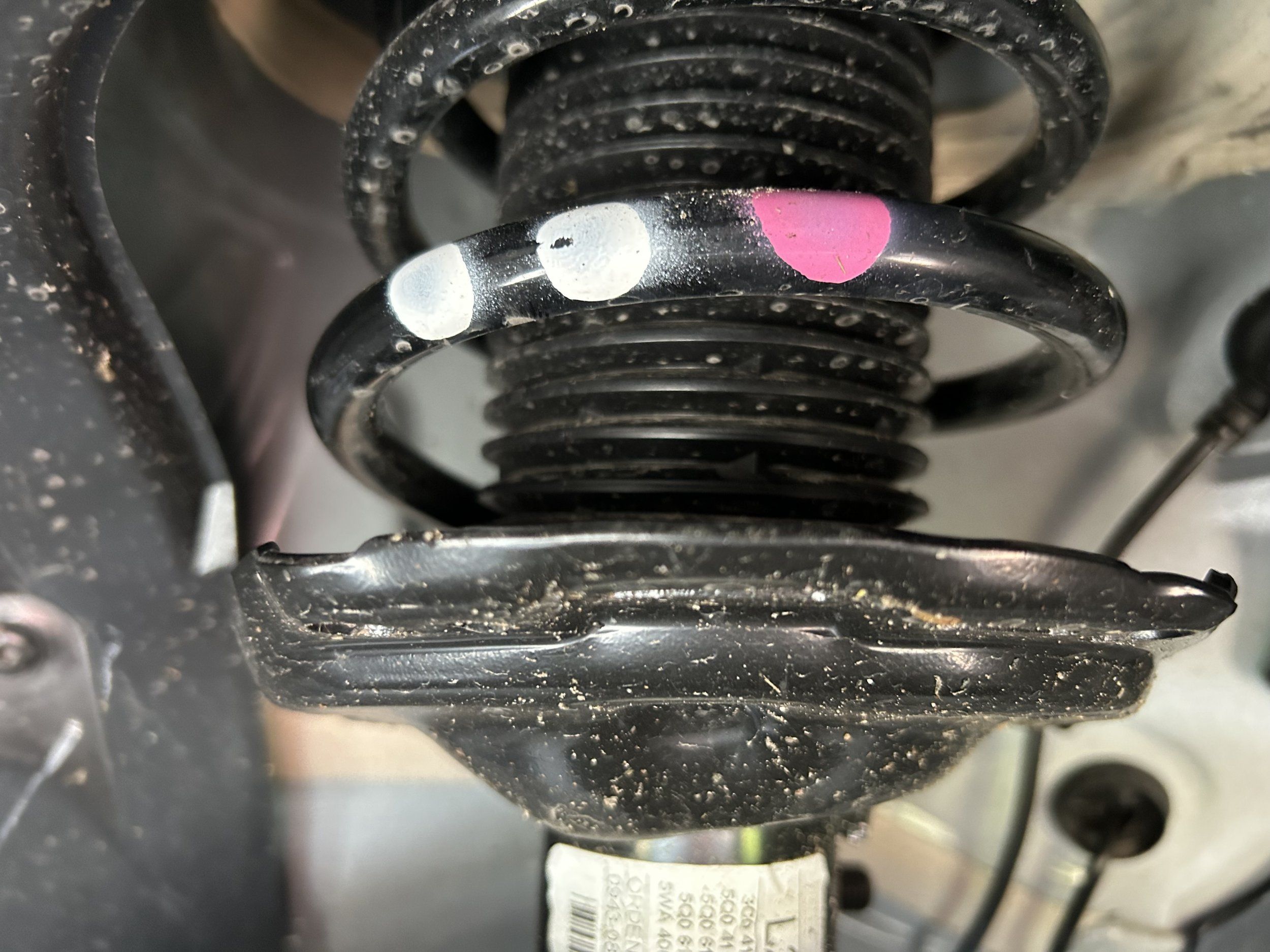

I just checked, no shipping pucks. Tyres are Bridgestone Potenza S005. Jacked up the back and front some pics…. I’ll try lower tyre pressures to see if that helps a bit..

Have a read of the discussion thread at the link below. I also posted a link to the Golf GTI forum in post #2 of that discussion thread that shows the location of the shipping pucks on the front suspension struts (they’re only fitted to the front struts during transit from the factory). The tell-tale sign if they’ve been left in place in error is the high ride height at the front on the car.
Thanks for the pointer! I checked my car, and I actually have the rear suspensions higher than the front ones.. so I am assuming it's all how it should be?
