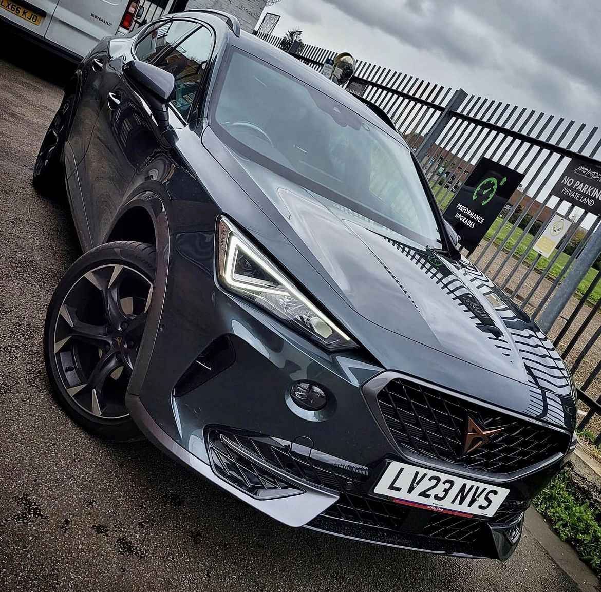

I own a Formentor V2 1.5 TSI DSG with no DCC in the UK for 8 months already, absolutely love it. I passed from Merc C class. Since Formentor's has a great handling, car feels me a bit stiff and firm especially after the C class. Motorway rides are absolutely fine but I cannot find the comfort at all in the city rides. Yes, London roads are awful unfortunately.
My aim is improving the ride comfort by chaning some suspension elements. I recently talked to a garage nearby and they suggested me to change both coil overs and dampers. Wondering should I really need to change the dampers? Would coil over replacement with a softer ones can improve the ride quality and comfort all alone? If yes, which brand and model would you folks suggest me?

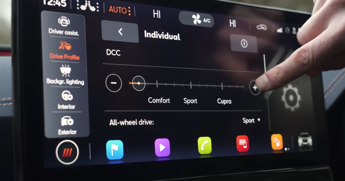

DCC has a great range of adjustment, 15 of them, it even has a super soft, but yes since we are on 19 inch/40 you cannnot expect miracles. This s a sport car and suspension has to be firm no matter what. Coilovers could be a solution, will not be less firm but will be more absorbant as they dont bottom out and the firmness does not transfer as much in to the chassis. But has to be a good coilover, not a budget one.Having a Bilstein and a KW in my 2 Corrados, the KW is a better one, more refined.
