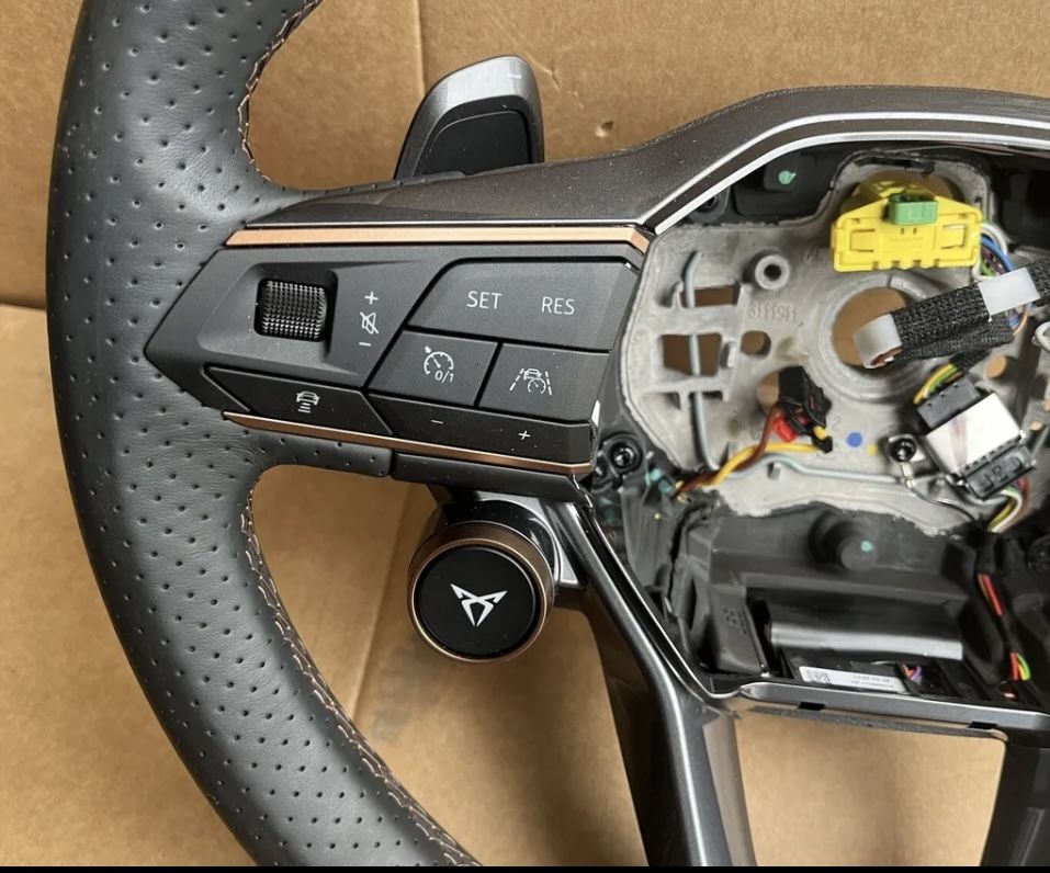

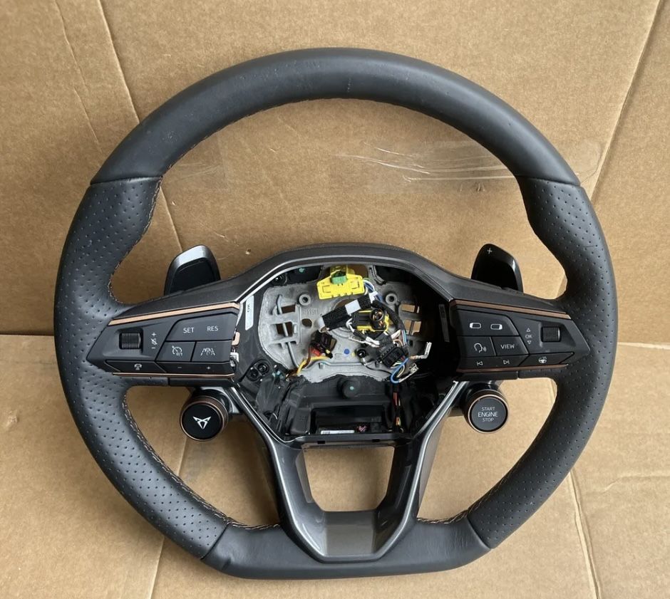

Apologies, I’m thinking of the 5f. You could retrofit something like this with the mode button.

FYI replacing the steering wheel is just the beginning. For sure the airbag loom and airbag slip ring needs to be changed, but other parts might also need to be replaced or flashed (especially GW)
