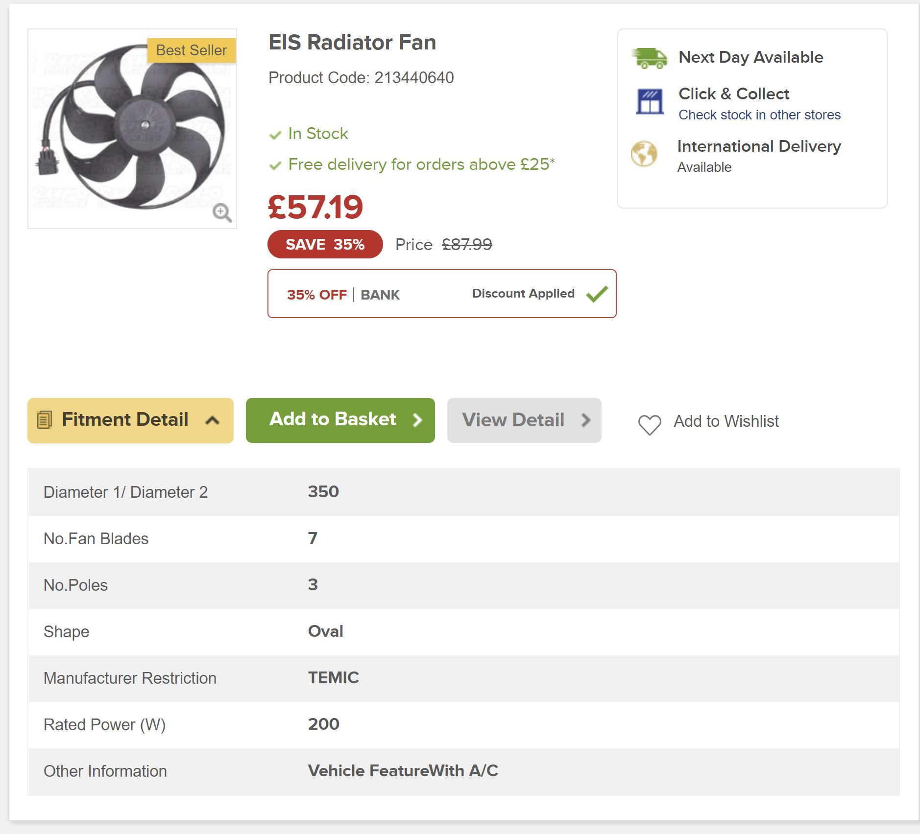

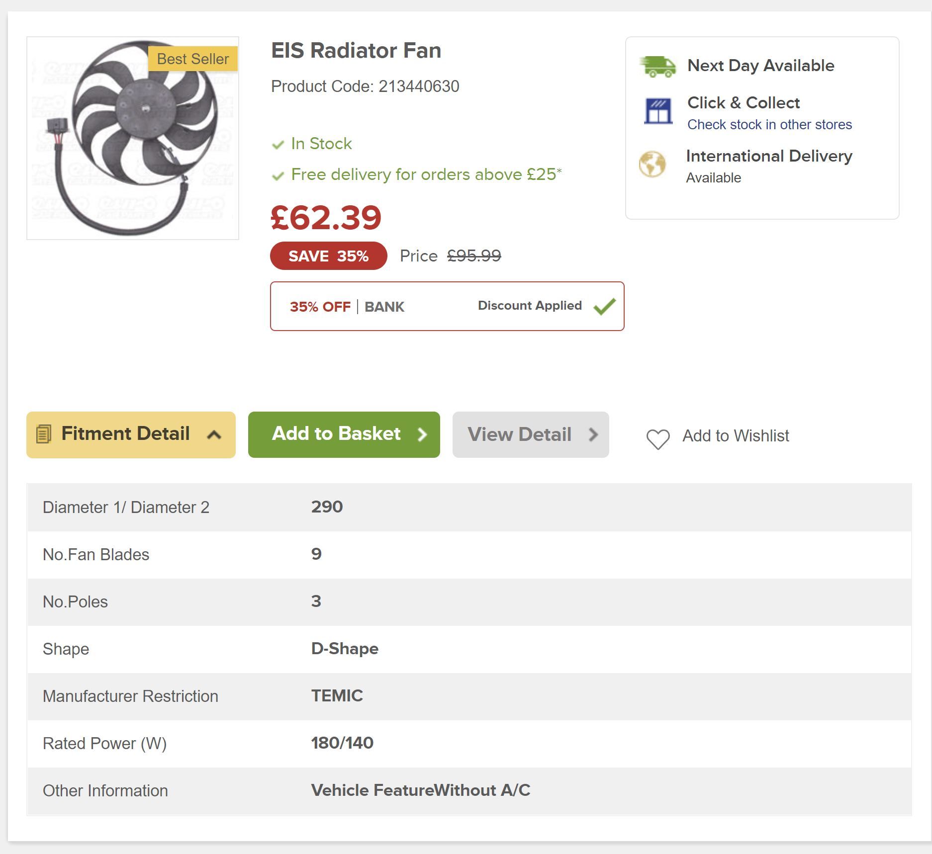

Looking on Euro Car Parts they have 2 fans listed, which im presuming is the large and small fan. However the small one states in the description "for without ac". Can anyone confirm these are the correct fans? Pics below of each item.
I assume you fitted fans in the end? Could you confirm the euros part numbers if you still have the paperwork??
