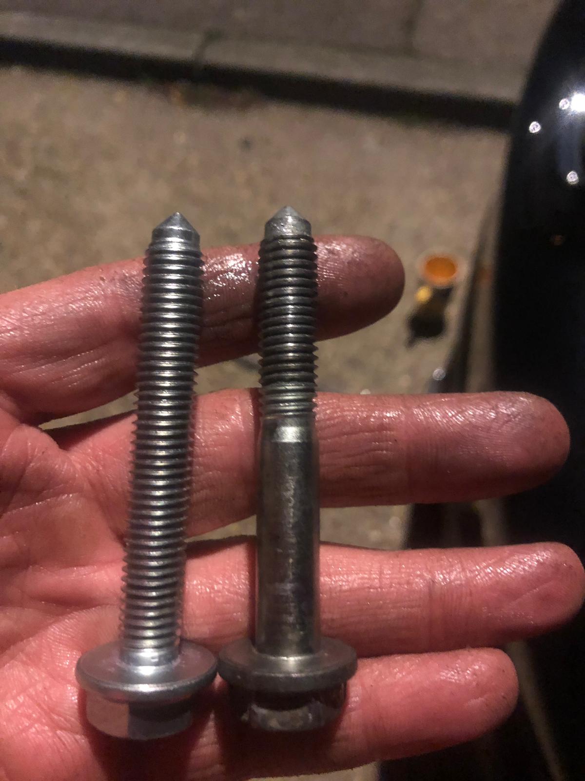

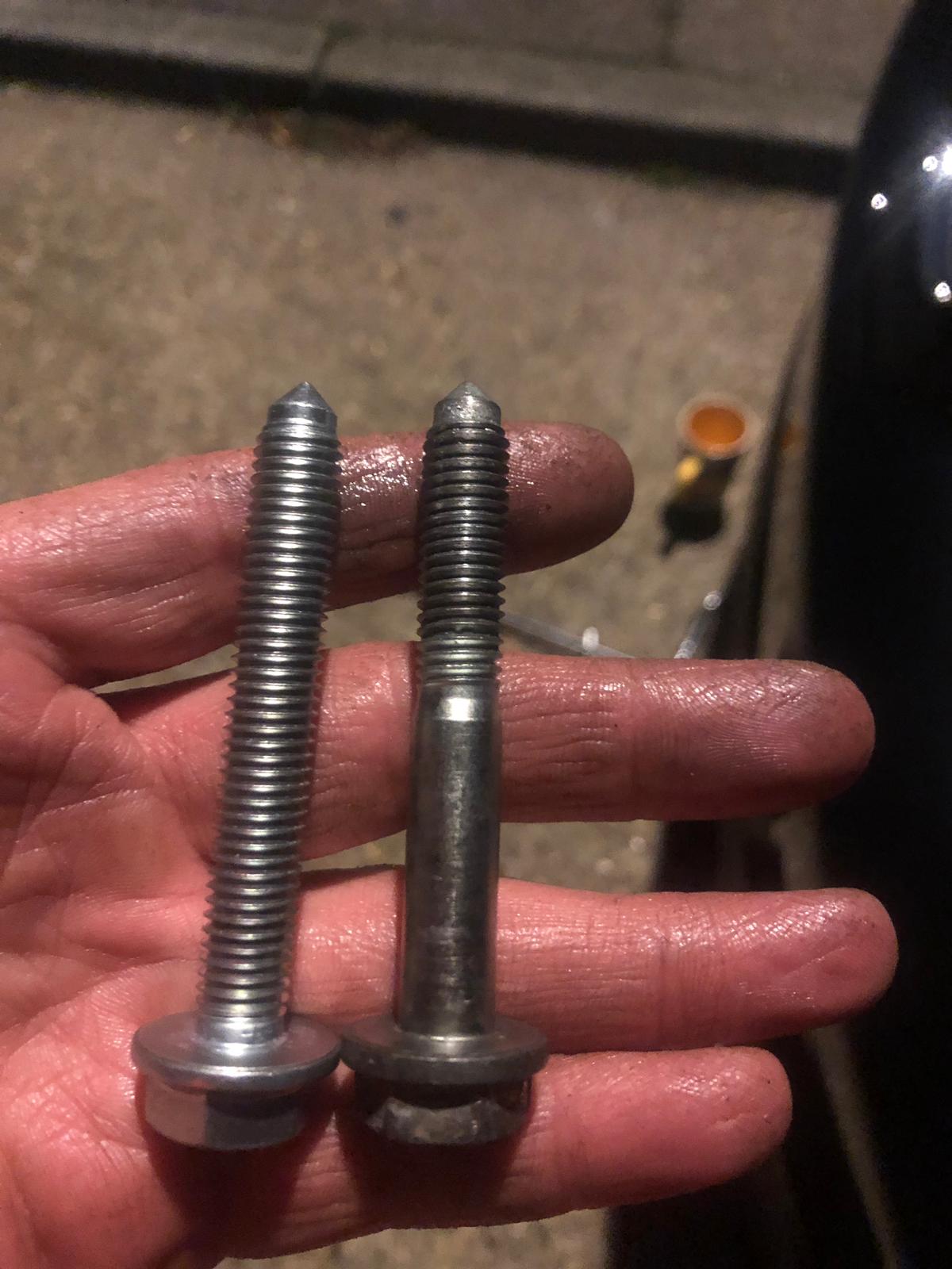

What are you're thoughts on these bolts I have got from stealers to replace them with. They don't have the collar at the top. Just thread all the way. Are these going to be OK? Isit just cost cutting from vag? Or is there a different part number for the collared bolts
