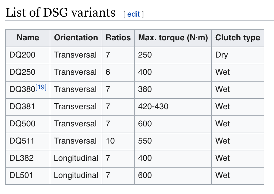

@RacerBice it depends on which 7 Speed DSG Box you are comparing it against.
The DQ200 as fitted to the lower power cars had a very bad start in life but they (VAG) think they have it sorted now - never heard that before.
I think its the DQ381 That is now fitted to the Cupra so a different box altogether.
Personally I have had feedback from Golf R Types who say they preferred the DQ250 (Which is what i have and very happy with) but as with cars its all about personal preferences (as others have said they love the 7 speed very much).
UPDATE to put all the info in one place
Thanks to R@Doo https://forums.seatcupra.net/index....upra-how-is-the-dsg7-box.447495/#post-4811243
Based on the info available at seat.com about DQ381and info found in an older Leon brochure about DQ250 ratios, I put together the following table:
index.php
It shows that gears I-III are very close (with DQ381 being just a little bit shorter) and gears IV-VI are identical. I was quite surprised by that, I was expecting DQ381 to be shorter for gears I-VI, with VII being a little above VI from DQ250...
The speed for 7th gear 1000rpm is 55.9/1.609=34.7 mph, which is in line with the value given two posts above.
