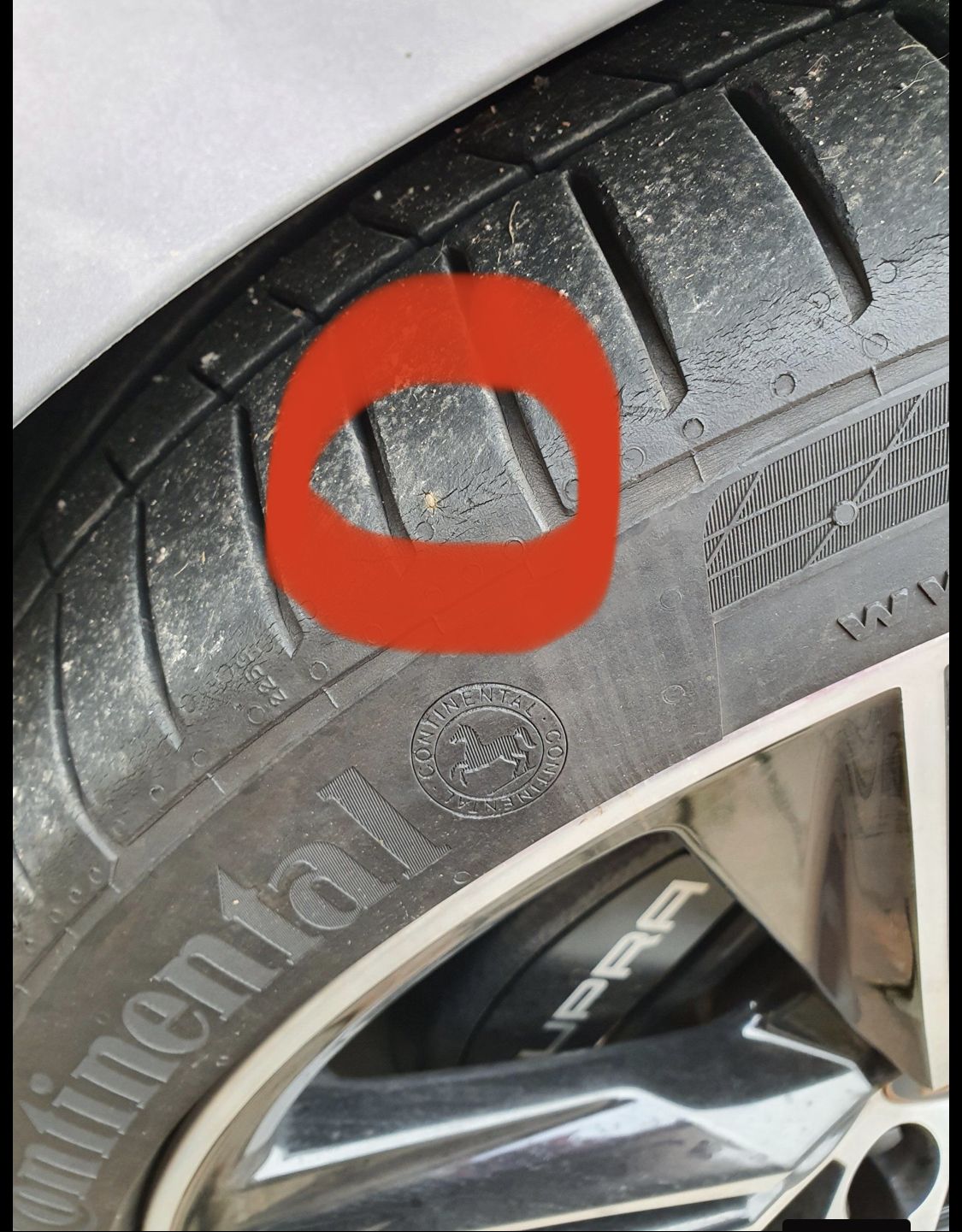

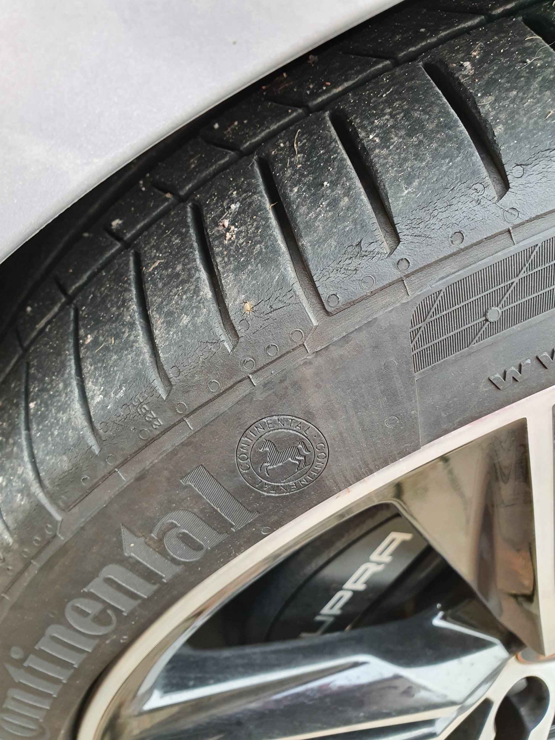

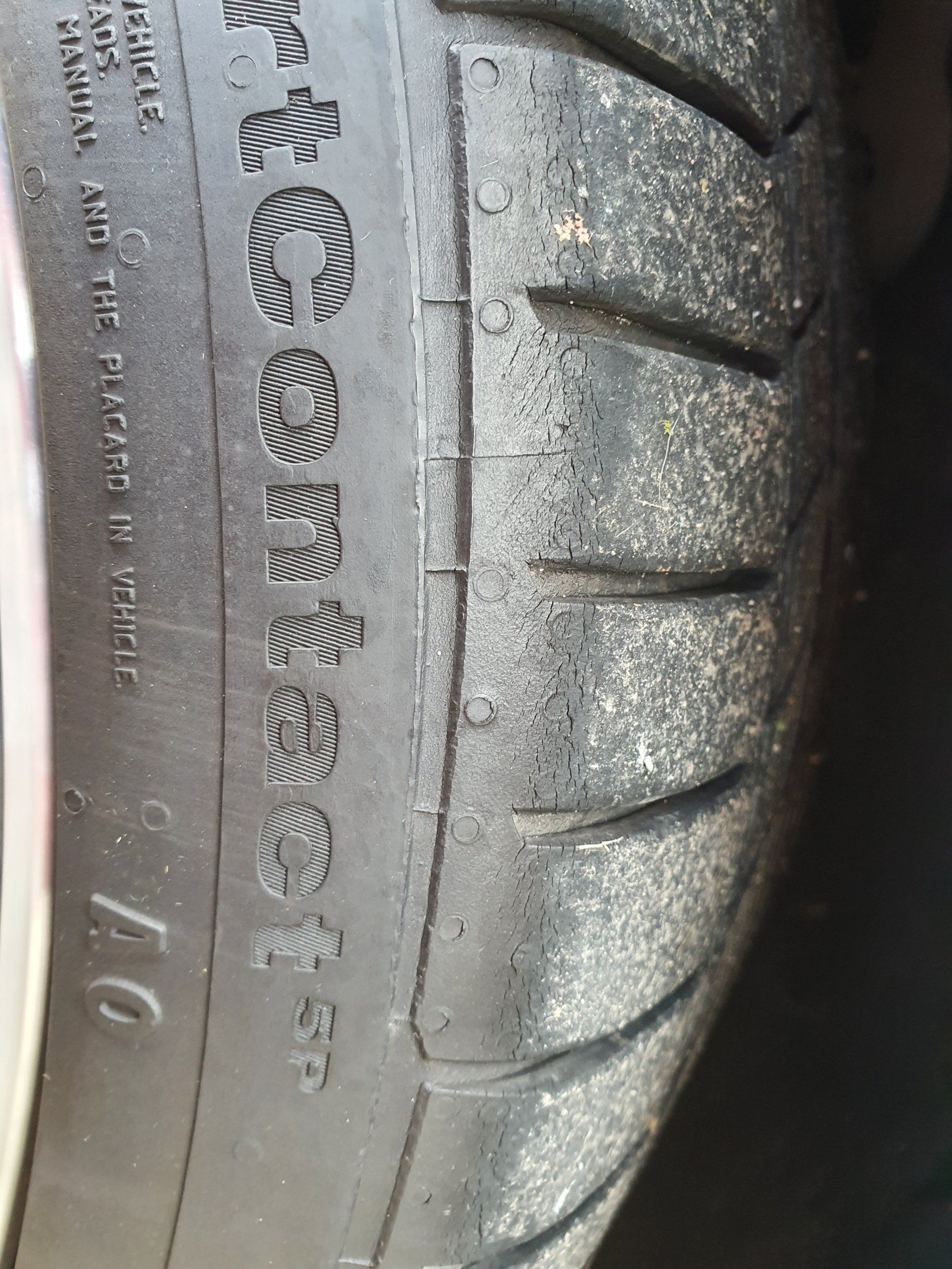

I have a Leon Cupra which I leased since new in Sept 2019. With the current Covid situation and working from home the car hasn't been used that much in the past 10 months. Current mileage is 3500.
Last week when I was cleaning the car I spotted cracking in the shoulder/sidewall of the front tyres. Tyres are Continental ContiSport Contact 5P. Not really sure how this has happened, I check the pressures every 2-3 weeks and I don't use any harsh wheel/tyre cleaners.
I contacted Continental, they asked for photos which I provided and they came back and said that it's just 'cosmetic' cracking/crazing and doesn't affect the performance or safety of the tyre. They gave the below reason in part of their response...
"Areas which can be included are rising ozone levels, poor tyre inflation pressure maintenance or frequent overloading. Tyres that are used infrequently or in applications that result in only very short, low speed journeys do appear to be more susceptible to this condition".
They did state if I was not happy that I could send them to Continental for investigation through a tyre dealer. The only problm with this is I have to buy 2 temporary tyres, if they find no manufacturing fault not only will I lose money on the temporary tyres but have to pay to have the original tyres returned to me.
Do I just leave it?

If you have written evidence from the manufacturer, then I would suggest that they are more qualified than most on here.
You might want to investigate what appears to be a nail in your tyre though. If this has penetrated the tyre to cause a puncture, it will take one of the tyres out of the equation as you will not be able to repair due to the position.
The tyre wall is really thick and it’s on the highest part of the tread block so you may be lucky...

I spotted that, it was a tiny rock embedded into the tyre. We have some new houses being built on our estate and it's a right mess.

Take it for a blast that wil go, been stood too long, i wouldnt bother arguing with tyre guy for sake of a cuple tyres
Reactions: Rowan83
I certainly wouldn't be concerned over the cracking at all, think they all go like that with age. Think of all the flexing and shape changing they go through. Bound to create imperfections.
Sent from my VOG-L09 using Tapatalk
Reactions: Peller and Rowan83
Thanks for the responses everyone, think I will leave it for now. It is slightly annoying on fairly new tyres though.
Quite normal. You don't see it on most car tyres as they are being used a lot more than the current situation allows.
My other half has a horse box that gets used once a month and although the tyres are more or less brand new (c.200 miles on them) they do crack a bit due to UV light and just standing around.
Give the car some right foot TLC and I'm sure you'll scrub it off soon enough.

I know I said I thought this was a tiny stone but now I am not sure, struggling to remove it as it's embedded into the rubber. After scraping it looks like a piece of metal but looks to small to be a nail or anything? Just leave it?
