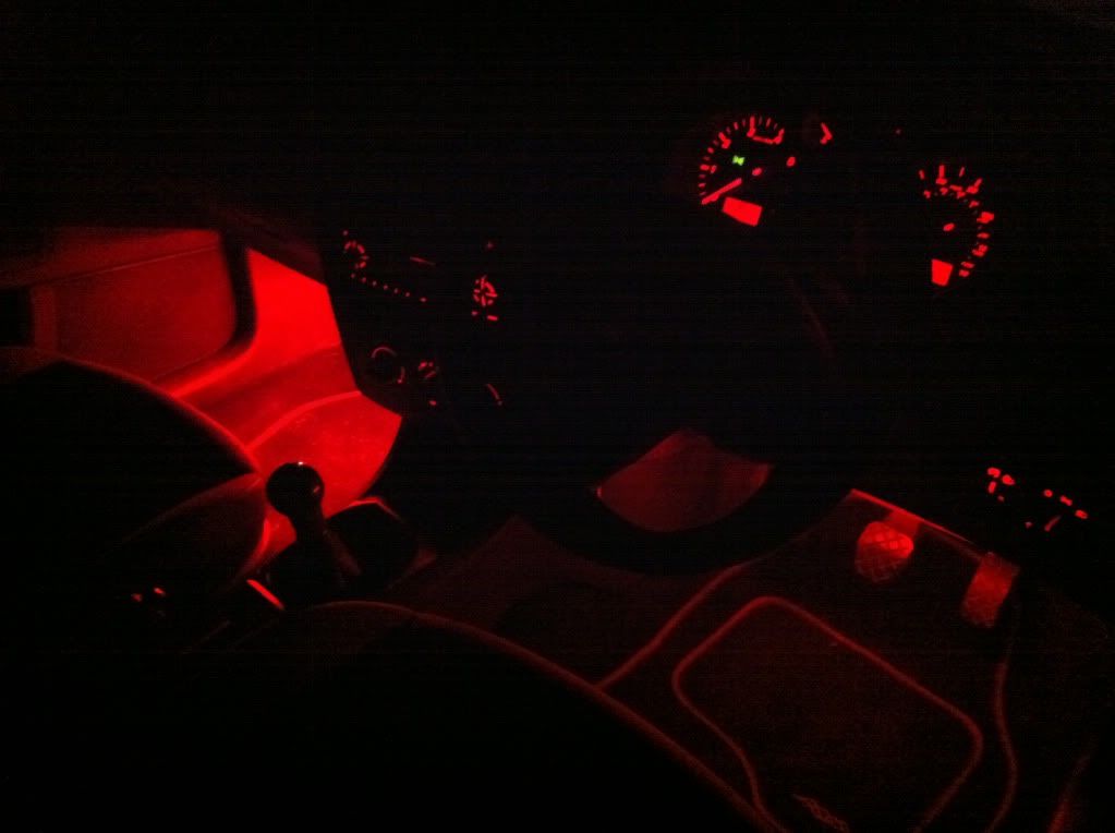

Footwell light sorry about the pic but still not sure wether to keep them

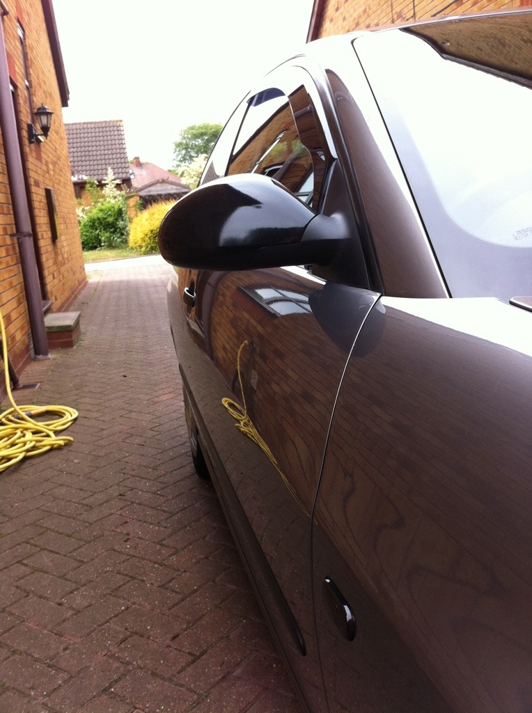

That's crazy dude lol all that light would be a bit much for me inside the cabin but it looks cool! Did you do all the wrapping yourself?
It's all wired to the dimmer on the light switch so it like can go to what brightness I like quite handy ;) and yeah side mirrors was the first thing and got kinda addicted ;)

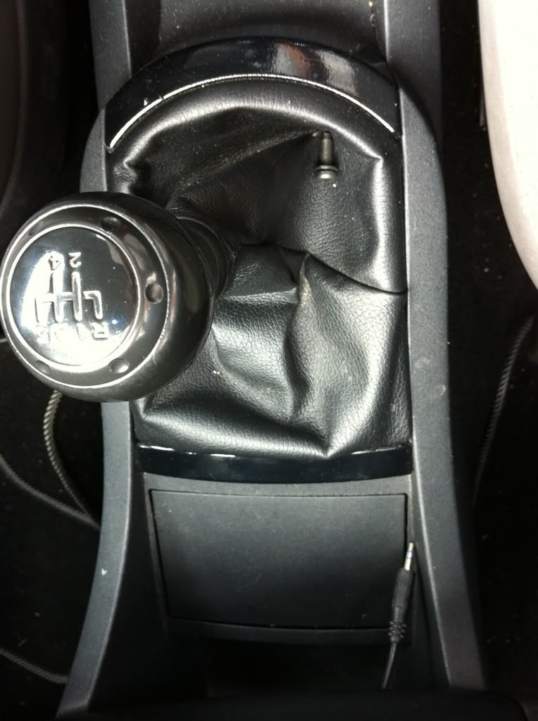

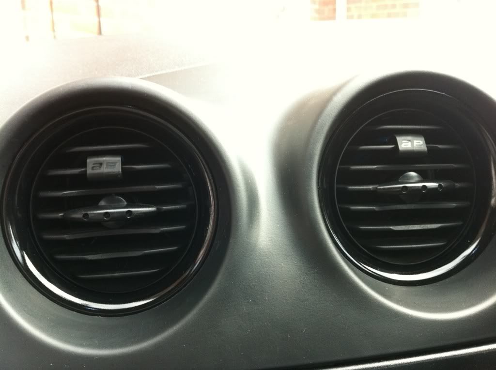

And this is my gloss black collection ;)
Nice! I would attempt some wrapping myself but having a black car I feel like my options are limited. How easy was it to do the outside B Pillar?
I love the gloss black around the vents thats good!

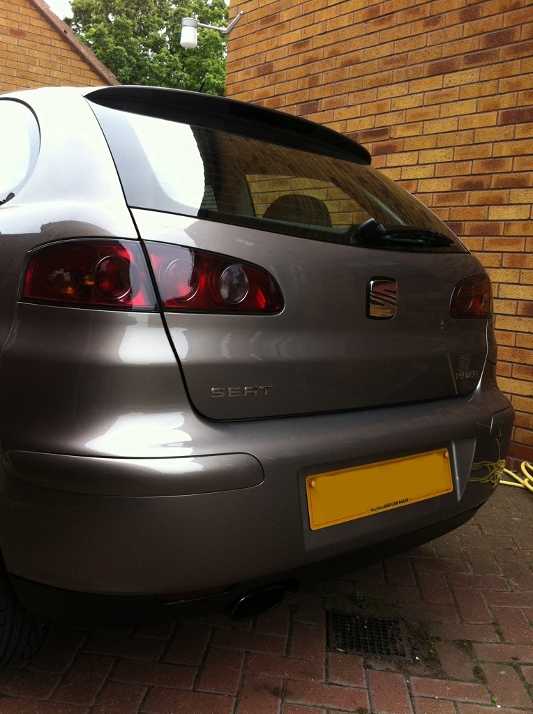

Lamin-x rear lights look great; light smoke or the darker one?
Next task is to get rid of those hub caps :lol:
There only light smoke thought dark smoke might be to much of a contrast because the Colour of the car ;)

Love all the gloss black bits. I have footwell lights like those too. Like them a lot.
Cheers and how are yours wired up :)
I'm guessing they're LED strip lights? How did you connect to a power feed? Just scotch lock onto ignition or something?
Yer just a 22cm strip and it's wired up to the light switch so they come on when lights are and because there in there I can use the dimmer swell ;)
Looks like this :
Uncliped the light switch and use a posi-tap (alternative to scotch locks ) one to live one to earth :)

Thanks and to do it when the door opens just same as how ive done it but wire it to the interior light youll find the wire up the right hand side of the front pillars and just figure out what wire does what ;) and fit up

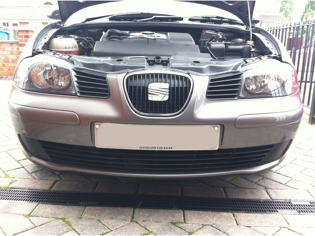

So I got my fr grills today, they have made a huge difference, here's what I did:
Started out like this
The first two upper honeycomb grills were easy

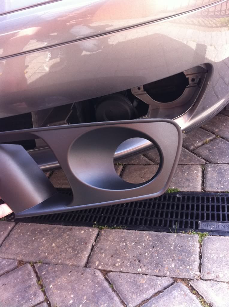

After that I had to do a bit of DIY work, I got the idea from someone on here (sorry i dont know their name) due to the fact of me not having fog lights, heres what I did:
So I got some plastic off a DVD case and cut it into a circle (ish)
And glued it to the cover
Here's the end result:
Tell me what you think :)
