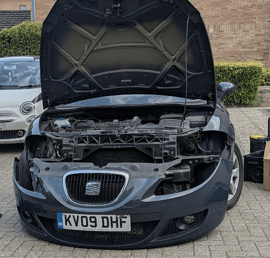

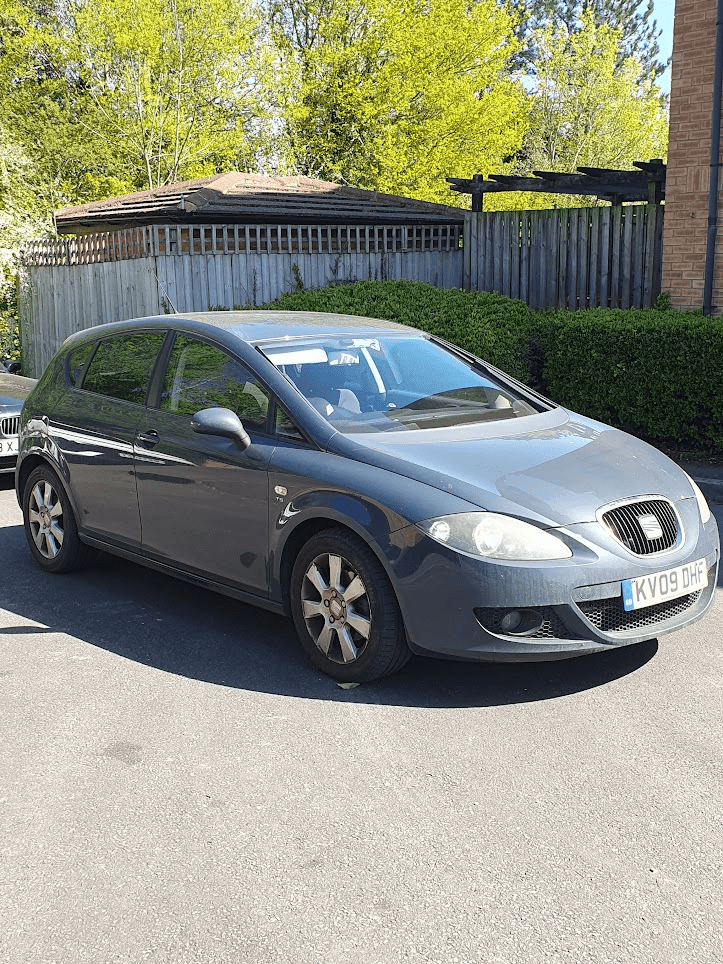

This is what he looked like at the start. All things considered he doesn't look all that different now - the wheels will make a big difference though.
When I got this car, I didn't even have my driving license. I knew nothing about cars and only bought this one because it was near my house and didn't have any problems - I had actually planned to sell it after a while and buy an audi or something (my taste in cars has changed drastically since then) but over time I got more attached to it and ended up spending way more money on it.

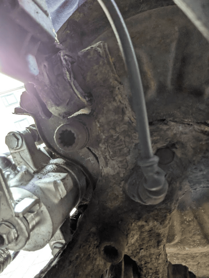

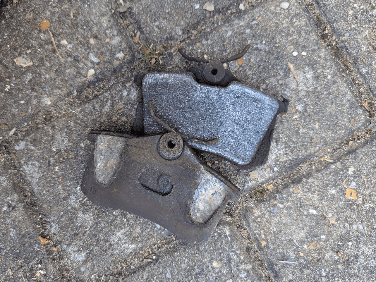

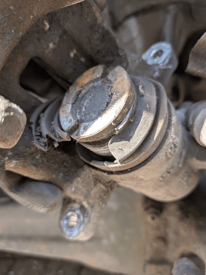

The first thing I did was change the brakes - I thought it was simply a brake pad change because it was making a grinding noise in the rear but when I took everything out and looked it looked like this:
Needless to say it was cooked and the brake caliper was seized.

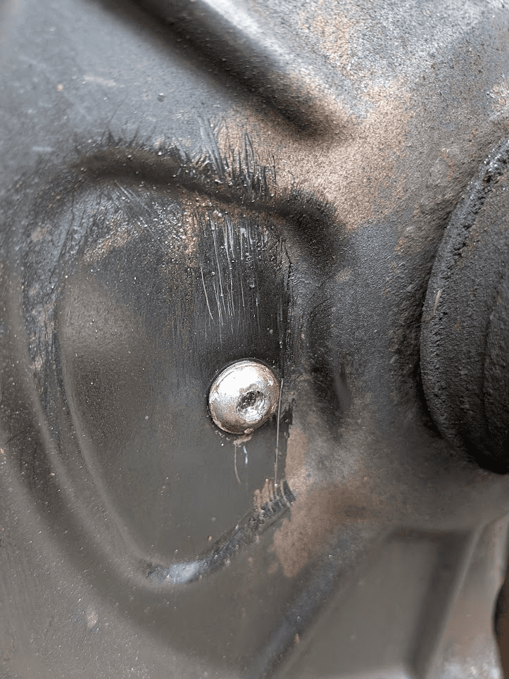

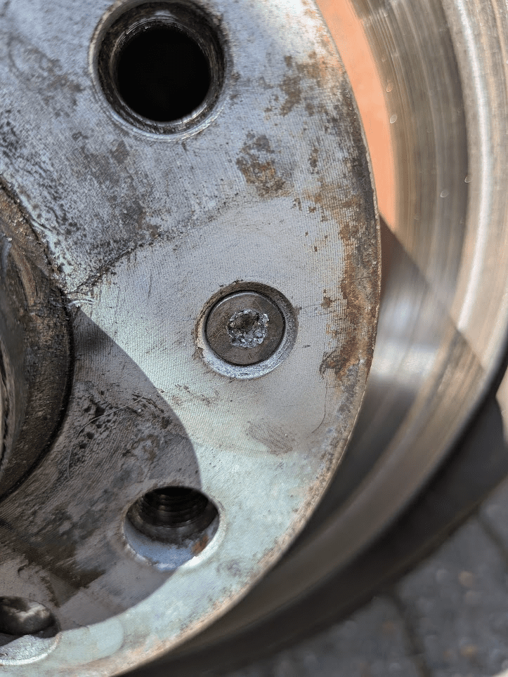

I also couldn't get this stupid torx screw out. At the time I didn't know it was a torx either so I tried to use a regular phillips on it.

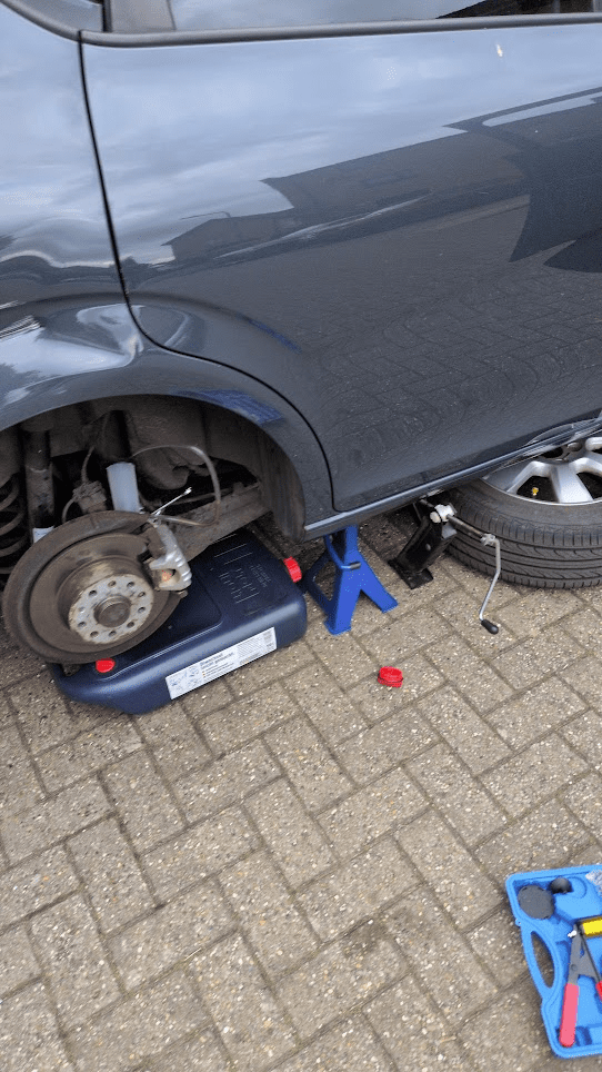

I replaced both rear calipers and pads but not the rotors (mistake I know, I couldn't get the rotors off). I ended up not being able to bleed the brakes properly no matter how long I tried (also the brake fluid was super dirty it was almost black). I ended up giving it to a mechanic my friend knew and he bled them and installed the new rotors. Alas the first time working on this car was a nightmare (and I did it all with the widowmaker jack). I'm not sure why I decided to work on it myself at first but I think it was mostly not wanting to look for a good mechanic and mechanics being expensive. Any money I spent on a mechanic could've been spent on parts so eventually I ended up doing all the work myself.
At least I had jack stands.

Not a very interesting one next, I gave him a good clean. Started off by seeing this cool charger:
I didn't have a pressure washer at home so I went to this nearby jet wash and rinsed it, then I took the car home and did a 2 bucket wash with dish soap and clay barred the entire car. Then I took it back to the jet wash, rinsed it again and parked it to the side and waxed the whole thing. This took a good 4 hours and it was night by the time I finished but it looked quite nice at the end.
You can kinda see its a car from 09 from the damage near the fenders. Also I didn't do a great job of waxing it but hey it was the first time, looked pretty good and I was happy with the results - I had to remove some wax around the lettering the next day as it had hardened and was white - I think it was also this day where I snapped off half the S of the "TSI" marker on the side. Maybe one day if I get good at painting I will paint that on.

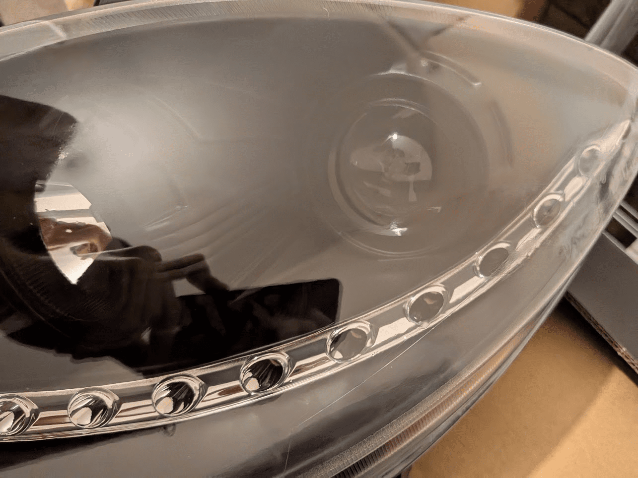

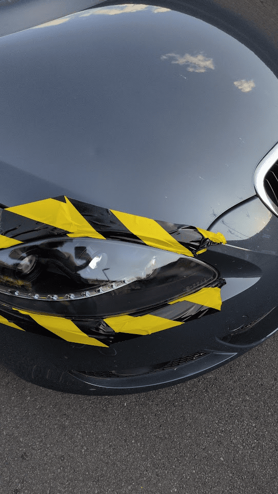

2 days later my new headlights arrived. I don't think the quality is great but they look really nice. The inside part of these headlight housings leaves a lot of room for improvement, I really preferred the OEM housing but these just fit the car so much better. The entire front bumper has to come off for this which was a bit of a pain with all the rusty torx screws.
Overall not a hard install, was really nice to have something easy after the pain the brakes gave me. I took it out for a little drive and took some pictures. I had to wait a while until nighttime so I could go and align the headlights properly though.
I tried to clearcoat the headlights so they wouldn't yellow over time but I underestimated how much flies like to land on them.
It was bad and the paint ran and flies decided to sit on the paint. I ended up trying to wipe it off but it had already partially dried and it was quite bad. It had a cracked texture which looked kinda bad. I ended up just living with it for a while. I eventually ended up taking them off and spending an evening wet sanding the clear down and then doing it again and it turns out much better, but still I think I didn't sand it enough and it still isn't perfect. I think eventually I'll either buy a new plastic piece and install that or get an orbital sander and sand the whole thing down really well - I was a bit lazy since it was taking so long to sand.

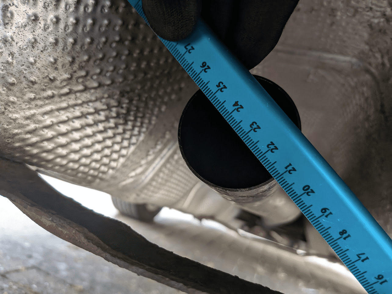

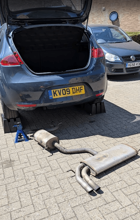

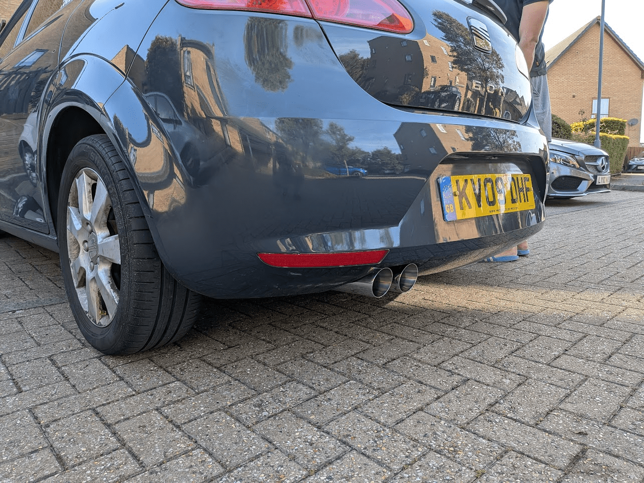

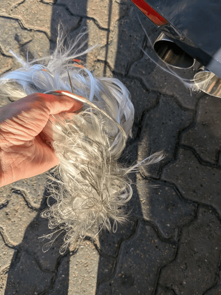

I had ordered an exhaust the same day as the headlights and it arrived a few days later. I took the old one off (my god those rubber hangers were a pain. I ended up borrowing my friend's water pump pliers but man I wish I knew there was a special tool for this, it would've been so much easier.

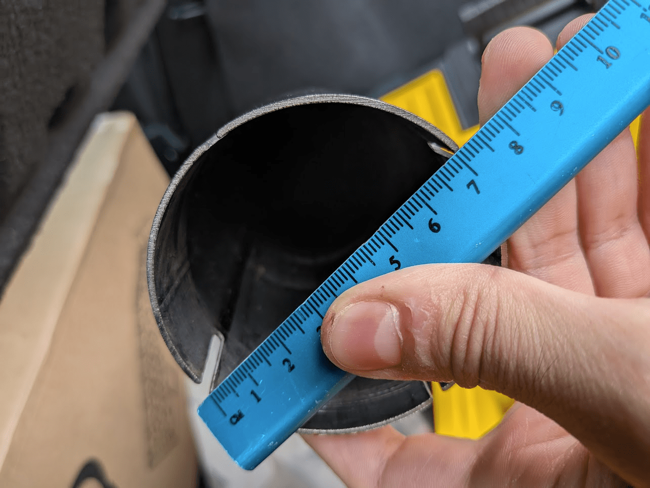

I had a problem though, the new scorpion exhaust was a lot wider than my existing exhaust.
(No I didn't have a caliper. I do now though, still you can see a big difference). I ended up emailing the guys at scorpion redpower and they sent me an adapter the next day, absolute legends. Installed it and all was good, I ended up taking it for a drive and it actually sounded really good. It also looked a lot nicer than the original:
I did have the issue of this fiberglass coming out
Which I showed to the guys at scorpion and they wanted to send me a new one but it stopped after 2 days and I didn't notice a problem with the sound so I just told them it was fine and they said to let them know if that changes. Overall very happy with those guys but yea, I had some of this stuff come out the exhaust and I foolishly touched it with my bare hands (I didn't know what it was at the time) but luckily I only got a tiny cut and it didn't matter. I was very happy with the sound of it, especially since I was expecting it to sound like **** because its a 1.4 liter engine but it sounded quite nice and I've been very happy with it since. It isn't too loud and the droning on the motorway from not having a resonator wasn't too bad either. It has been somewhat inconsistent, I feel like some days it is super quiet and other days it is normal. I'm still trying to notice a pattern but I have been unsuccessful so far. Maybe it has something to do with the fiberglass that came out, I'm not really bothered though so I just leave it as it is.

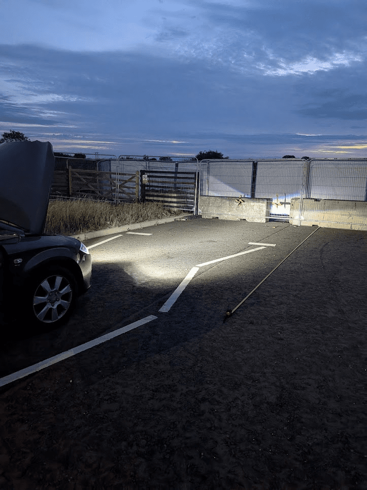

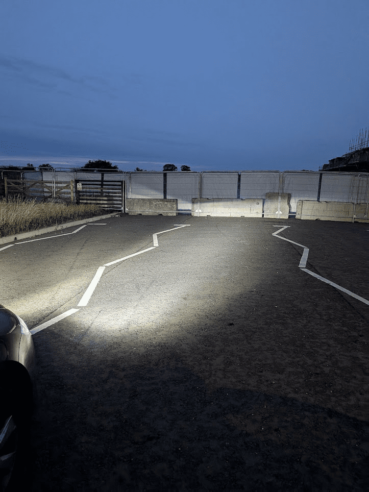

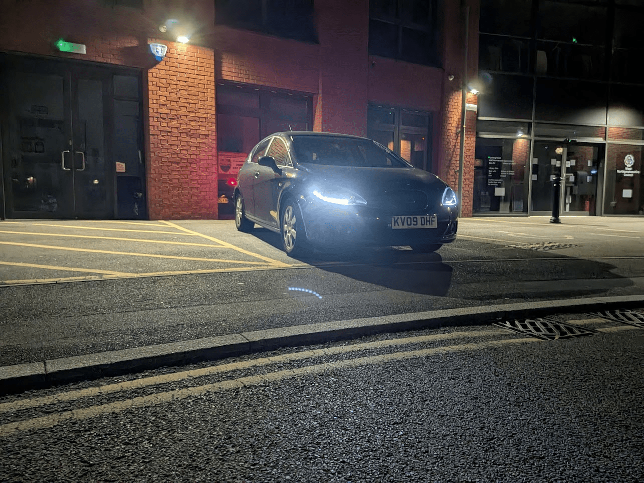

A couple days later I got some LED bulbs and aligned them properly.
I think this place was actually a bit curved but I couldn't find a better place to do this. The image is before aligning them, took some fiddling because these headlight housings are weird and I think one of the adjustment screws is a bit loose anyway.
You can also see that the beam pattern is kinda U shaped, I've managed to deal with this by turning the bulbs which I thought wasn't suppposed to work because they are projectors but it helps a little. It is weird because it seems to be wonky sometimes and not others. I've never had anyone flash their high beams at me though so I assume it has been fine - might be because I have since lowered the car. When I lowered it I re-checked the alignment and it seemed better than before so I just left it.
Anyway this LED swap was NECESSARY. These headlights came with halogens and they were completely garbage. You couldn't see anything at all and they got super hot - when I removed them they were already black and that was only after a week of them being installed (I didn't even drive much).

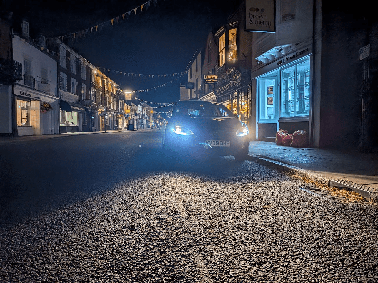

Some time later I took the headlights off and sanded them down and clearcoated them again, it turned out much better this time:
I took them again and re-aligned them. It turned out much better than last time:

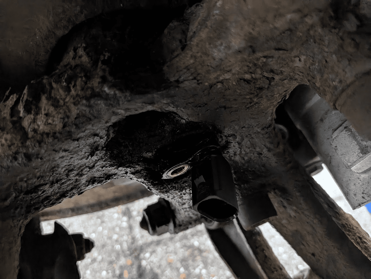

The day after this I also replaced one of the ABS sensors - I suspected it might be this that was causing me the ABS problems and wanted to rule it out before buying an expensive new module (and replacing the modules is hard). It actually snapped inside the knuckle and I got lucky I got it out. This didn't solve the problem though.

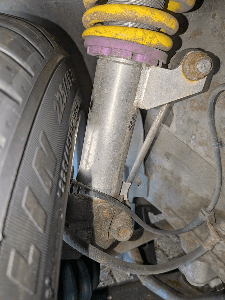

In September (2025) I received my KW V1 coilovers. I started on the front because I assumed the back would be trivial, it was 5 bolts in the back so I thought it would be easy so I started on the front. This was by far the most painful thing I have done on this car. Combine a lack of experience and rusty old suspension components, you get a big headache. It took 2 weeks to install the front (most of it was waiting for new parts) and I completely skipped installing the rear.The old struts may have been original from 2009.
Partway through this install I saw a cool MR2 (I no longer like silvias, I want an MR2 as a project car) and thought I'd include it here.

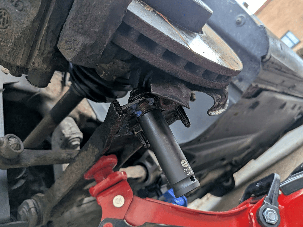

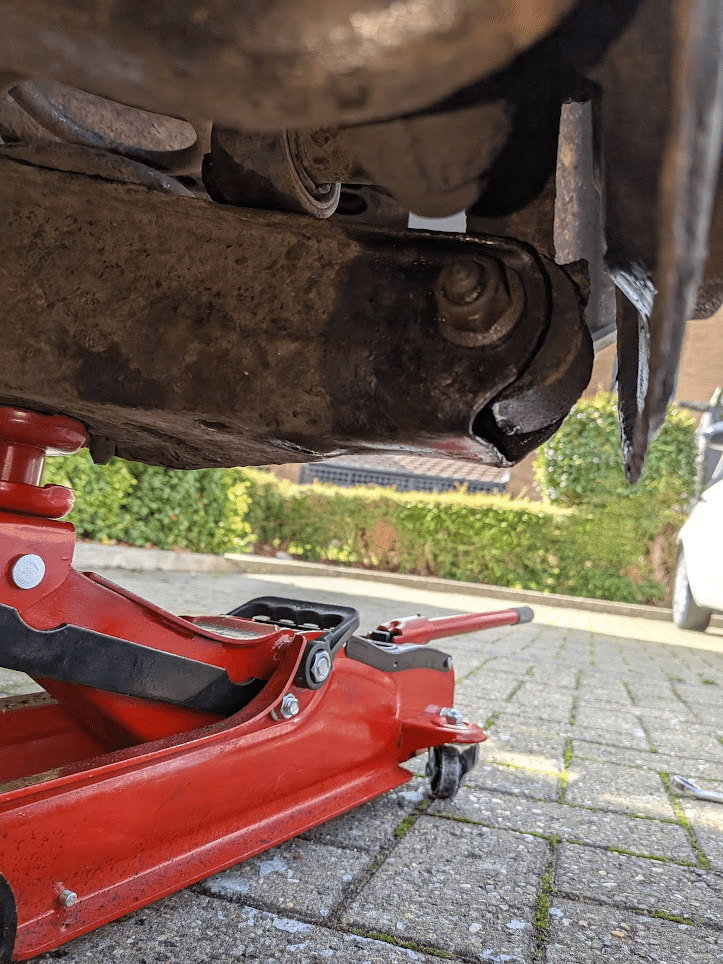

I had a lot of trouble with various bolts. These ball joint nuts were a massive pain to get out, I had a cheap aliexpress socket set I started off with and I rounded off my deep socket. I simply couldn't get a good grip on these and I eventually gave up and bought a cheap Seessii impact gun. I'm sure its not as strong as it says but it has dealt with anything I give it and it was very cheap so I'm happy with it. Anyway, this bolt finally came out with the impact:
I had also bought a lot more tools by this point. I had 2 jacks, the low profile one was specifically for lowering the car and the ramps which you saw in the headlight section. I had a lot more tools by now (expensive, even when buying cheap garbage). Anyway, I got this out and got the steering rack out and got the new strut in. The left side was not too bad after I had the impact. I also needed new top mounts for the strut, KW V1s didn't come with any and I didn't want to take the old ones off the strut since I only had the suspicious spring compressors and I would rather just get a new one anyway.

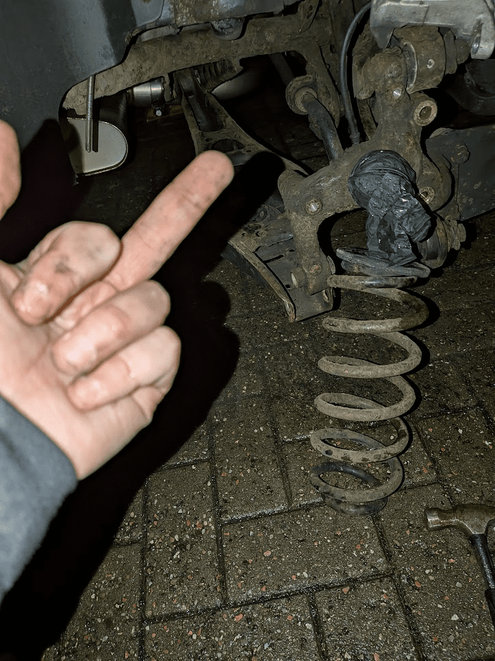

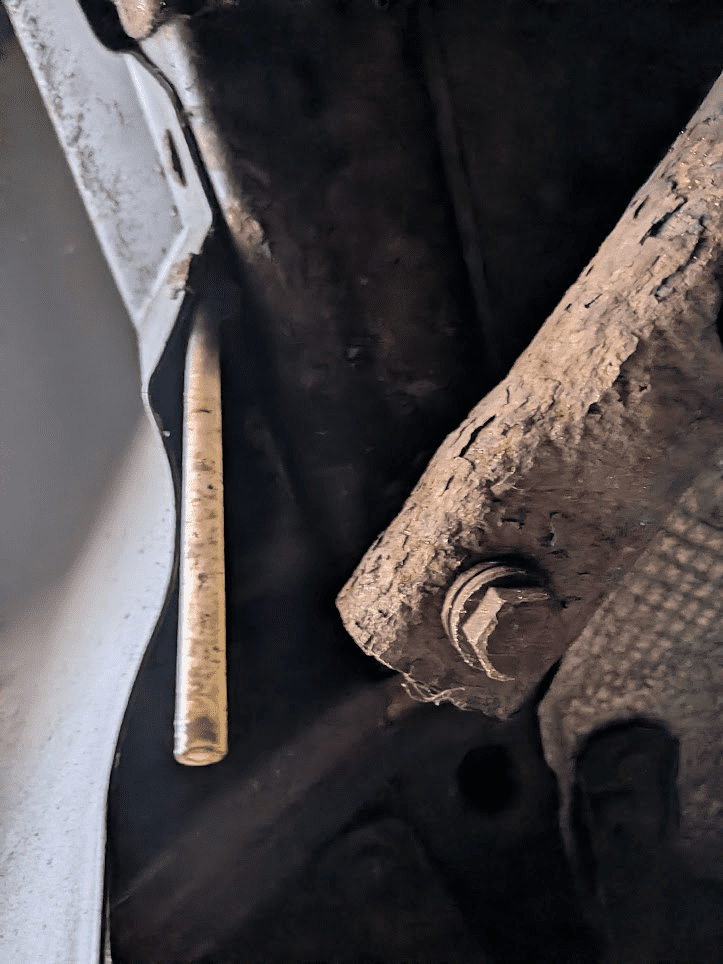

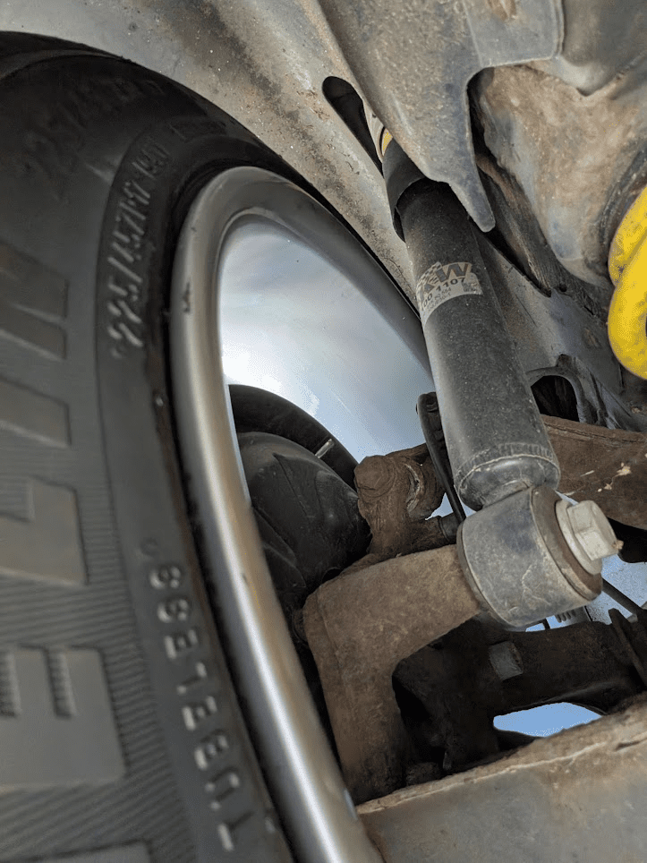

After weeks the left side was done. I tried to to do the rear on that side but the bolt that connected the knuckle to the control arm wasn't moving - not with an impact or my 18" breaker bar - I assumed the bolt was seized to the bushing sleeve.
There wasn't enough room to fit a socket on the nut side and I didn't have enough space under the car to fit a wrench extender. I skipped the rear for now, I just wanted to drive the car.
I moved onto the right side. The top mount nut had seized to the bolt and was just spinning freely in the top mount - it would spin and not loosen. I had to drill a bunch of holes in the top mount and eventually got it out. It took absolutely forever and was a massive pain. I also needed new top mount bolts so I went to the dealership expecting to get scammed (I didn't have access to part numbers back here so I couldn't buy them off ebay or autodoc) but it was surprisingly reasonable. I think I paid 7 pounds for the 3 top mount bolts.

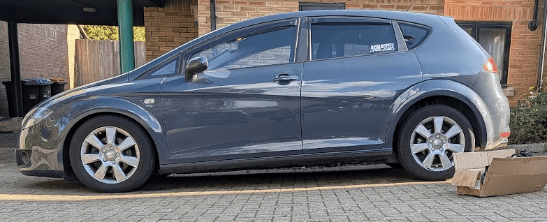

This is what it looked like at the end of all this, the front actually got a bit lower after a while when the suspension settled. I believe KW actually says not to lower the coilovers fully but the whole reason I got it was for the looks and I wanted the wheel gap to go away. I tried it and had no issues so I assume they said that for clearance reasons. I did have some kind of rubbing noise when steering was full lock left or right at low speeds but I believe this was the strut top mount, there was no sign of rubbing anywhere. I think I installed the right top mount in the wrong direction, I loosened it and rotated it a bit and I haven't had the issue since.
My girlfiend found more cool cars

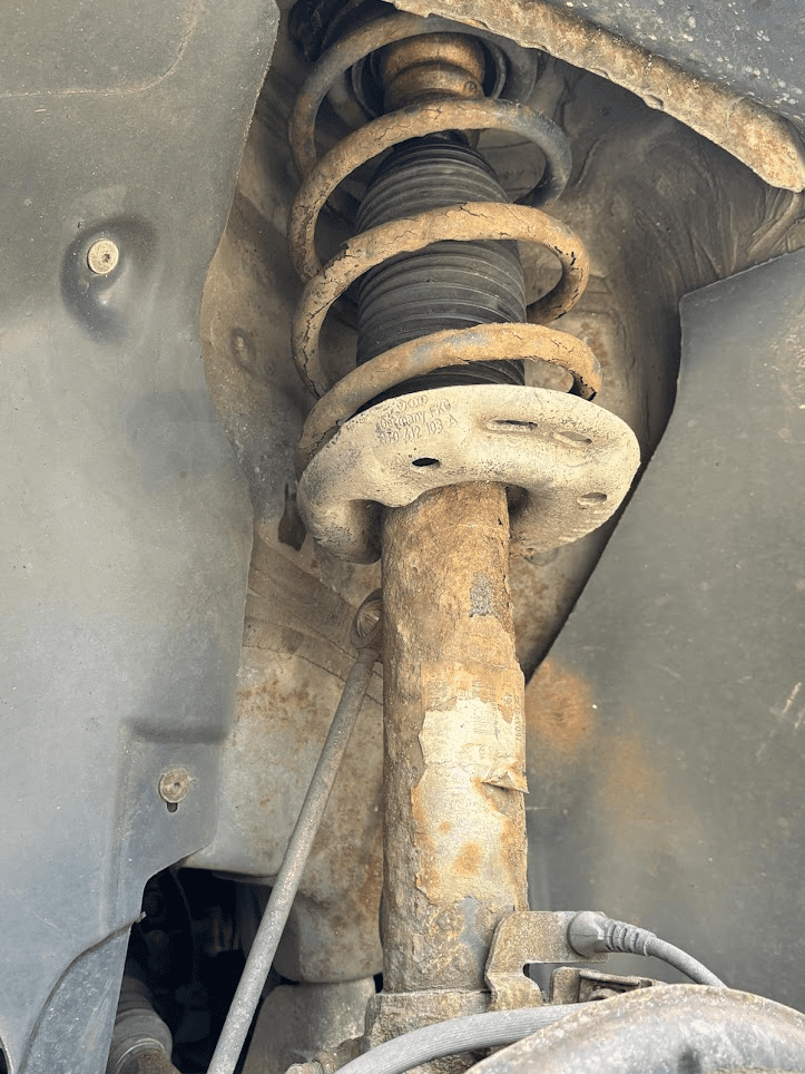

I drove the car like this for a long time. The car is kind of pointed downwards which I expected to cause me to have more grip in the front but the rear springs had a lot of travel so when accelerating hard from a stop the wheels would lose grip a lot. When I lowered the back I noticed far less slipping. This isn't a fast car by any means, it is 1400kg with 123bhp and probably less since it is from 2009 but that was an unexpected side effect of this setup.

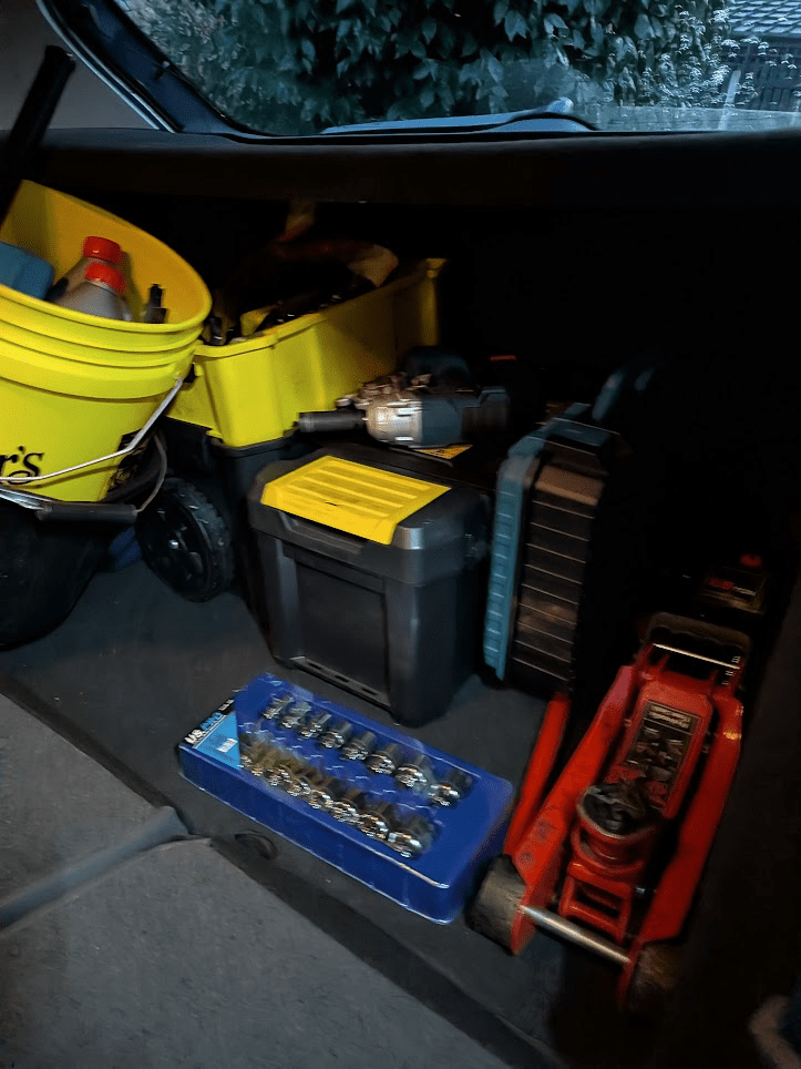

I moved all my tools down to my car and left them here so I could minimise the effort needed to work on the car as much as possible. I started off with the brakes and wheel bearings in the rear. I also ordered new brake shields since the old ones were cooked. I found the brake rotor screws to be quite easy to get off with a manual impact surprisingly - it really felt like I had progressed since that first brake job. I was removing things easily and while I had some problems (like the hub bolt) I ended up finding solutions quite fast. It felt like I had finally learned and could do things properly now. I removed everything and once the hub was off, I managed to get the rear spring out and install the rear coilovers. This did all take about 4 weeks, I had to wait on parts a lot. I replaced a ton of bolts because they were old and rusty and new bolts just made me unreasonably happy.

A lot of the torx bolts were in bad shape, things like this one
I found you really need to be careful with these. If you strip them you're in for a bad time. My strategy was to wire wheel them a lot and then go straight to the impact screwdriver. It worked for all but the one in the image, that one I took a chisel and just lightly tapped it in a counterclockwise way and it came out.

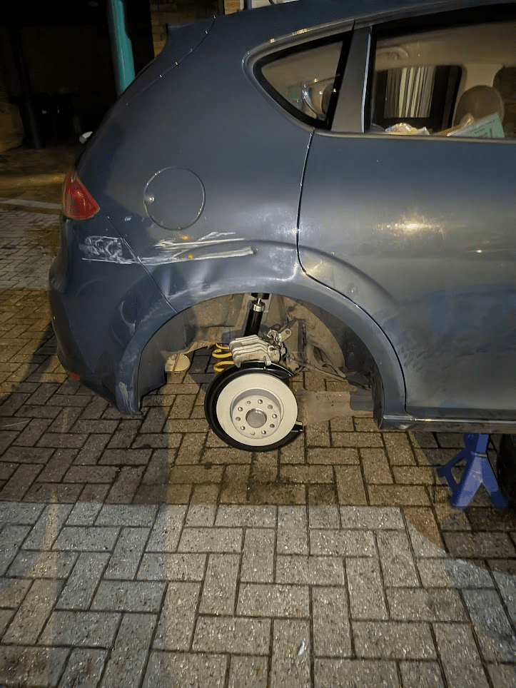

I had finally defeated the rear spring and I was super happy. This one problem had caused me so much stress trying to think of a way of getting it out. I thought about using a spring compressor to compress it and slide it out but the one I had wouldn't work like that and I didn't want to pay 1000 pounds for a dealer grade one. I put a random glove on the knuckle to protect it since the new hub hadn't arrived yet and I finished it the next day.
Very shiny and new. I got zimmermann coated disks and brembo's street ceramic pads. The disks seemed ok but are already starting to rust a bit - I will probably go with brembos next time since I think they'll probably look new for longer - honestly this brake change was so I could make the brakes look ready for the new wheels. I expected it to look really ugly if the new wheels had thinner spokes than the original and the brakes were old and rusty, so I decided to buy new ones since I would need them eventually anyway.

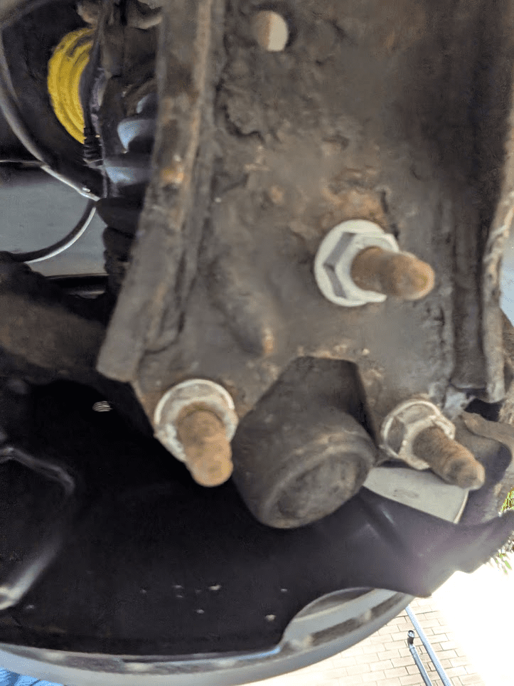

I also remembered I used the wrong nuts on the front ball joints, they were random stainless steel nuts that I bought from screwfix before I knew any better. I replaced most of them but there were 2 I couldn't get back off - they would just spin. I figured if I can't get them off they aren't going to get removed by themselves, I'll come back to them later and extract them somehow.
There is at least one correct nut holding and it seems to be fine so I left it - but its pretty high on my to do list of things to fix on this car.

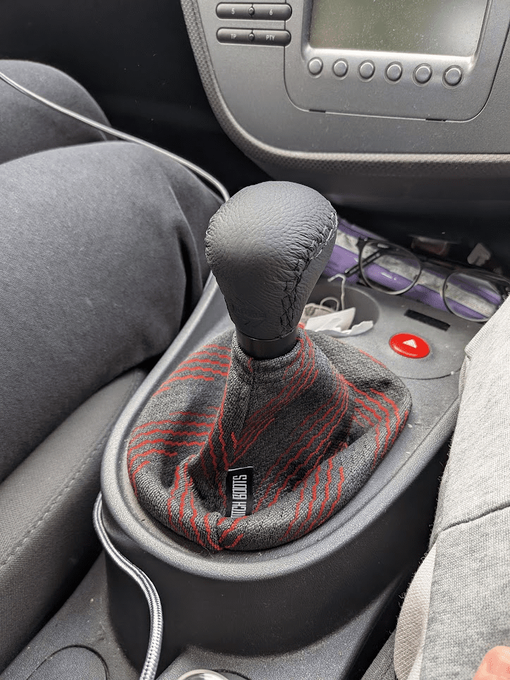

When I first bought the car, I bought a cheap shift knob and boot from aliexpress. I installed them but the adapter made the shifter taller than before. This makes the throw longer and also feel a bit worse. The threaded shifters also have a tendency to come loose over time and this is not ideal. I ended up buying a momo anatomica shift knob - it it exactly what I wanted. It has some weight to it, it feels like its made of quality materials and it looks nice and simple too. I also bought a shift boot from stitch boots that was super easy to install. If you've ever messed with these shifters, you know installing them isn't the most straightforward. Some shift boots will need to be stapled onto the mounting bracket - I sewed it on with some string before but this time the stitch boots one had an elastic part at the base that made it super easy to fit. I got one of these to fit underneath the top of the shift boot to prevent it from sagging:
I didn't install it in the usual way because it would look weird, I wanted it to be flush with the shift knob so I just installed it under the shift boot entirely just to hold it up. In the end it looked like this:
(excuse how dusty the car is I really need to clean the entire thing) This made a huge difference to how it felt to drive. Big fan of this shift knob and stitch boots, would totally recommend.

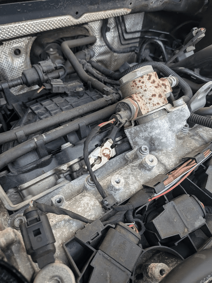

No idea how this got here. I also planned on changing the spark plugs but I only have a 1/2 inch torque wrench so I left that alone, the last spark plug service was about 30k miles ago anyway so I should still have time for that. I actually had a problem with this though - it seems the oil filter you need for this engine has a little spring mechanism at the end (I believe to keep oil in it so the engine fills with oil faster on startup) but the one I received didn't have this.
The one I got looked like this:
Whereas it is supposed to look like this:
I drove the car a bit and the low oil pressure light came on. I pulled over and the light went away and I checked the oil level and it was a little low - I drove back home and as I was parking the light came on again. The light was on probably 3 seconds total so I don't think I damaged the engine (hopefully). I got the new filter and I took it to an area that was definitely level and checked the oil level - it was too low so I filled it up. I haven't had the issue since so it was either the filter or the low oil - probably the low oil but I will be careful with the filters too from now on.

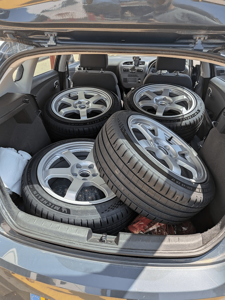

Back in November or December, I ordered a set of Enkei T6S in the size of 7x5x17ET45 (or ET40, can't remember). These ended up getting delayed for like 3 or 4 months and Tegiwa gave me a discount and later just refunded me fully and said next time I buy something to tell them so they can give me my discount back - props to them for that, stupid Enkei apparently didn't know when they would arrive even after 4 months of delaying it.
Anyway, around this time I saw an Instagram reel about forged Alibaba wheels and thought it would be a good deal, cheaper than my Enkeis and forged and lightweight I was so down. Once I got the refund I went on wheel-size and took some measurements for fitment reasons and ended up with 8x17ET45 as a good starting point so I gave woaforged the specs I wanted: 5x112, 57.1mm center bore, the above size and offset and after a few days they sent me a picture of a 3d model to approve and after a few weeks a video of the wheels that were made. They then sent them to me with sea shipping which is supposed to take about 2 months but it took 7 weeks for me.
I took them to Costco and got them to put on some 225/45ZR17 Michelin Pilot Sport 5s and just today they were ready. I went and picked them up, drove back home and fitted them with my wheel bolts I had bought a long time ago (honestly don't remember where but I can find out if anybody wants that info) and to my surprise, they actually fit with no rubbing and a tiny bit of clearance from my KW V1 suspension. I was very worried about this because these are pretty bulky coilovers but I got lucky and they fit with maybe a couple mm of clearance.

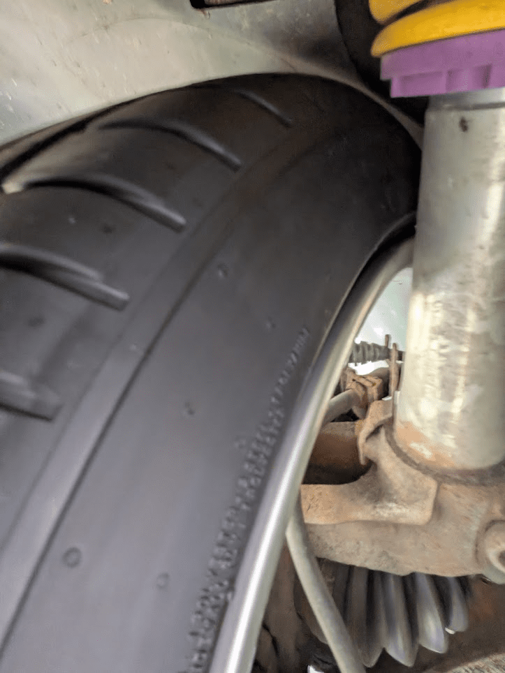

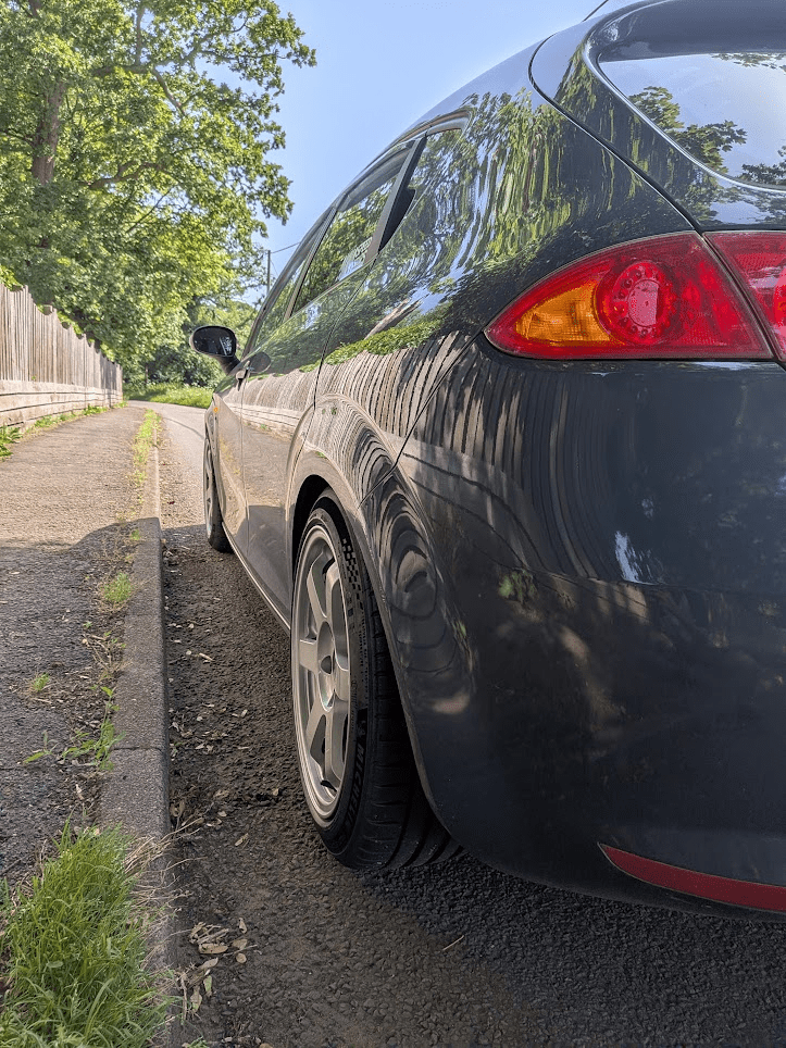

Here are some pictures of how close they are to the suspension:
The rear has tons of room though.

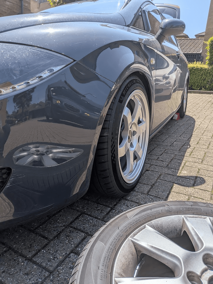

I took it for an alignment and my alignment was quite ****** up (except for the camber, those were pretty close to each other). It makes sense since I've had this car for almost 2 years and in that time never got an alignment, I wanted to get one 6 months ago but I was waiting on the new wheels and I'm pretty sure that makes a difference. The rear toe adjustment bolts are seized to the bushing sleeves though so couldn't fix the rear. Once I get a couple days I'll probably cut them out and replace the entire control arms, but its so hot outside and I need the car to get to work so it will wait, worst case scenario it needs new tyres.

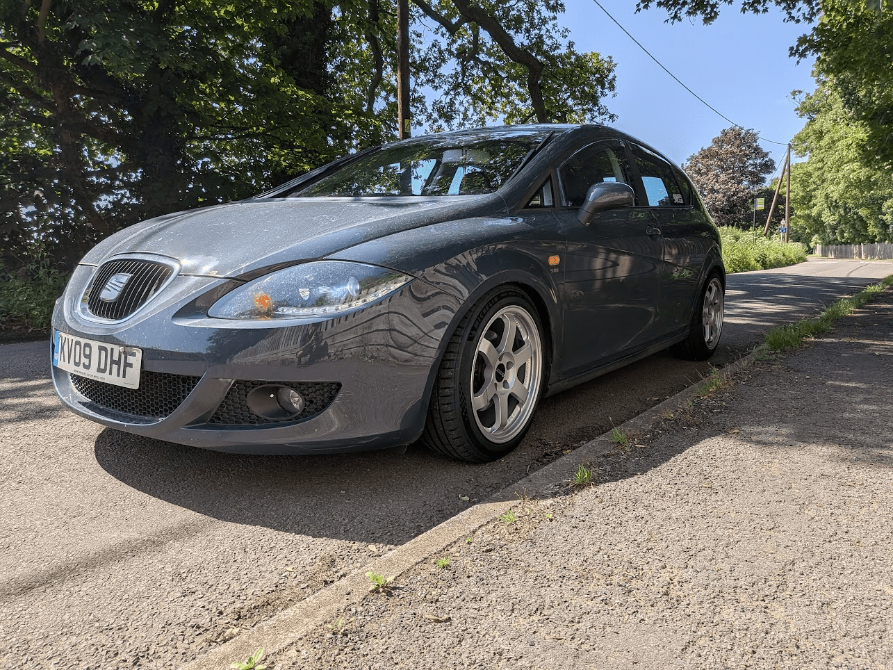

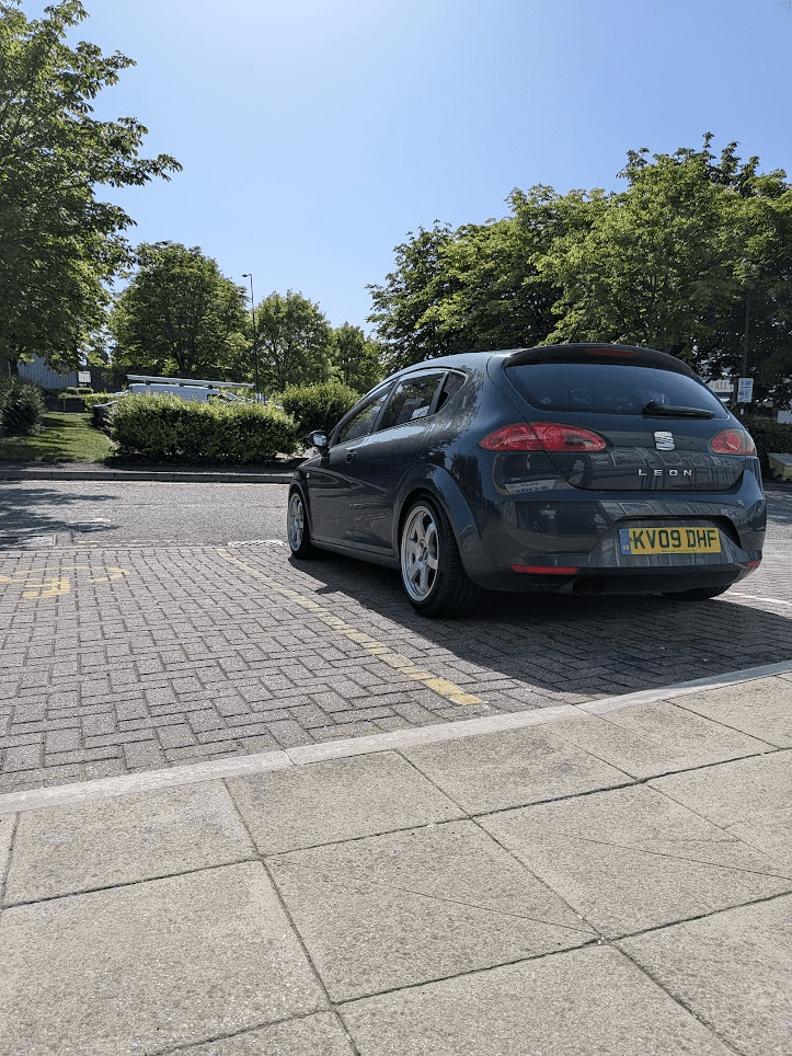

Here are some pictures I took today:
I'm actually so happy with how these turned out. I suspect the car might look a little nicer with something like BBS SRs or other high-spoke count wheels but I didn't want to risk it and find out, I feel like you simply can't go wrong with TE37s, especially since they look similar to the original wheels. I reckon that's what sets this car apart from a mk6 golf, it just has a much smoother, curvier vibe than the rigid looking golf that it can probably pull off high spoke wheels a bit better. When I bought this car I was by no means a car guy and over time I appreciate Seats more and more, Leons especially just look so nice to me now and I smile a little whenever I see one on the road.
The fitment looks pretty flush too which I'm happy with, the measurements I took were a little conservative since I could have added spacers but I ended up not needing to anyway. I fully expected the rear to need spacers since it had a bit more space but I think the front actually poke out a little and the rear is more flush than the front. Overall I'm happy it A) fits and B) looks nice.
The tyres are amazing also, I have them inflated to 36 PSI front and 33 PSI rear (found those numbers on wheel-size for other MK2 Leon's with 17 inch wheels and same tyre size) and it feels like I have infinite grip - I don't really drive crazily especially because roads here have such poor visibility that anything could be behind a corner, but in the 1 or 2 good visibility corners I can take a medium left at a solid 50 without even being worried.
