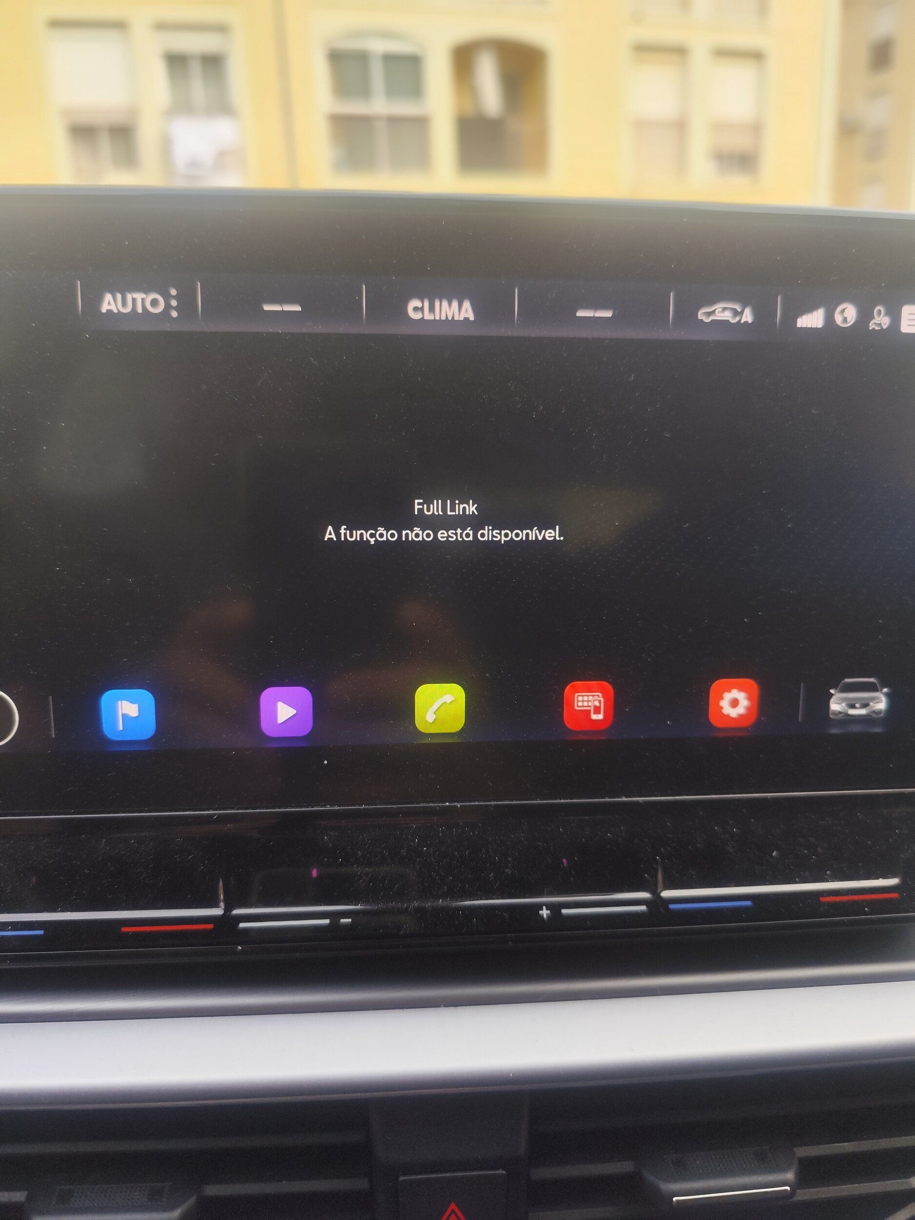

Anyone can tell me if it's possible to enable Full Link on my car ?
5FA035862K
H56
1969
Hardware ABT H37
Software ABT 3074
Dealer says it's not possible (Don't know if that's correct or just they don't care).
