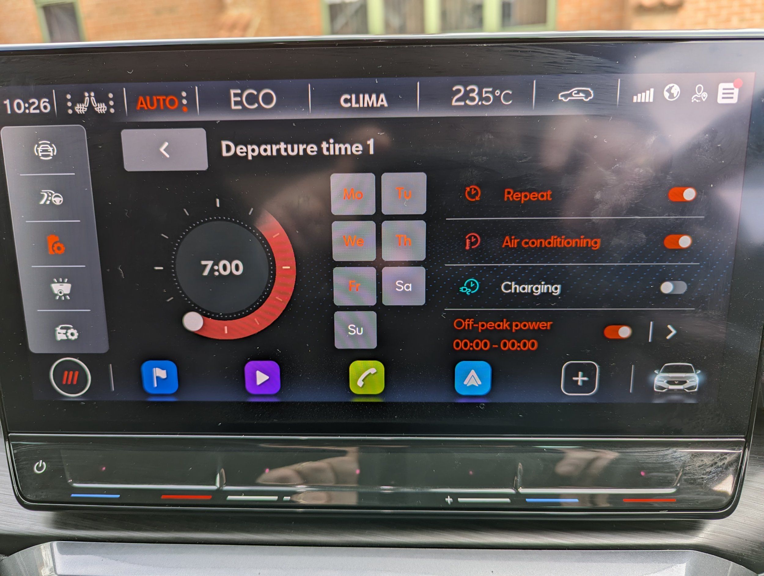

For the life of me I can't see how I set a temperature for the departure time, I'm just looking for heating or cooling , I'm not bothered about setting up a charging time...I just don't know how to set them temp?
Any ideas folks

Press the icon of the car on the screen. Press 'battery', then 'e-manager'. You'll find the temperature setting in there along with departure time setup.

I can see where I can set ac but not the temperature ?

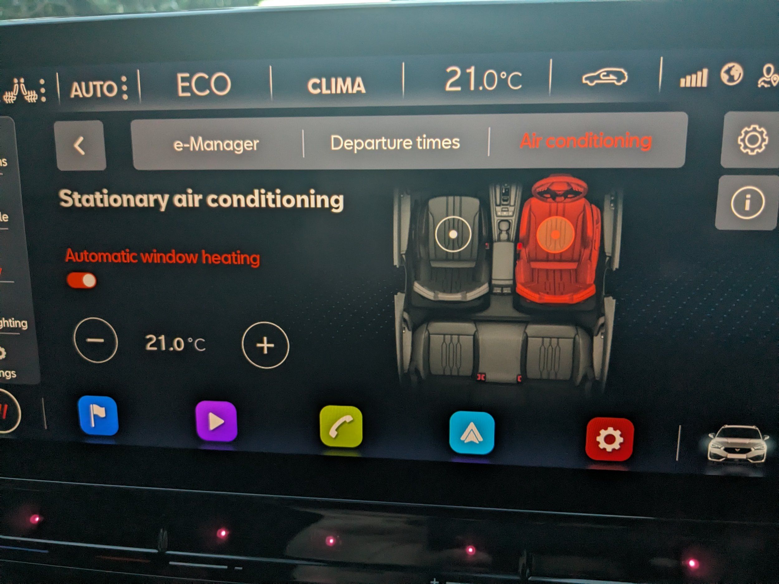

Thank you to those that replied, I've got it now, I think the departure time in the morning wasn't working because minimum charge was set to 30% I've now taken this down to 10%
I can now see where to adjust the temperature
The only thing that's puzzling me still though is the fact that when I get in the car the heater is always set to max .

Minimum charge relates to the minimum it will charge to when you plug in. So if you plug in at 9pm, it will charge to 10% then stop and will complete the rest of the charge at your set departure time in the morning (if your departure time is set to charge).
Mine is set at 10% (the lowest available) because I want it to charge overnight at the cheap rate without me having to physically plug it in at midnight!
I think the a/c being on max is because the system tries to heat/cool to the set temperature as quickly as possible so you may be entering the car whilst it hasn't quite hit the desired temperature.
Also, stationary air con will only work if the high voltage battery is sufficiently charged.
