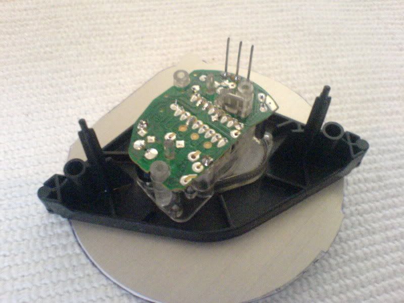

Take apart the cluster with the rev counter and try and pull out the rev counter dial. It should literally be just a case of holding onto it and pulling it up. This is what the back of the clock dial looks like, so if the rev counter has similar pins in similar places, than the chances are that you will be able to just swap the two dials around.
Mig
Unfortunately it looks nothing like that so it looks like the rolling odometer dials will be going on eBay.
