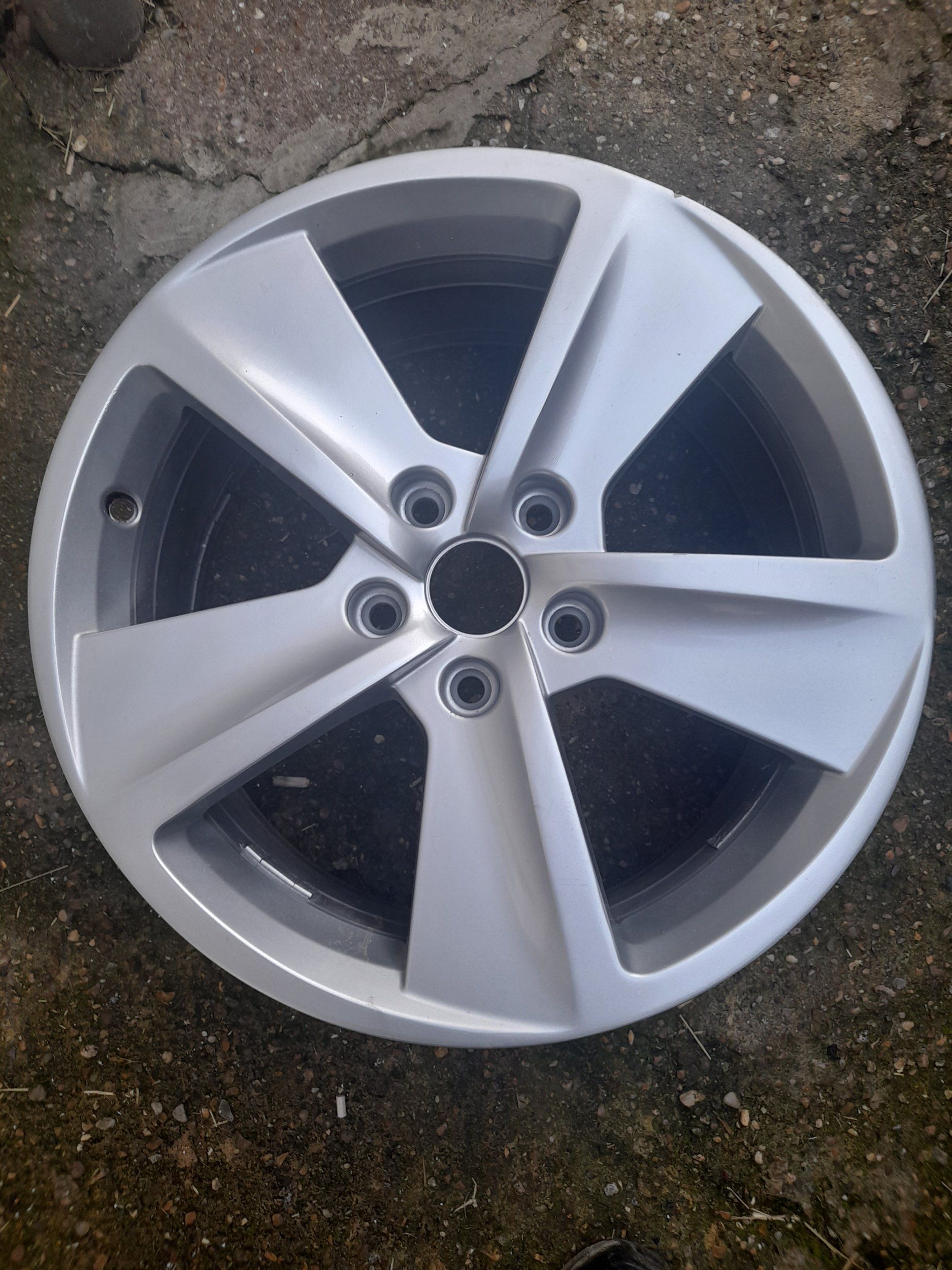

I i have this for sale

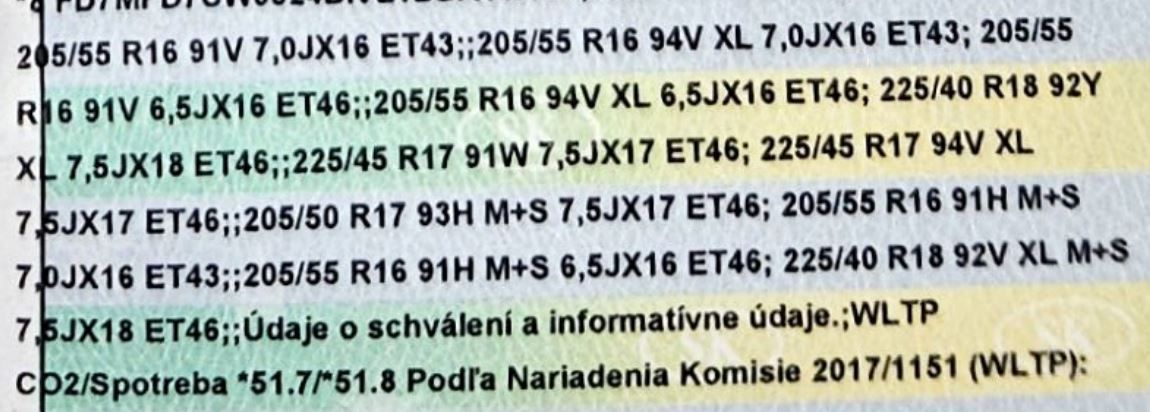

Hi, here is table with allowed tyre sizes from my Slovak vehicle registration for "baby" Cupra with 1.5eTSI. Maybe it could help to someone.

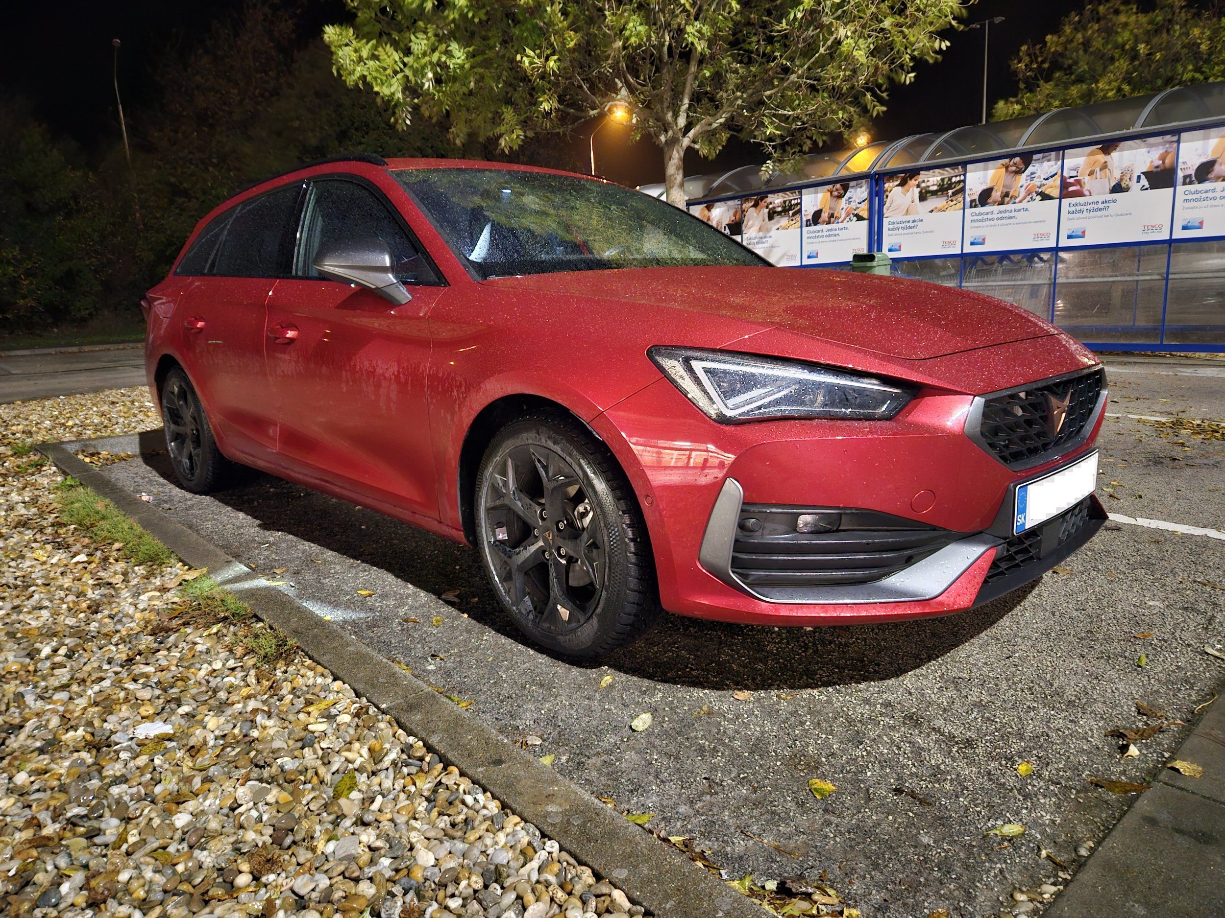

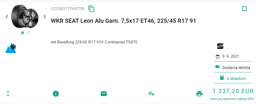

I bought this ones for my car. I even bought OEM Cupra center caps in shiny black (+-20eur)
Final result.
