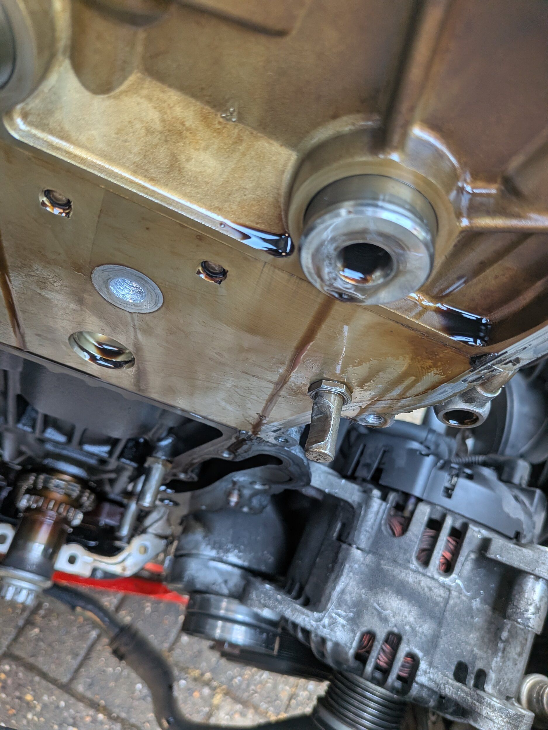

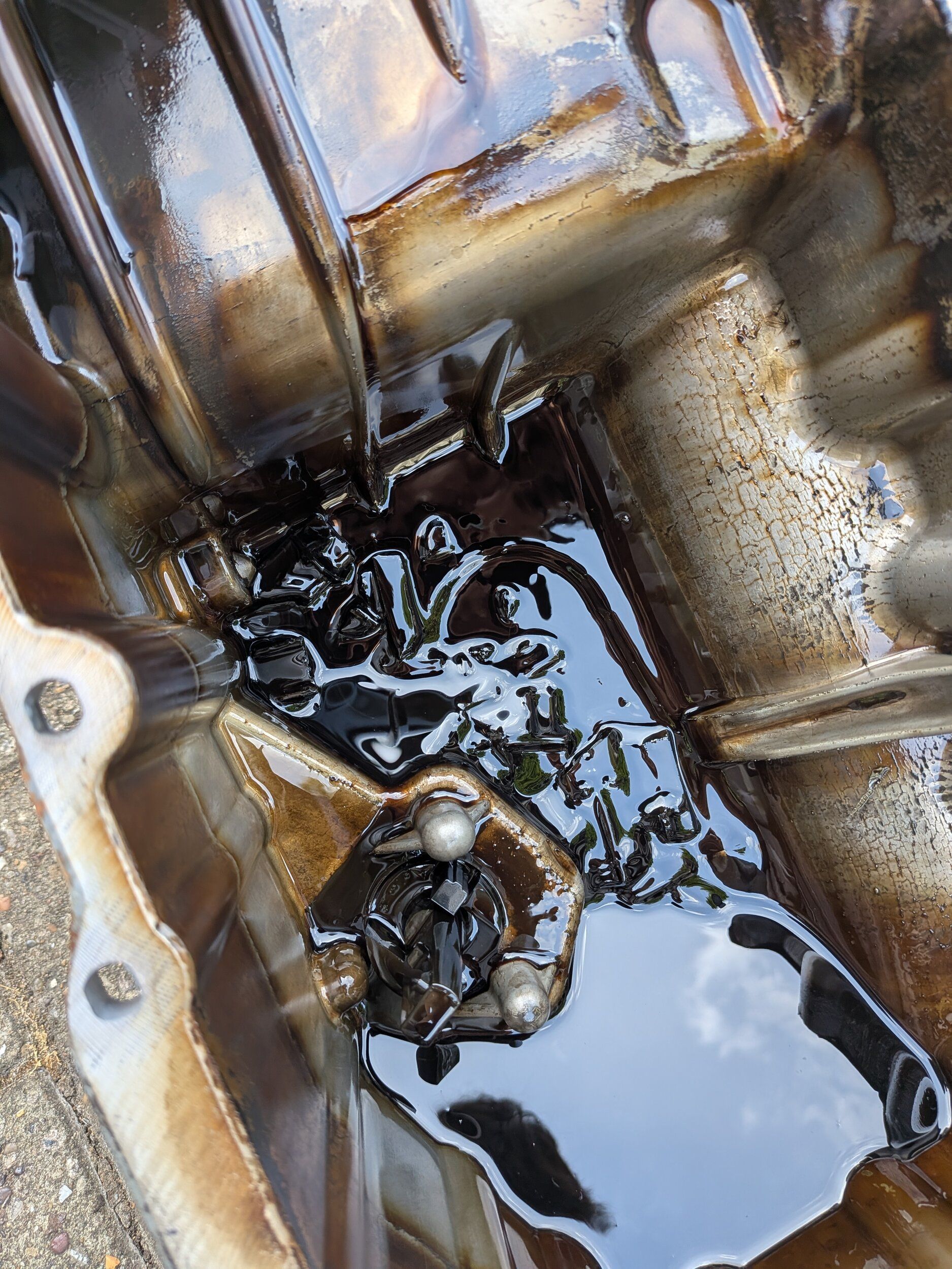

This one bolt took me 3 days to get out. It was the last one keeping the oil pan attached. I dropped the oil pan because it was full of timing chain guide shards:

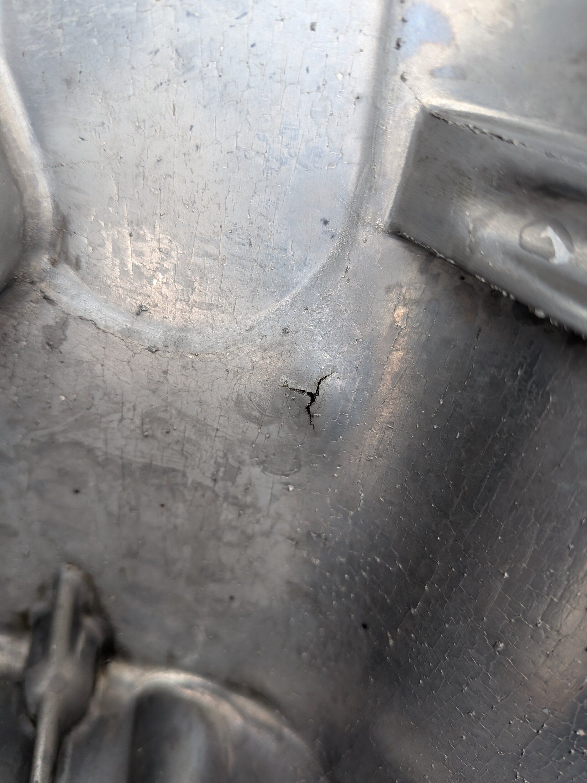

I gave it a good clean and noticed there's a crack in it. This explains the minor oil leak the car has had for forever. the other oil leak, not sure - I still think it was the timing chain cover gasket near the alternator because that are was drenched in oil.

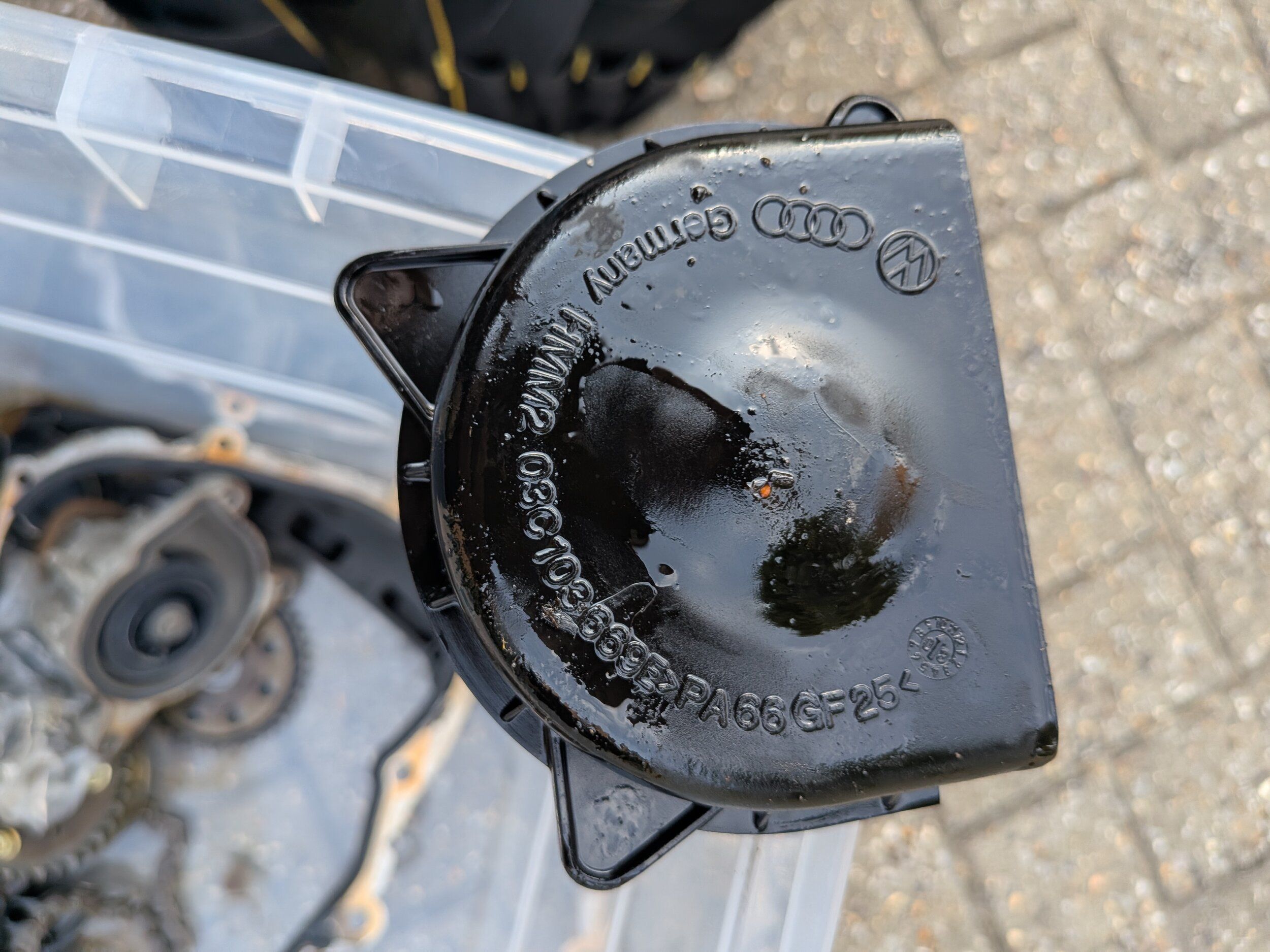

Right now I've got the new timing chain and parts on, the new oil pump is ready to go and I'm just going to be waiting on the new oil pan and this oil pump cover that broke when I took it off:
