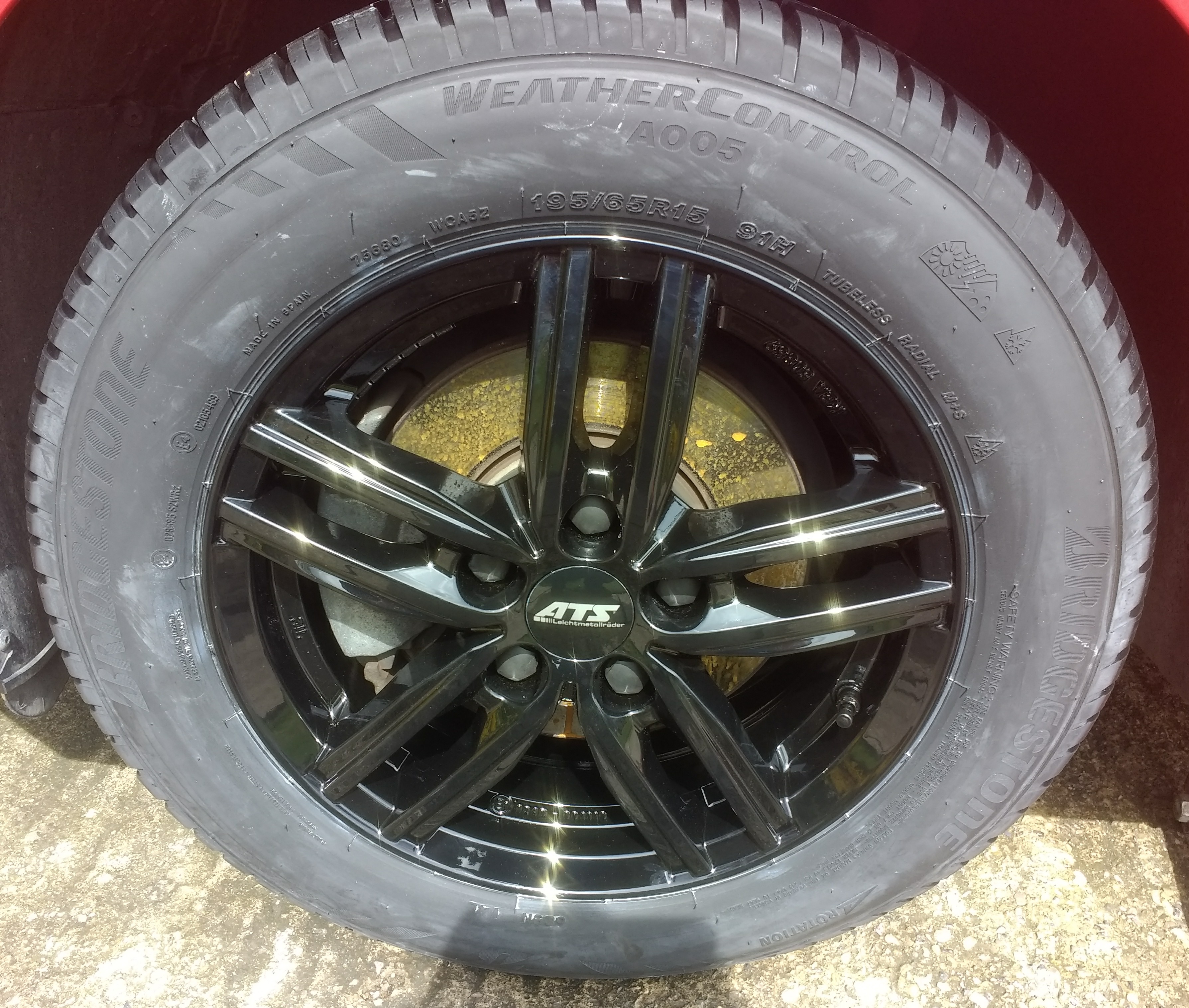

Finally bought a new set of alloys, fitted Bridgestone A005 tyres for all year round use. I've noticed a big difference in comfort levels, reason I changed them, not for looks. They're 0EM sized alloys from a reputable seller, fitted 195 65 15's onto them. All ok with my insurance company too. No extra charge for the downgrade.
