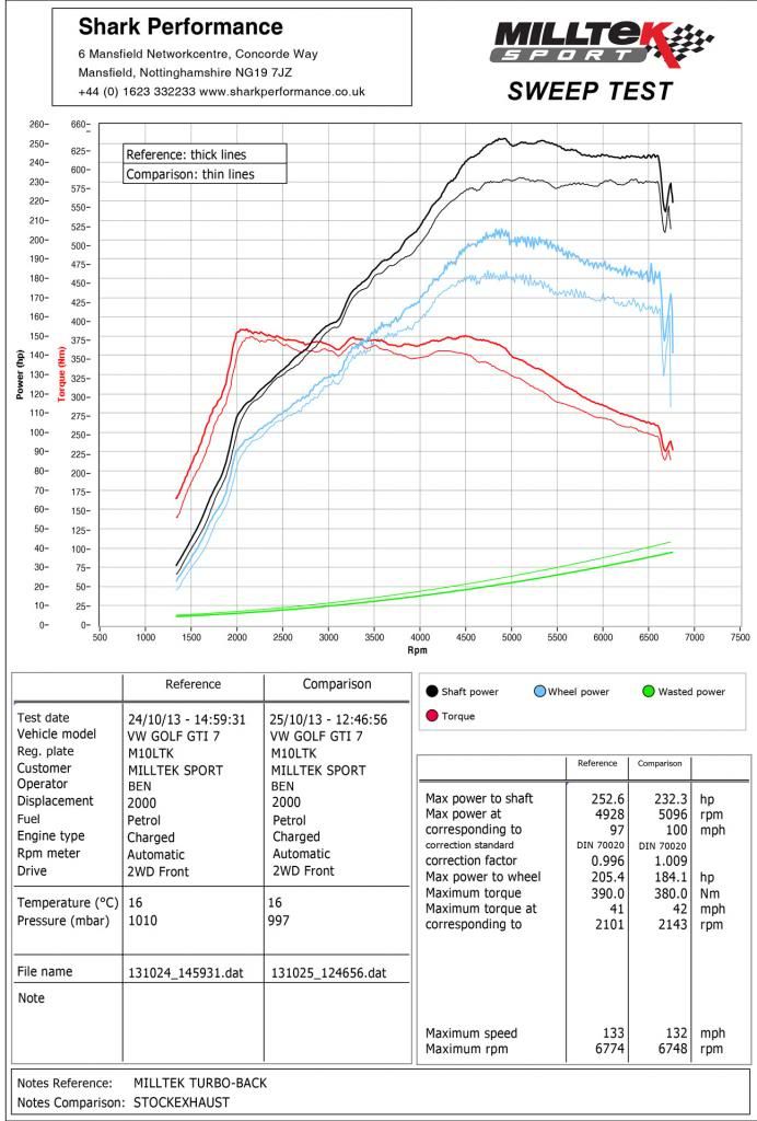

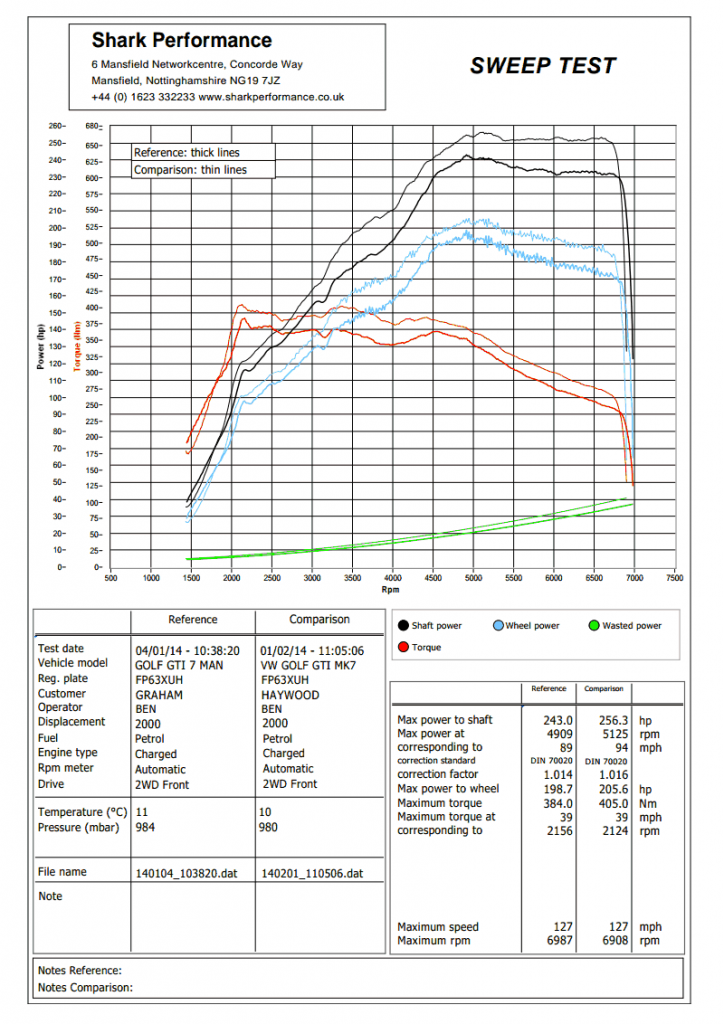

Regardless, here is mine, before and after bcs dp:
And here is milltek's:
Obviously the car is different but its the same engine block so you get the idea.

You will feel the difference of a DP without software, if you add software it will be even better.
The graphs above are before and after fitting a DP.

as Andrew says this is just showing the difference between a downpipe and no downpipe, before they are remapped in anyway.
Also, this is for a Golf GTI, dont look at the figures too closely.
