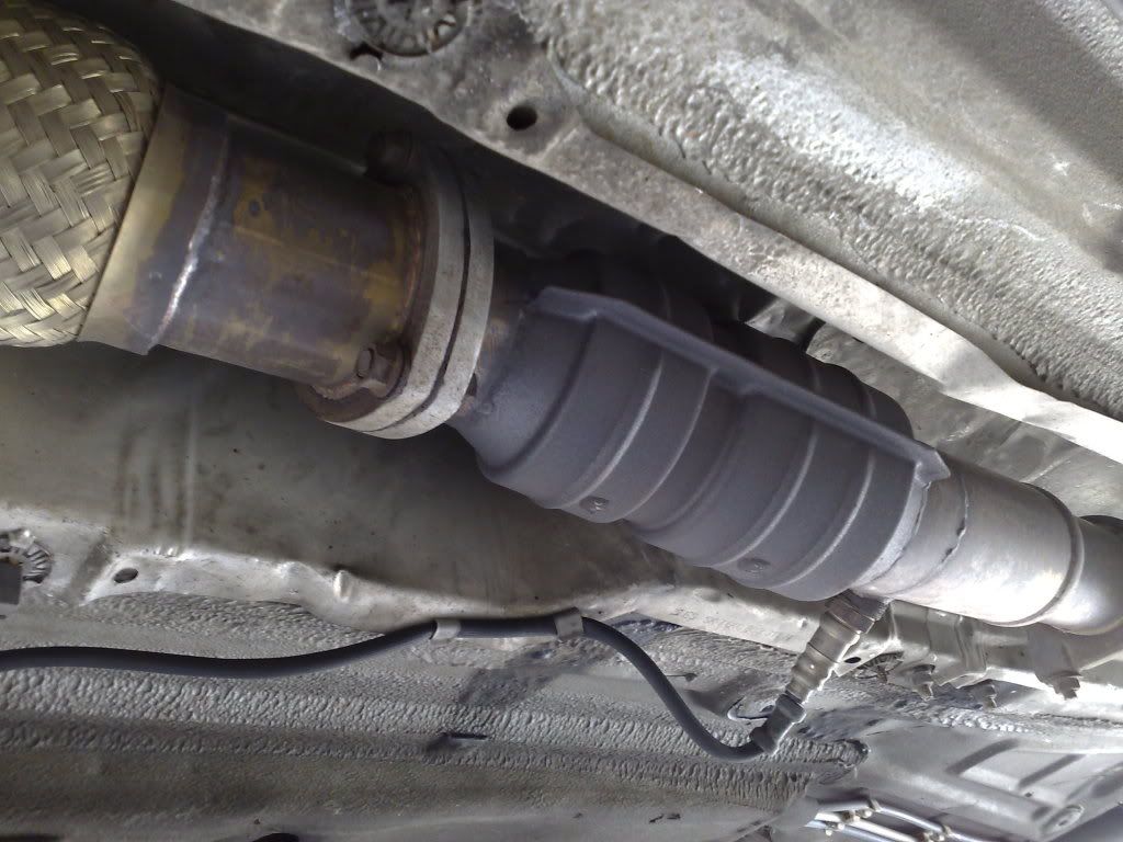

If the downpipe itself is cut, bent downwards then welded back up it will pull the bottom section down which in turn will bring it away from the body. Mine knocked on the centre a tiny bit but only on idle so wasnt a problem, but mine never touched the bulkhead in the slightest.
The bit that rubs on the centre is where the bottom section is flaring down to the 2.5". Ive ringed the section that rubs so you can see what im on about. Bare in mind the pic is from after i had my sports cat put onto it
And another pic just cos i can lol
As you can see, its exactly the same pipe everyone else has problems with so nobody can say im bullshittin now :p
