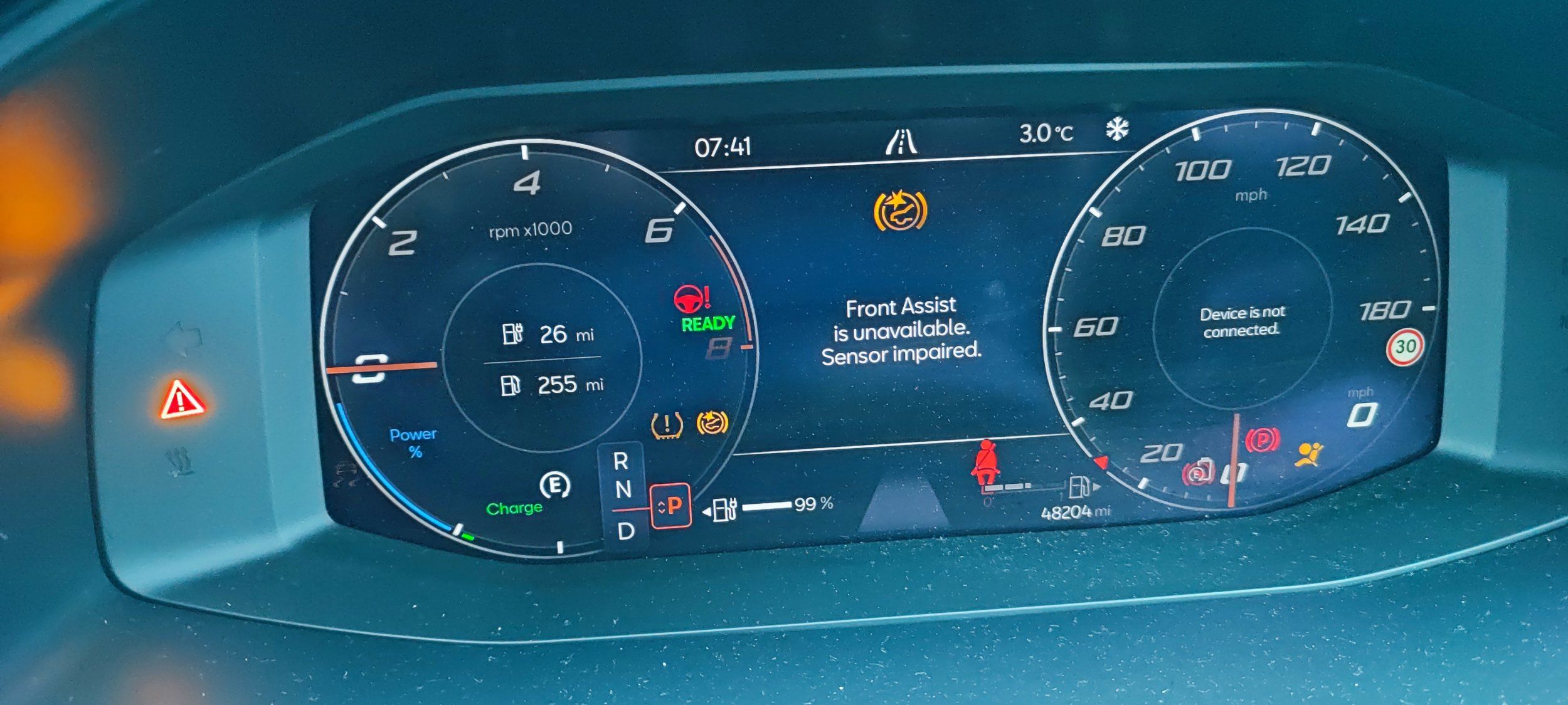

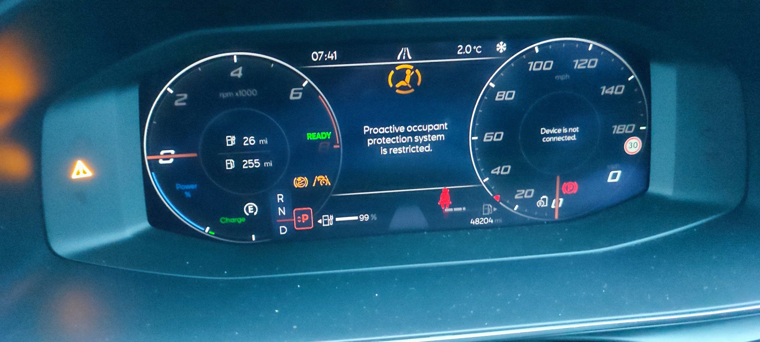

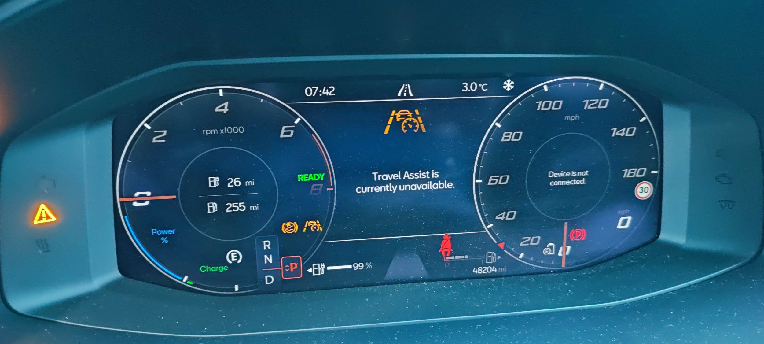

I am sure this was asked before. In the last 7 days my Cupra Leon plug in hybrid has been telling me the front assist is unpaired+ lane assist + another one that I do not remember about the occupant. They all come up one after another sometimes they disappear and then they come back . I cleaned the sensors and the black squared thing under the registration plate but i am still having the alarms. What else can be done? I believe it's fine to drive the car but it's annoying to hear the alarm all the time. Would this be covered by the warranty? The car is still under warranty.

In the morning and late evening. It clears after 10/15 minutes then it comes back. It is colder than normal here , also 4 degrees. This evening the windscreen was foggy and the alarm was there as soon as I pressed start. I am not sure if this is also linked to the alarm.
The alarm started a couple of days ago when we had the storm.

The message "sensor impaired" does not necessarily indicate that there's a fault. It means one of the sensors can't see correctly, the radar(s), windscreen camera or PDC sensors. This can be caused by the likes of condensation over the camera on the inside of the screen or external frost.
Once the obstruction is gone, usually when the screen or radar warms up and depletes the ice/condensation, the function is restored.
If the fault said the system was unavailable then that would be a different matter.
I have a new Tiguan, it displays the same messages in icey weather.

All these alarm are coming on every time I am starting the car (it's been like these in the past 3 days, with cold weather and heavy rain). The journey today was 1 hour and 3 minutes. The alarms came on as soon as I started the car. After 10 minutes they disappeared for 10 minutes and they came back from minute 23 to all the rest of the journey
In that case it's worth having the issue investigated
This time of year with the weather getting colder never rule out batteries, all the ECUs want a minimum of 12v if one doesn't this creates a knock on effect that will cause others to fail.
First rule of fault finding is a good power supply.
I guess I would see something on the screen if the battery is low?
Not always no, the battery on its way out (and based on what I have seen on here that is not as long as it used to be) can lead to all sorts of weird things (warnings and stuff not working) happening but no warnings.
