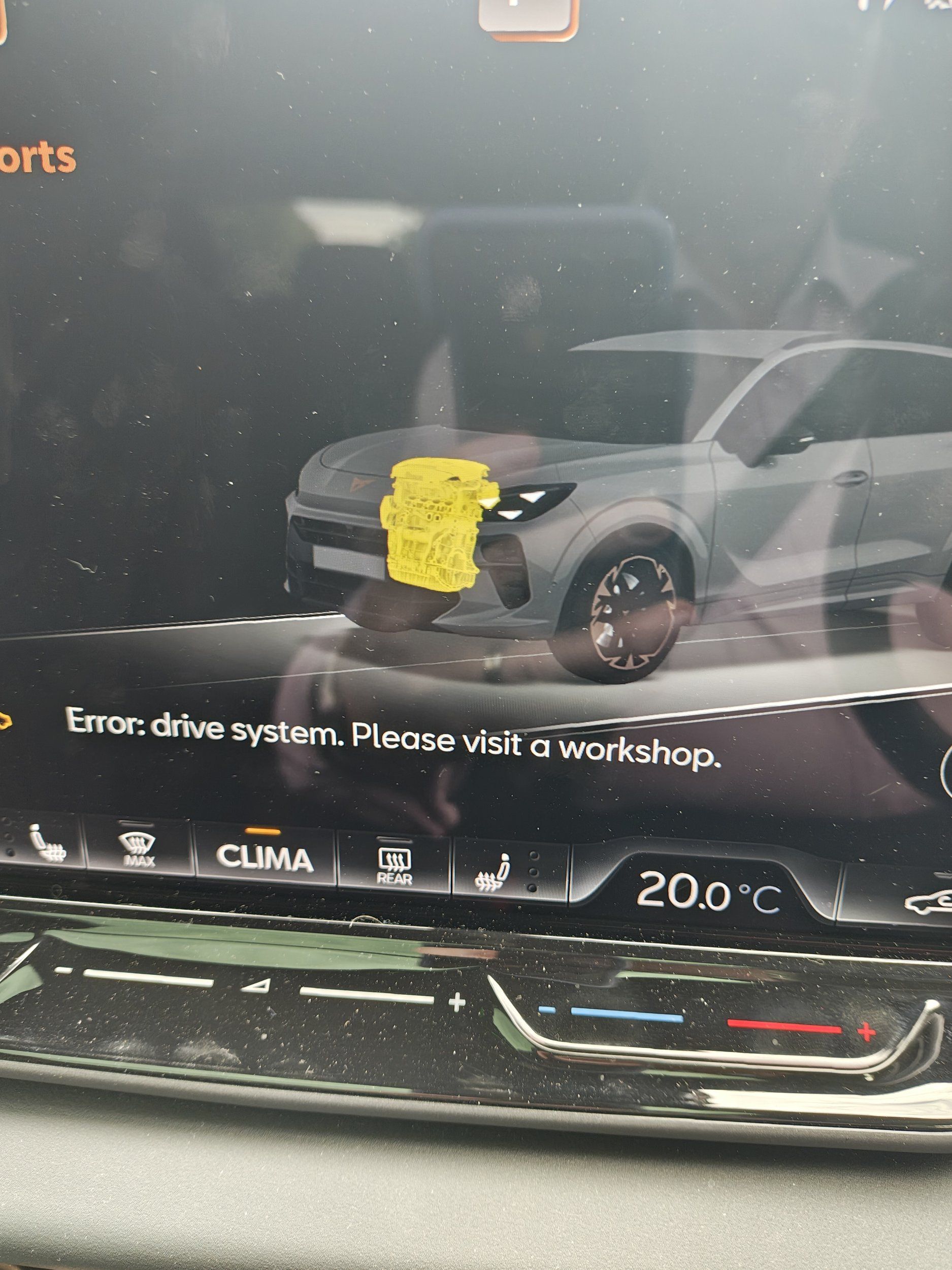

After 4 months of happiness, it turns out there is a manufacturing issue with the 272 hybrids.
Got in the car from a quick visit to the shops and was greeted with a nice drive system error - please visit workshop!
Engine wouldn't run and would only drive on EV (thankfully had nearly a full charge) and crawled home. Contacted Cupra care (who it has to be said were brilliant) and a technician was at my house in about 3hrs. He managed to 'clear' the issue after about 30 minutes but then went on to explain it's a software issue with all the models and a fix should hopefully be available end of September ?.
Strangely, the problem exists with the EV drive, but it's the petrol engine that shuts down so my advice is make sure you always have some charge and the Cupra care number close to hand until the fix is available.

I’ve had an issue today with an error message popping up saying “Drive system error visit workshop”, I was on the motorway and they car seemed to loose power for a split second, after stopping and turning off the engine the restarting it seemed to clear the fault.
Any advice?
I've not had any issues since last year until last week and now its happened three times. Problem clears itself if you turn the engine off and walk away with key so its out of range for 20 - 30 minutes which is obviously less than ideal. I also got a new message yesterday I've never seen before....
