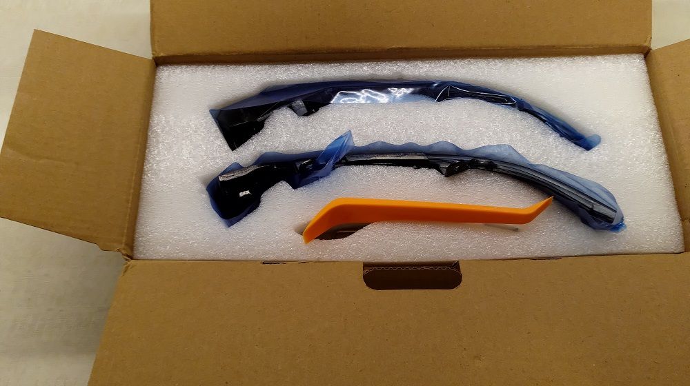

My AliExpress pair arrive today:

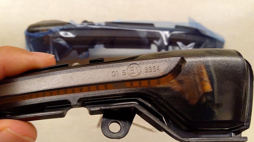

Great quality, torx key and removal toll in the set. Fit very well and have "E" mark on it. It is the same item like ebay ones but for 35$ shipping included.

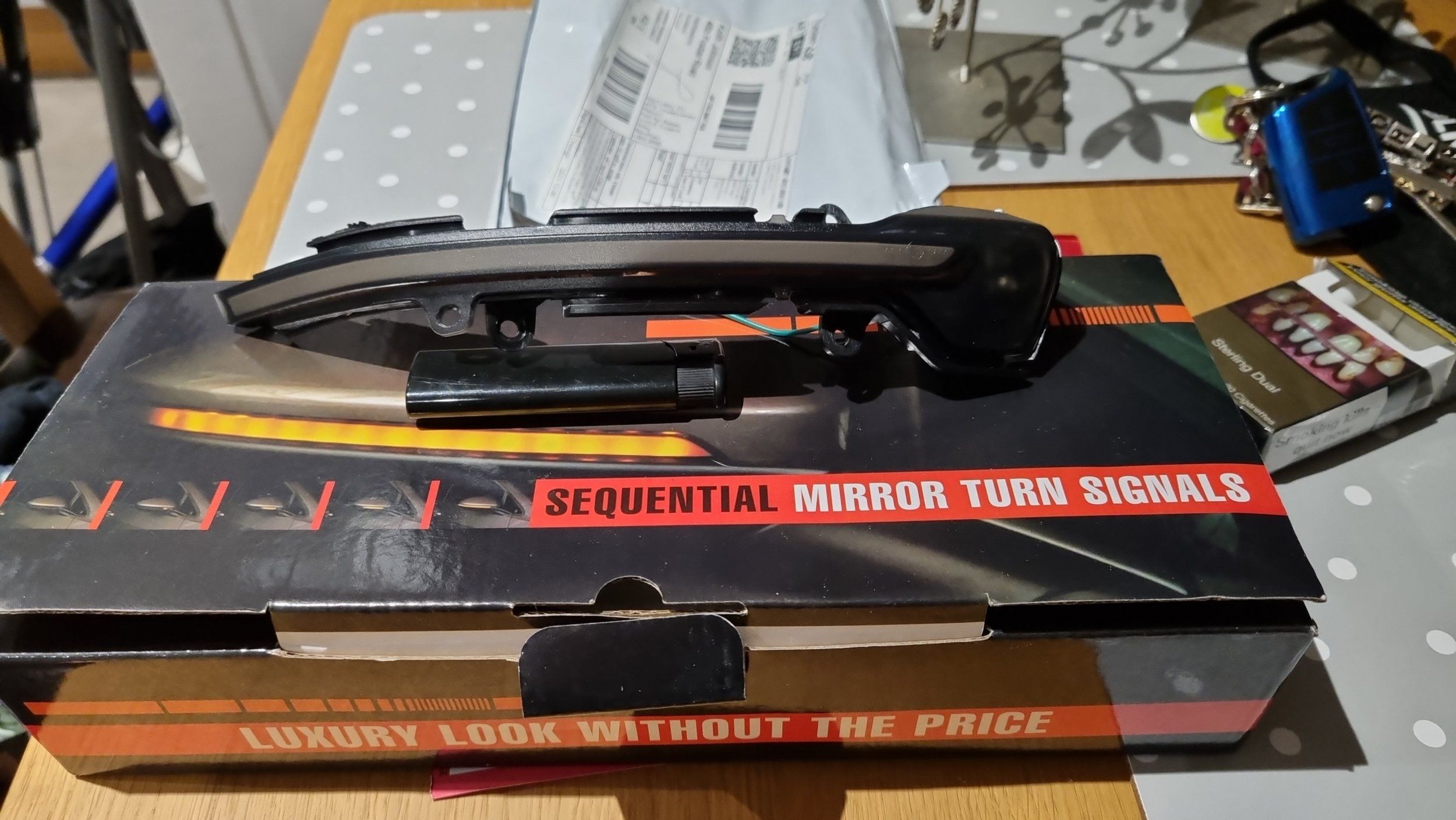

Just fitted some myself really easy, i just pulled my covers off.
No clips were harmed during the install. :D:p

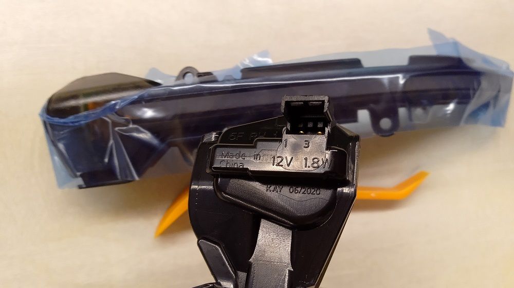

bahyr
Jun 26, 2019
70
29
Probably it is the same. OEM number of the right hand I removed is 5F0.949.102 A. Just check yours, if it is the same you are good to go.
